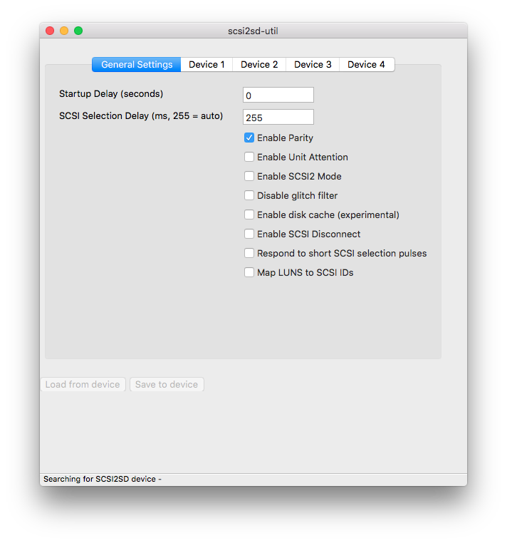

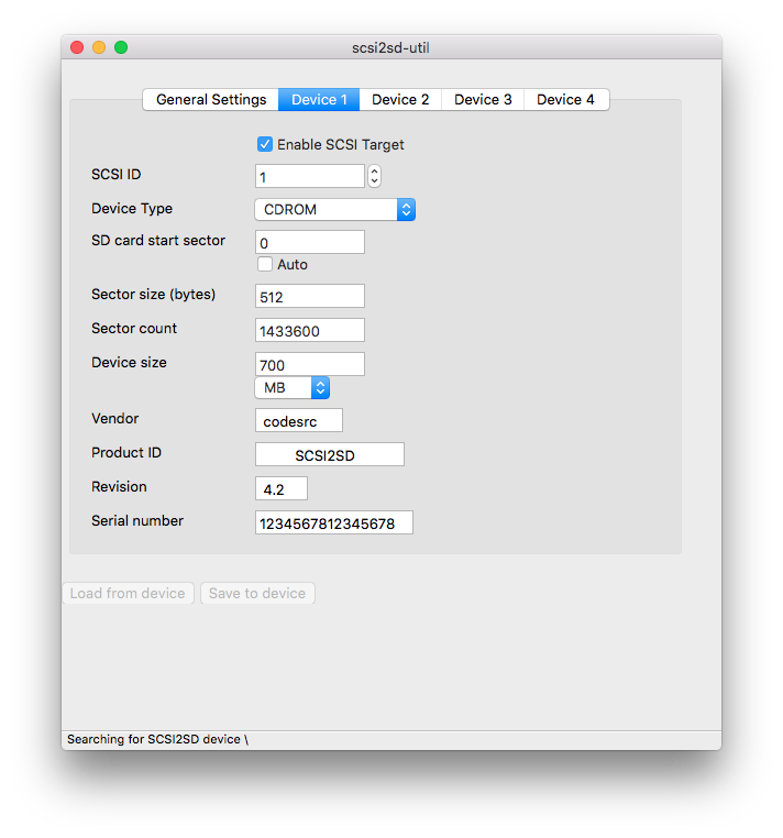

I've updated screen shots for the Windows version of "scsi2sd-util" software, based on the information in this thread.
General Settings
Device Settings

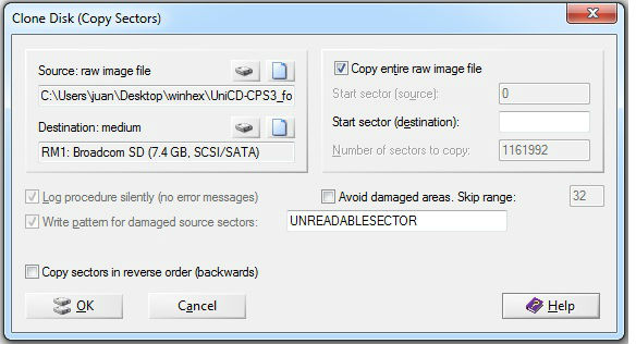

I just received a SCSI to SD adapter, but I'm having trouble writing an ISO file to my micro SD card. I feel like I'm missing something very basic. I'd appreciate any tips provided. Here's what I do:
1. Download the UniBios ISO from this link: http://www.mediafire.com/download/p8eieg5zz47rmk6/UniCD-CPS3_for_custom_SH2_V5.7z
2. Download and install SD formatter:
https://www.sdcard.org/downloads/formatter_4/eula_windows/
3. Format SD card using the SDFormatter (I also used a brand new micro sd card already pre-formated and using Windows 7 quick format, same result)
4. Launch Winhex as Administrator, select Tools, then Disk Tools, and finally Clone Disk.
5. I select the downloaded ISO file from step 1 as my source, and the logical partition for the sdcard as the destination.
6. I use the settings as pictured.
Result:

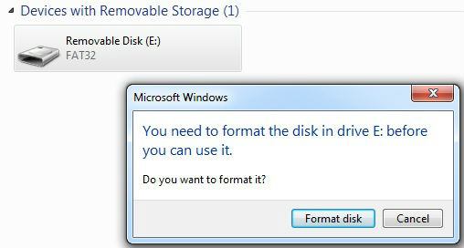

After the operation is complete I'm left with an unreadable SD card and am asked to format it by Windows. I had the same result using HD Raw Copy as well.
What am I doing wrong? This is round 2 for me, as I first was using my Mac to do this and dd on the command line to write the ISO to the sdcard with the same result. I've tried this also with my own ISO that I created from my actual Joe Joe disc and now 3 different micro sd cards, 2 of which were brand new.
Any ideas?
Thank you!

it shouldn't be readable in windows when you are done. Just pop it in the sd2scsi.

First download the utility:
scsi2sd-util.dmg
And the latest firmware:
firmware_bundle-v4.6.00.scsi2sd
Steps to update firmware:
1. Mount the disk image.
2. Copy the utility from the disk image to your Desktop
3. Launch the Terminal.app application and navigate to your Desktop: cd ~/Desktop
4. Once in the Desktop, launch the "scsi2sd-util" application: ./scsi2sd-util
5. You'll be presented with the UI as documented in this thread earlier, see screenshot.

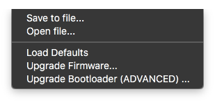

6. Select File --> Upgrade Firmware... from the Menu bar, see screenshot.
7. Point to the firmware file you downloaded earlier.
Steps to set up board as a CD-ROM:
1. From the General settings tab, make sure "Enable Parity" is checked.
2. From the "Device 1" tab, change the "SCSI ID" to a value of 1
3. Device type should be "CDROM"
4. Device size should be set to 700 MB.
5. Click Save to Device button.
Once that is done, I would disconnect and reconnect the board, and click the "Load from Device" button. The settings you had set previously are read and should display correctly. This is the part that didn't work for me on the Mac, but did on Windows.

Once dd is done, you will not be able to read or write to the card on your Mac unless you reformat it. But you should now be able to insert it into your SCSI2SD board and use it on your CPS3 setup.
