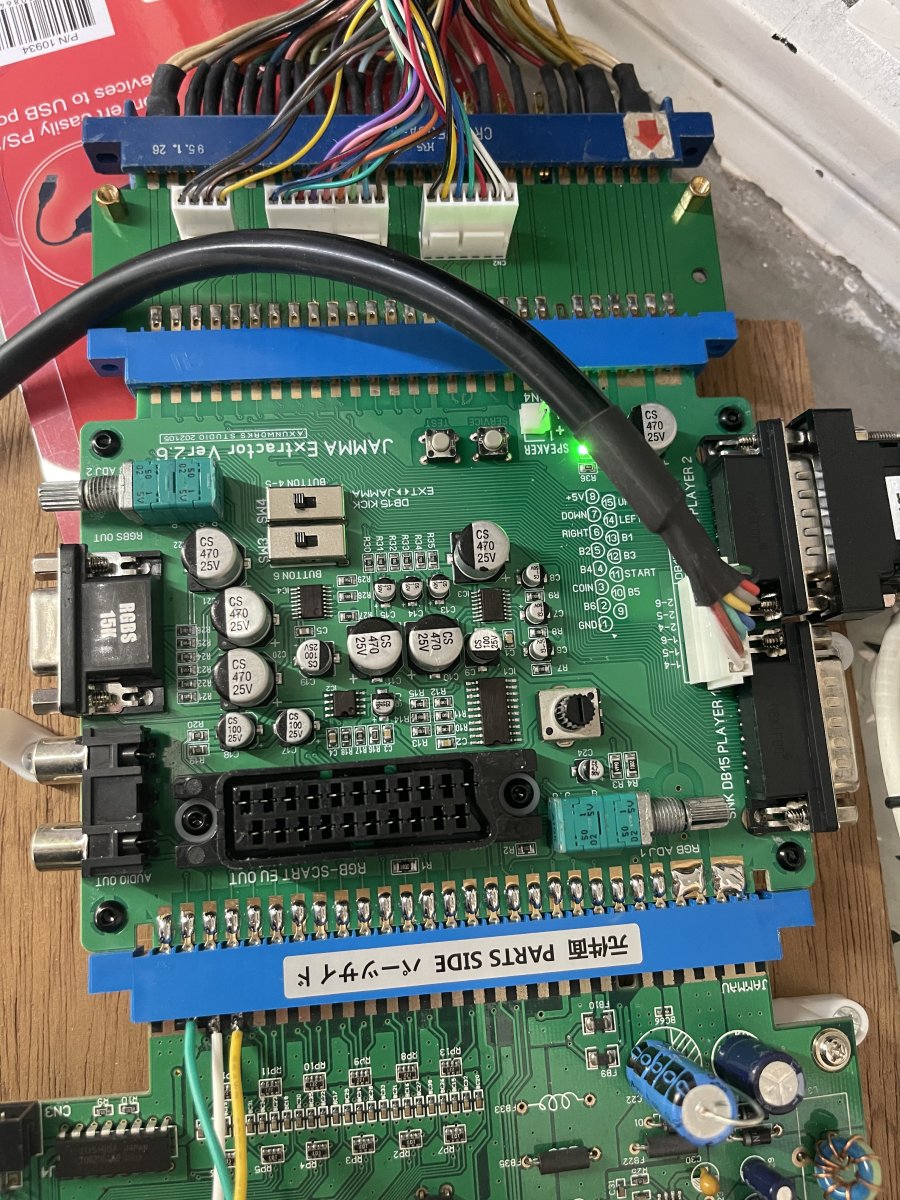

Anyone know how to get the 6th kick button to work with this jamma extractor? I tried the button 6 switch but it doesn’t seem to do anything
