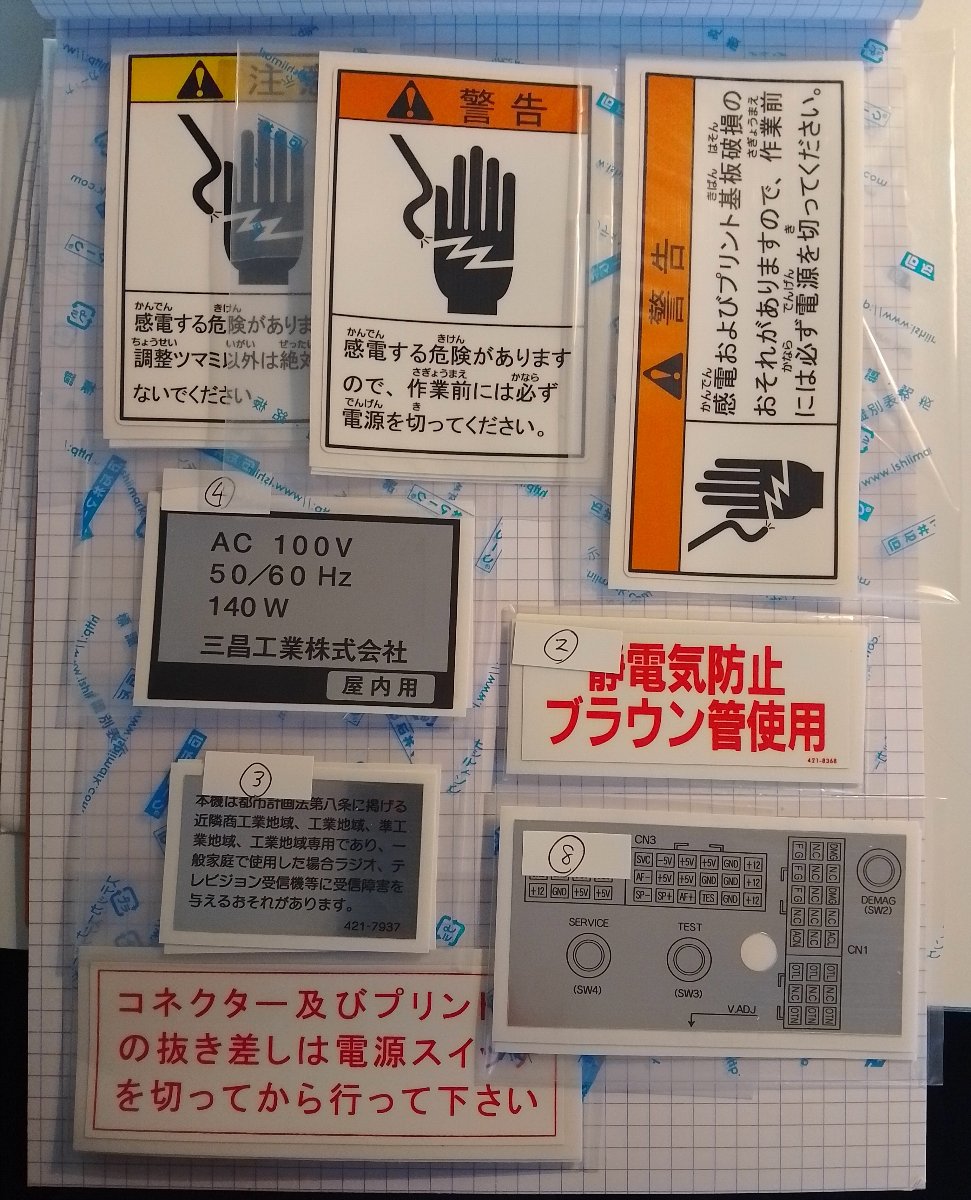

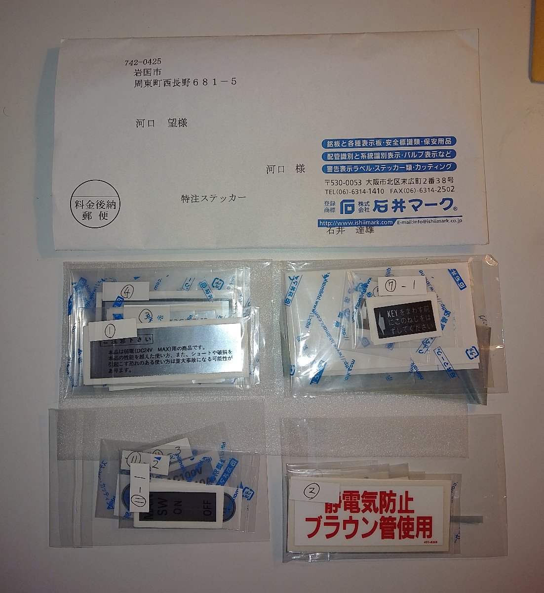

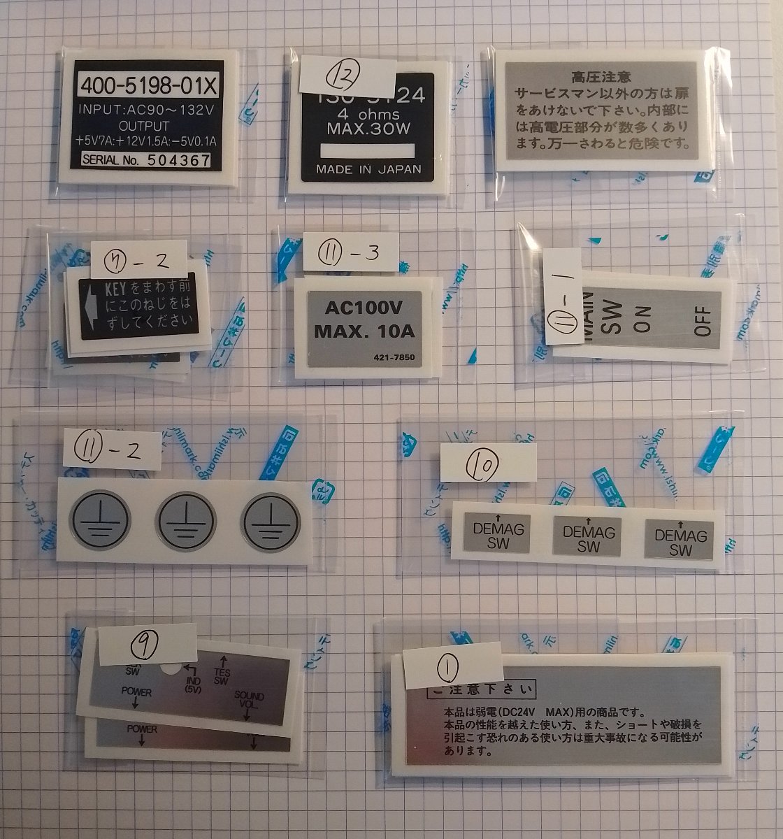

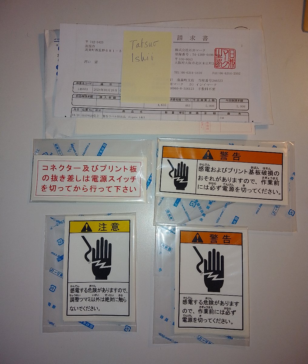

I received the whole sticker set recently from http://www.ishiimark.co.jp/index_guide0.html.
They can reproduce almost everything except pieces with a trademark, like ''Sega'' for example.
So there is still one sticker missing, which I call the ''phone sticker'' but I'll find a way to get it.
There is a guy from Taiwan (ex retro-daily) who made it but with the wrong dimensions unfortunatley
@erzane did you send them scans of old ones from your machine? Just curious what the process was to get these done. Are they reasonably priced? Thanks 🙏🏼.
Yes, I removed them carefuly from my cab then scanned them in 600 dpi then sent him with dimensions and instructions.
Price was around $300 shipment/fees included for like qty 4/5 pces of each

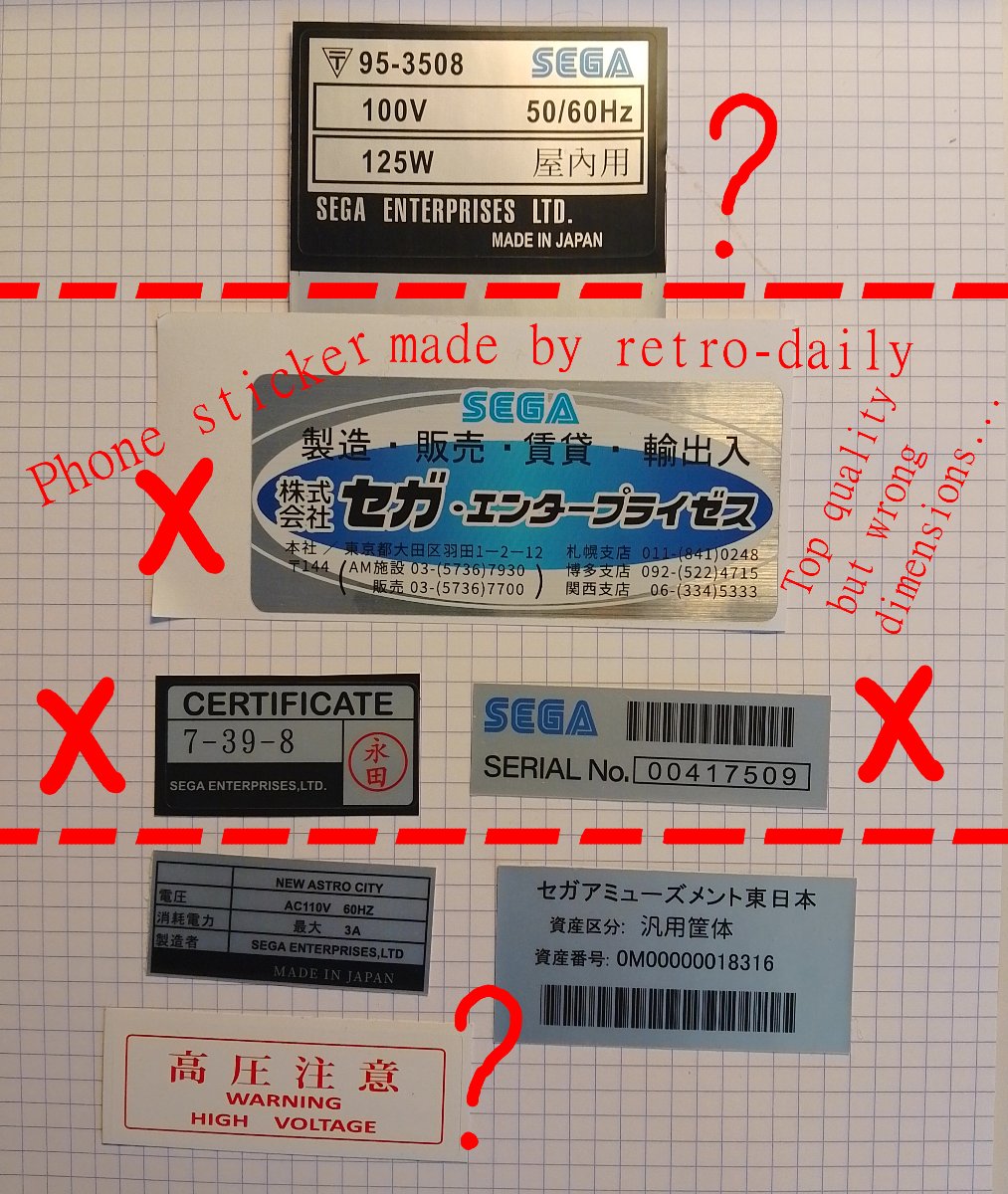

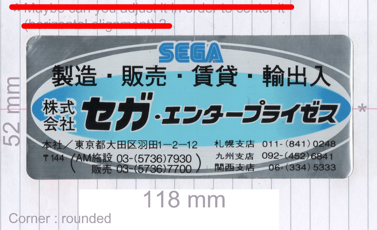

In fact, there are three stickers missing from Ishiimark because they have no permission to reproduce a brand since Japanese laws regarding copyrights seems to be more stricts than in Europa : the ''Phone sticker'', the ''Certificate'', and the ''Serial''
The following attached sticker set was made by the Taiwanese guy I was referring to earlier (ex retro-daily). Unfortunatly, the ''Phone sticker'' is too small, the ''Certificate'' should be done in some paper, not vinyl, and the ''Serial'' is also (a little bit) too small, also the ''SEGA'' font is not correct.
Idk about the others. Some stickers differs regarding the year of production of the cabs, maybe...
Ps. I also attached a scan of the original ''Phone sticker'' - that I removed from my cab - with the real dimensions.
