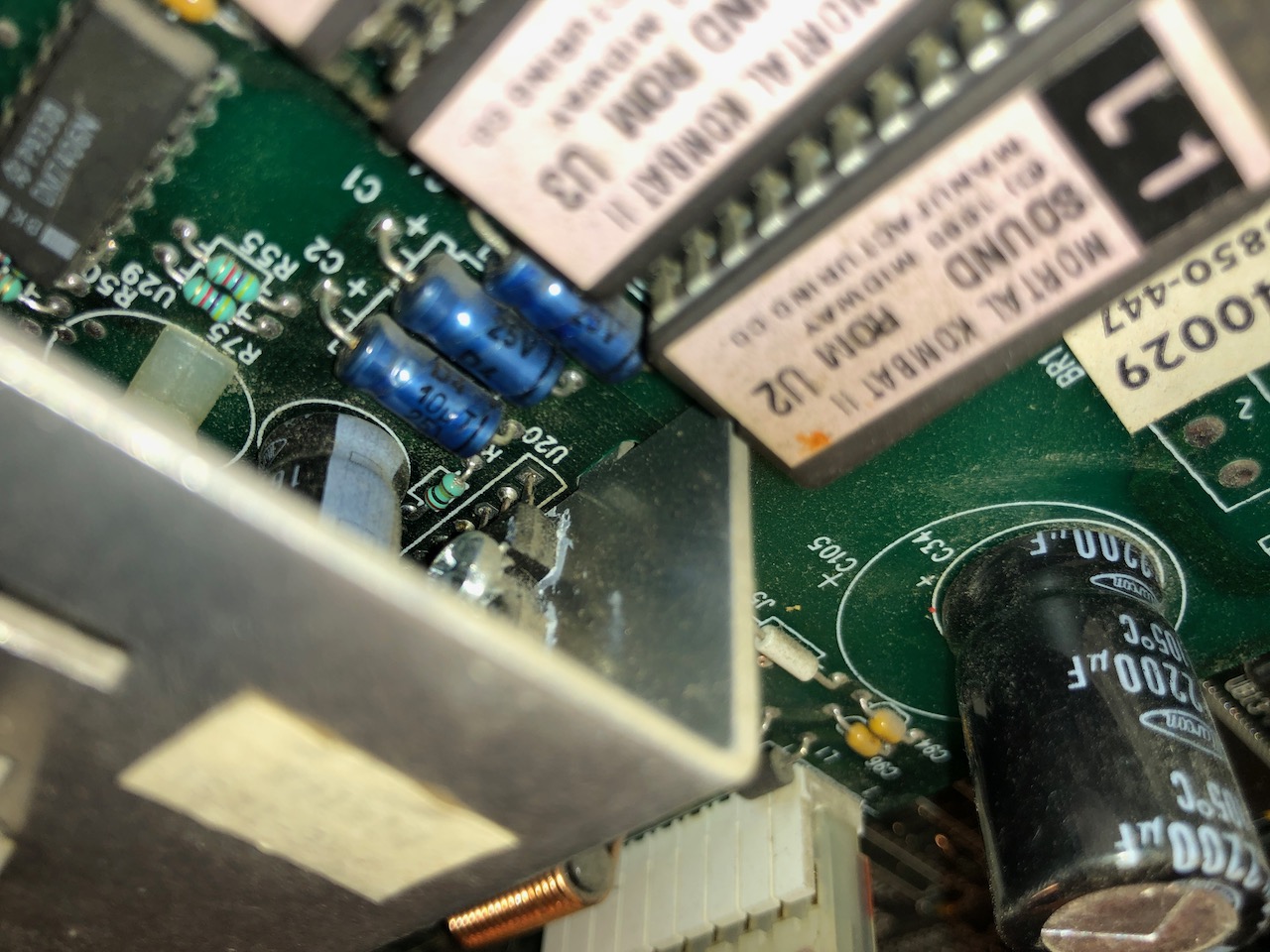

1x 47uf 25v (axial)
This one (C2 in schemantics) was same kind of 10uf 25v on my Sound board, so I am going to go with 10uf cap with it. Can some one else confirm what kind of cap they have there? Schemantics say it should be 47uf 25v.
Sound Board, MK2, cap on place C2. It's under the heat shield, third axial from the EPROMS
Third one on this picture of mine which I already re-capped with vertical caps:
Here's mine, it looks to be a 10uf like the others?
I have a question for you, I'm getting ready to recap my MK2 as well, should I replace those three yellow Axial Film caps or leave the originals?
OK, so it seems they went with 10uf 25v on there too.
Those film caps don't usually have liquids in them, so they tend to be pretty solid. I did not change mine. Of course if you have those laying around it does not hurt to change them too.
