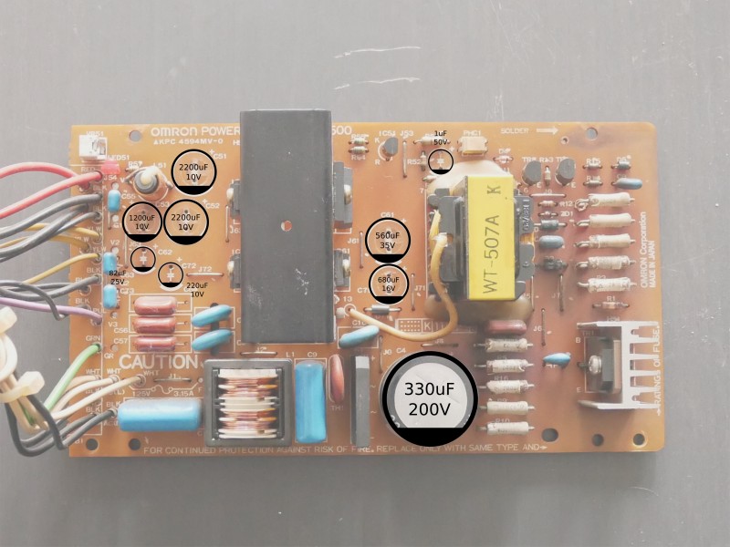

Recapped a few PSUs found in Neo (Candy) 25 / 29 cabs. All of them made a god awful squeal before. After recapping they were completely silent. Bonus!
OMRON S8XA-500
Code:
Capacitor     Diameter  Qty  Location
1uF 50V       4mm       1    C54
82uF 25V      6mm       1    C62
220uF 10V     6mm       1    C72
330uF 200V    25mm      1    C4
560uF 35V     13mm      1    C61
680uF 16V     10mm      1    C71
1200uF 10V    10mm      1    C53
2200uF 10V    13mm      2    C51, C52

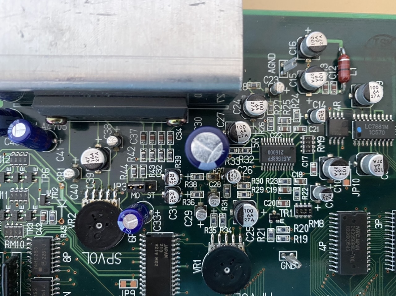

so ... i measure the NA1 motherboard capacitors :
C43 is 470uf 10V lead space 5mm , dia 6mm , 10mm length (electrolytic capacitor)
C41 is 100uf 16V lead space 5mm , dia 4mm , 10mm length (electrolytic capacitor)
C33 is 220uf 6.3V lead space 5mm , dia 4mm , 10mm length (electrolytic capacitor)
C30 is 1000uf 16V lead space 5mm ,dia 11mm , 20mm length (electrolytic capacitor)
C6 is 100uf 16V lead space 5mm , dia 4mm , 10mm length(electrolytic capacitor)
all of these are rated on 85°C , but will work 105°C too
Now the hard part will be to put here the values and measure of that smd electrolytic caps
If somebody know how to interpretate value and can measure these smd electrolytic caps will be awesome
also in February , this year , i've made a comment about reccap this NA1 pcb , but will be fine to make this reccap proper list togheter , but after these notes they are :
100uF / 6.3v - C8, C9, C10, C15, C16, C24, C25, C27 - dia 5mm , 5mm length
47uF / 16v - C39 - dia 5mm , 5mm length
22uF / 6.3v - C11, C14, C31, C32 - dia 3mm , 4mm length
2.2uF / 35v - C5, C23, C26, C28, C29, C38, C40 - dia 2mm , 4mm length
(these are my measurements - i've made it with a rulette , but if you have a caliper and can measure them proper , will be aweome)
