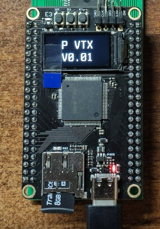

At this point, I can successfully dump, erase, write, and verify all three flash chips: F0095H0 AKA stilt - (CV), MSP55LV100S (P), and JS28F512 (SM).

This dev board that you use, is it made by you or can I buy it anywhere? :)
