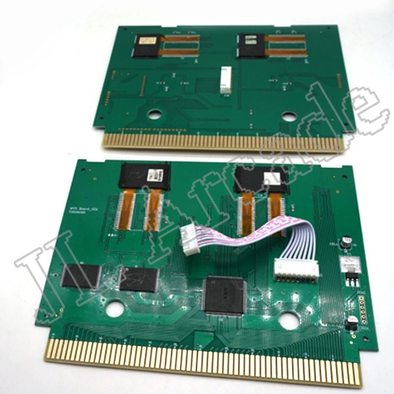

So, are those carts being sold right now still using the same board that the v3 used?
Can they be used to make a vortex cart?
https://aliexpress.com/item/1005004225829143.html
I'm afraid not compatible.
With a coupon they were under 90 euros shipped a couple of weeks ago so I picked one and it isn't the version required in the Vortex mod.
If you look at post #150 on this thread, the board is nearly identical to the "v5/AES" version, I noticed the oscillator/crystal of the top board in mine is in the front instead of the back, I've attached a photo if someone is interested...
Yeah, seems to be a clone of the original.
At least you can cannibalize it if you have a v3 and need an extra chip for the fullset.
No one has tried? It looks the same except the P roms are now on a single F0095HO, instead of 3 MSP55LV100S.
Guess the game compiler and the cpld code would have to be changed to account for the extra address lines on the F0095HO P roms. I think we could do it.

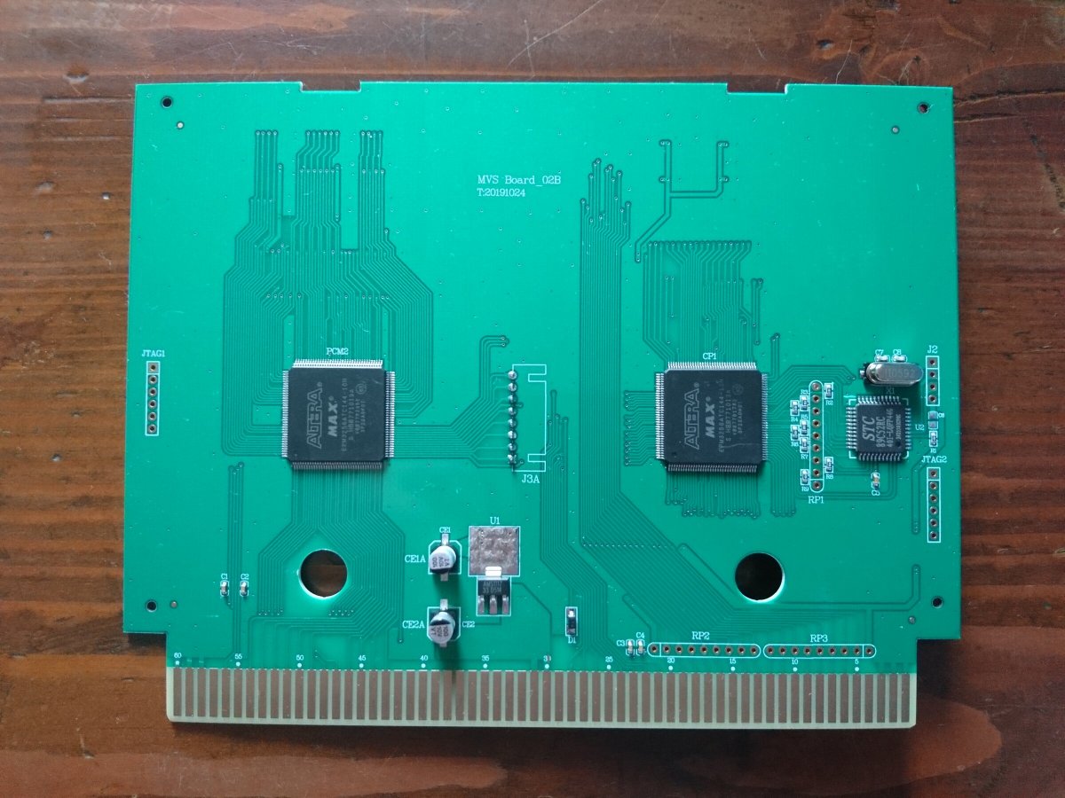

Hi, i make a high resolution scan form my 161 in 1 v3 MVS boards, its compatible with vortex mod.
https://github.com/pluger/NeoGeo-161-in-1-v3-MVS-PCB-inverse-ingenering/
The rear images are fliped.
Maybe the pcb board have a little deformation, i use hot air.
Please if you download the image please post me a like on this post :)
Can use it for reference to recreate a new pcb.
In a future i wish recreate all traces on illustrator for export to a kicad o proteus for recreate this boards
