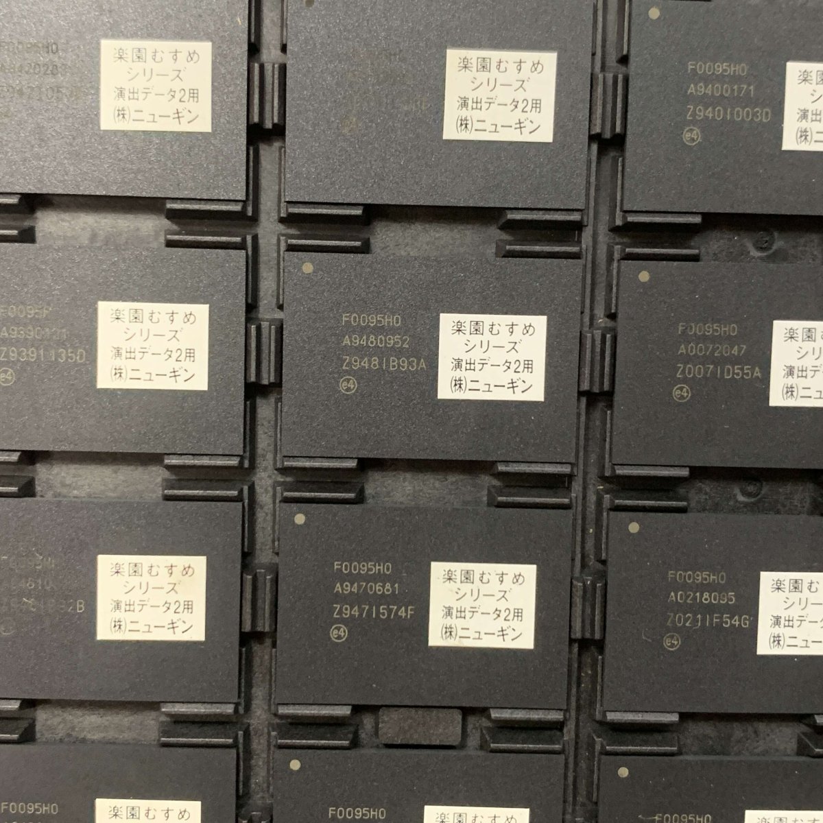

www.chip1cloud.com Price per unit $2.95 FedEx International Economy is 'about $31'
numwan@vastee.com
They said they send pics of the ICs once order is placed. Low price but shipping is up there. Weird that the website domain doesn't match the contact email.

It doesn't seem to be that huge of a risk. The chip pics sent to @darknezz19 look to be fine. The only thing that would be wasted is time, really, should the seller turn out to be an issue.

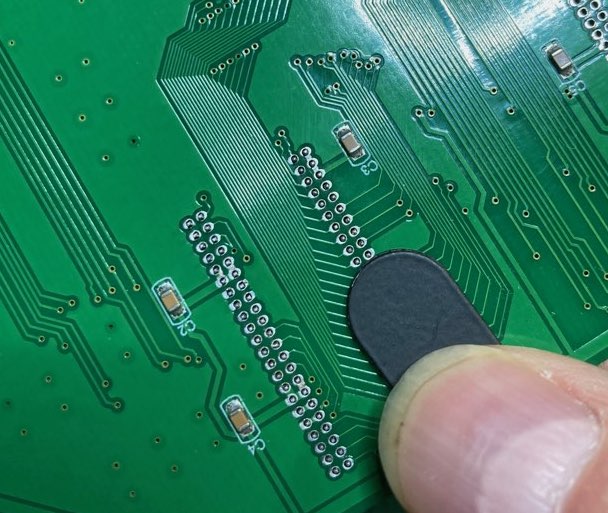

Bad news - I have officially ruined my 161 in 1. I have absolutely no idea how to remove the large chips on the daughterboard, as soon as it seemed to be coming loose the SMD mounted pins on the daughterboard side tore off the daughterboard and took the traces with them :(
Good news - If I can find a way of getting these chips off, I have 3 donors for a complete cart
Can anyone give some insight into how these daughterboards need to be removed? Desoldering gun doesn't work (Hakko FR-301 with 0.6mm tip) and hot air doesn't work
Edit: I tried on the other 2 chips and got a bit further with hot air, but on the far end the last 6-7 rows just refuse to budge no matter how much fresh solder/flux/hot air/desoldering I throw at them

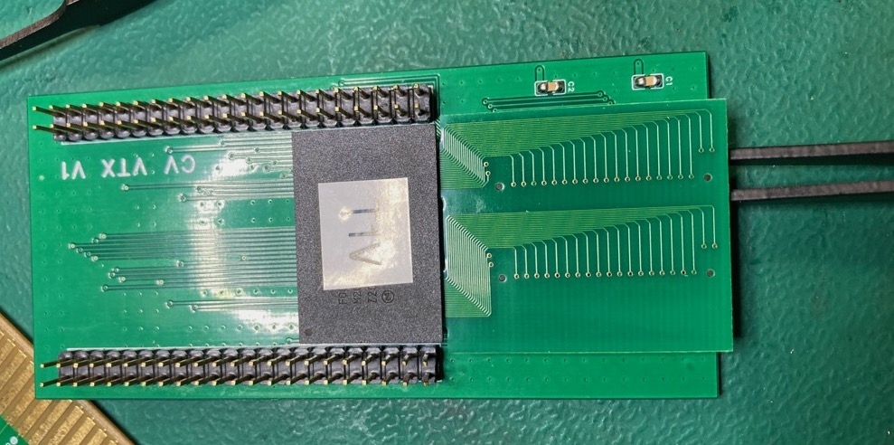

This is why you've seen a number of people post pictures of replacement daughterboards with through hole pins. I ruined 2 before I figured out how to remove them. The key thing with the original daughterboards is to avoid any type of pull pressure on them. The boards are super thin and trying to pull them out of the cart board or female connector of the dumper board is enough to pop the pads off.
For desoldering, like you, I have have a FR-301 with 0.6mm tip. I use that to remove the solder from the holes. Then use fine tip tweezers and a magnifying glass to verify every pin is lose in their holes. If a pin is not lose, apply fresh solder to the pin and desolder again. Once all pins are verified lose, I use the handle side of my tweezers to push down on the pins. Doing around 1/4 of them at a time. Like this
If a section is not wanting to go down, double check the pins in that section. Once the pins are all flush with the board, very very gingerly pull the daughterboard out.
Once the daughterboard is out check the smd side of the pins to verify they are aligned right. I've found that the ones on the end will sometimes be to rotated, not sure if that me or how they came.
This is my method for getting the daughterboards out of the dumper board and cart once you have the female connector installed. The key is to not pull on the daughterboard but to push it out of the connector using the SMD side of the pins. This picture illustrates how this will work.
It will look something like this when the board is in the dumper board. (unrelated: take note of the orientation of the daughterboard. The flash chip should be under the STM board and not sticking out of the dumper board as you might expect for dumper/writing the chip).
It will likely be easier to have the daughterboard facing down on a flat surface when you do this. Apply pressure to your tweezers against the SMD side of the pins and slowly pull up on the dumper board, switching between the 2 rows of pins until its fully loose.

Don't have a FR-301 here unfortunately, but was able to get one out as a test with just hot air.
Propped the pcb up with a couple of screw bits under the main pcb, so there was enough clearance to push the dip headers down flush. Applied new leaded solder and flux. Heated the legs up with hot air and once the solder was good and melted, used a piece another random pcb to push them down flush. Then propped the pcb up vertically, and heated them up again, and was able to remove it with my fingers without damaging the traces. Then you have to clean up all the headers with copper wick and flux, which is not fun as they are delicate and bend easily. All and all, a huge pain, at least for me.
