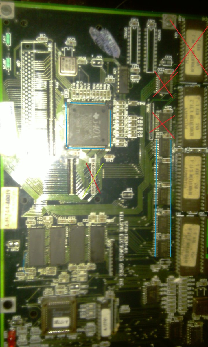

Plan of action :)
What's the plan of action bro 🤔 replacing all of those or just reaoldering ?
Red - Replace
Blue - Resolder
The row of rom sockets had blue corrosion, 3 of 4 cleaned up ok, the end will prob. need to be changed.
As you can see it's had the capacitors stripped and had a clean so it's gonna be a few days to dry and work will continue.
