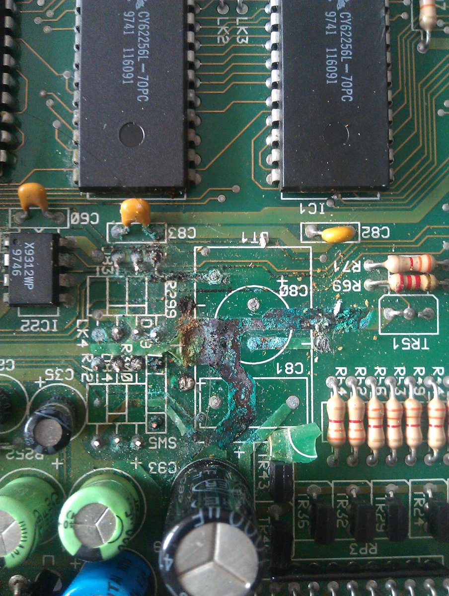

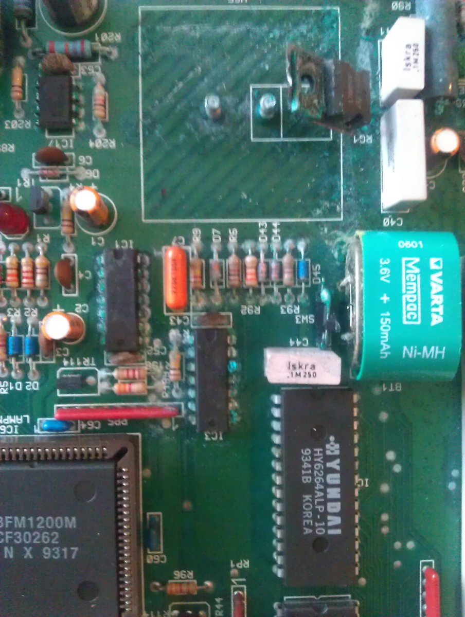

I've fixed a couple of these boards... They suffer from 2 common ailments: 1) Spills corroding things as the board is mounted in a bad place in the cabinet... and 2) the capacitors leak and the electrolyte eats traces.
I absolutely hate working on them as desoldering leaking caps stinks the shop up like I was next door to a fishmonger's dumpster.

That style ram is annoying on a good day. To change with rotten tracks and adding jumper wires was a bitch...
