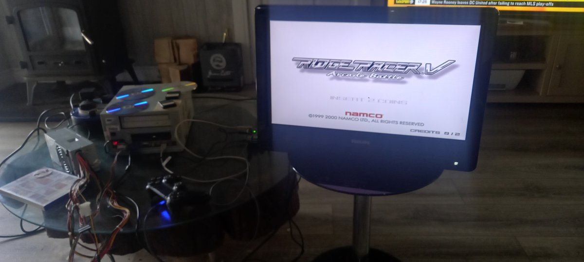

Works perfect on them 100 doller 246c's from alliexpress

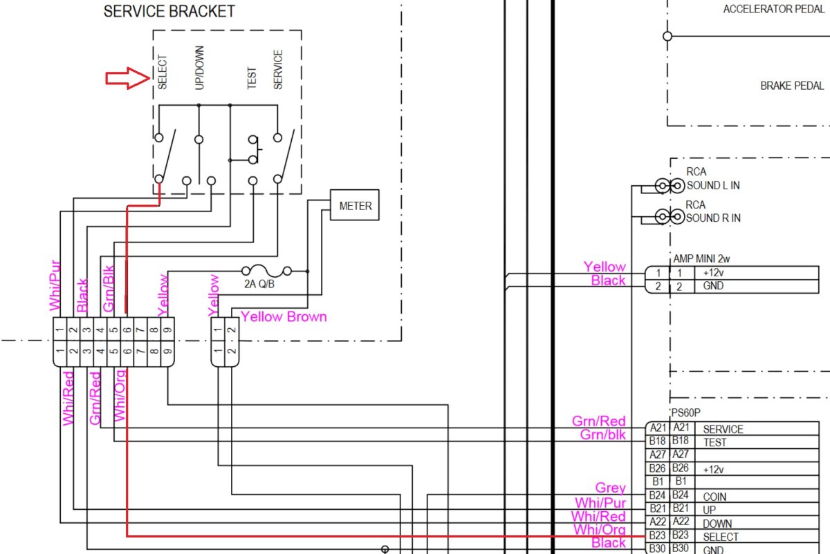

What I/O are you using? I was able to navigate the test menu just fine using both my original Namco FCA pcb and the NA-JV2 I/O
after trying it in a Tekken 5 cab and still didn't allow me to do anything in the service menu, I figured it out, by reading the manual ! shocker!
Your normally have a test and service switch ... but RRV also has an select button AND a up/Down button! will try and rig that up

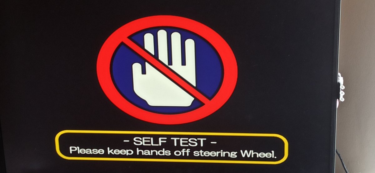

This one was the issue:
First lg drive, not working
gave this error:
Then this one
Gave me this!
Thanks again! This was fun!
(And no, the force feedback does not work but i still can’t navigate the test menu…)

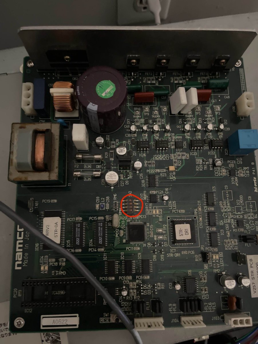

Check this out!

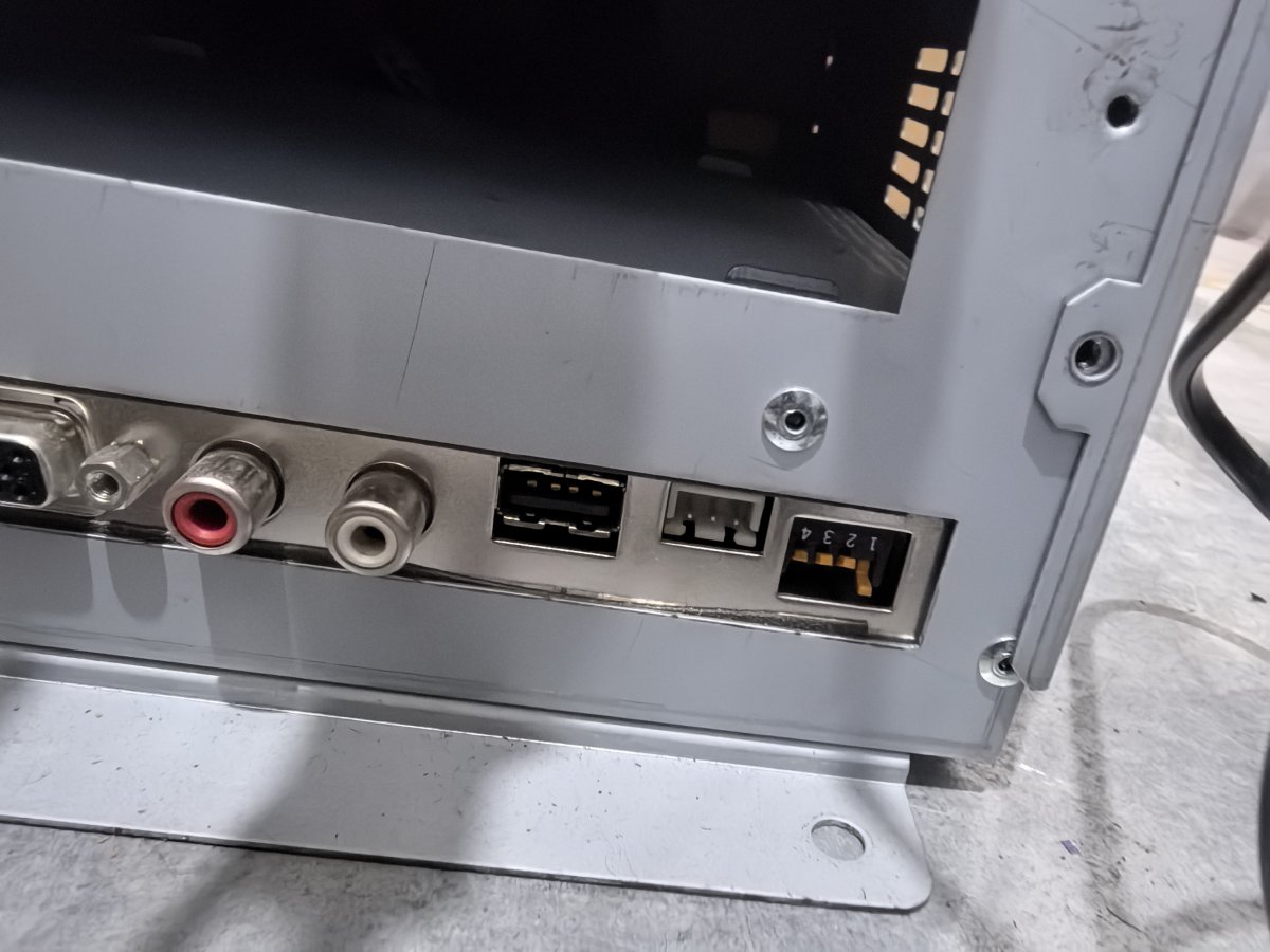

Here's something that some of you might need to know if you have the FFB Board for the game :
  1. Setting the dip switch 4 on will seem to bypass some stuff if you’re using the patch, however, turning it off (default) will give you MONITOR ERROR 10.
  2. If you are planning on using the patch and the original setup, then you will have to flip dip 4 to the on position on the FFB board.
    Here's an image for reference :
    Thanks to @Franco23444 for the image and this info!
