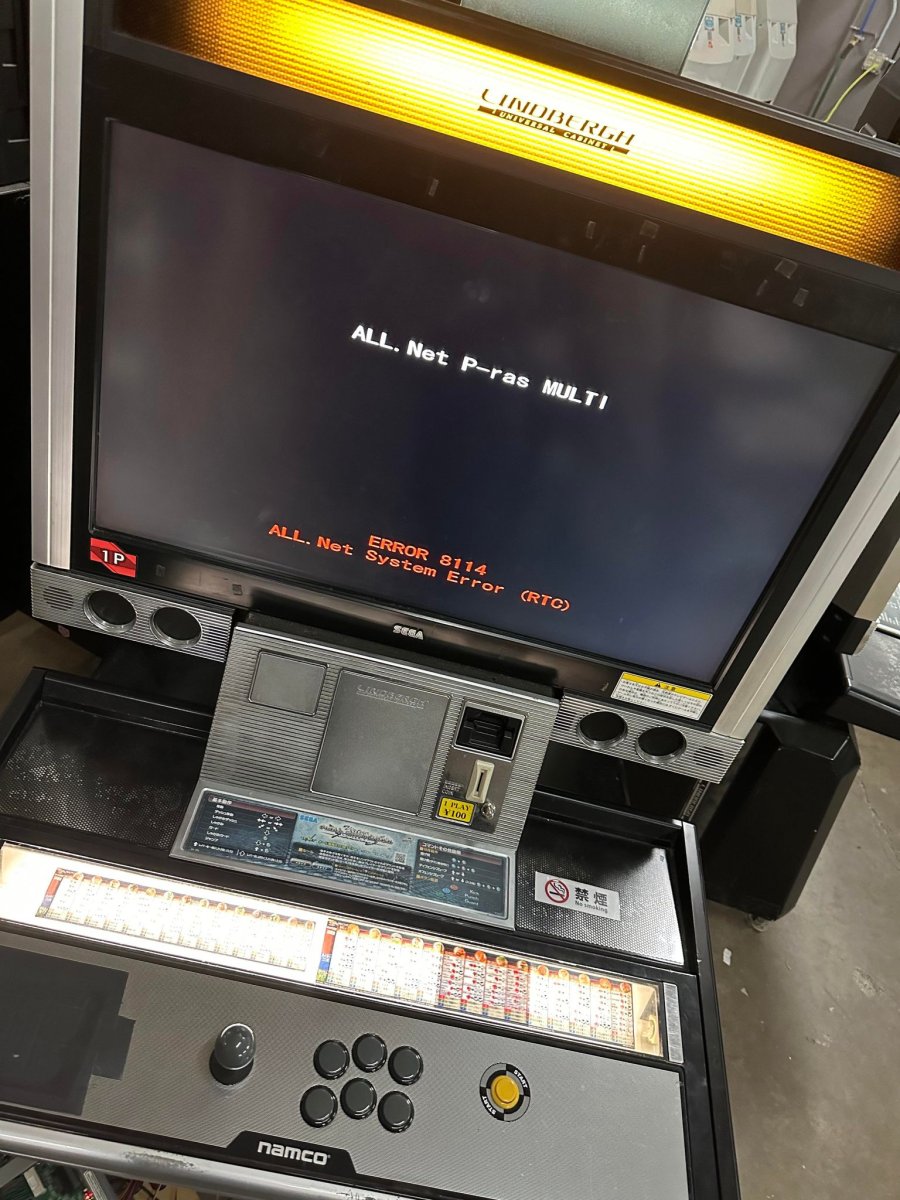

We're trying to bring back up a ringedge 2 after replacing the CMOS battery and when it boots, it's saying "Error 8114 ALL.Net System Error (RTC)"
We've set the CMOS clock and tried a few other bios settings, but we're unsure how to get past this error.
Any ideas would be greatly appreciated
I guess this is the official Sega multi?
I would probably reach out to whoever sold it to you.
It was working up until a couple weekends ago when it started not booting. it would randomly come up, and looking around, it seemed like a cmos battery issue. following the instructions to swap the jumper back and forth after putting in the new battery and now we get this error every time on boot.
