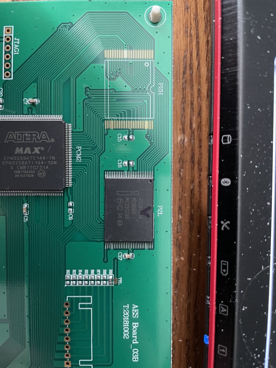

On my board, the flash that the V-Rom was stored on was labeled. It had been marked with a “V” using marker.

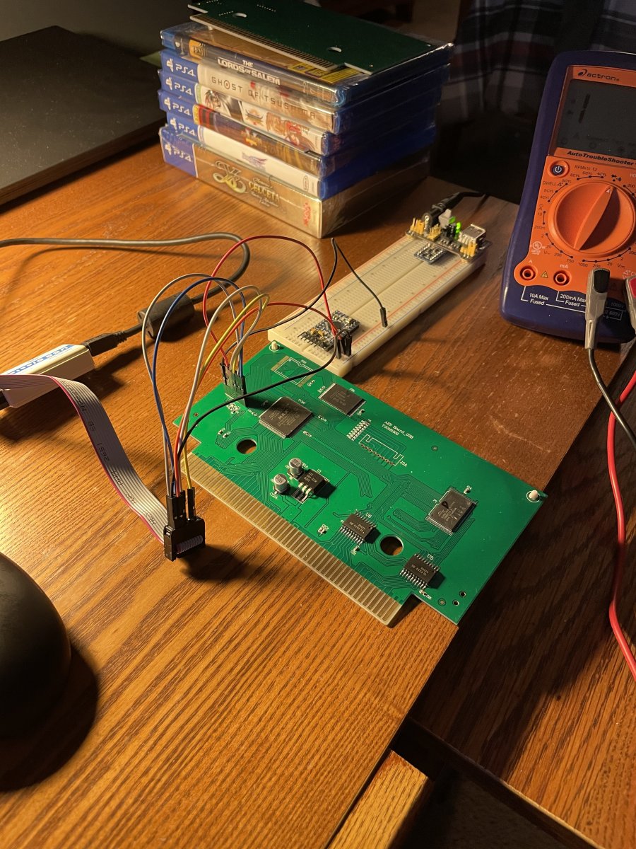

I initially probbed the address/data lines and used JTAG boundary scan to dump the contents. It was just the two V-Roms concatenated. Unfortunately it was not possible to rewrite the flash while it was on the PCB. So I bought some new flash memory, flashed the correctly decrypted V-Roms, and swapped it out.

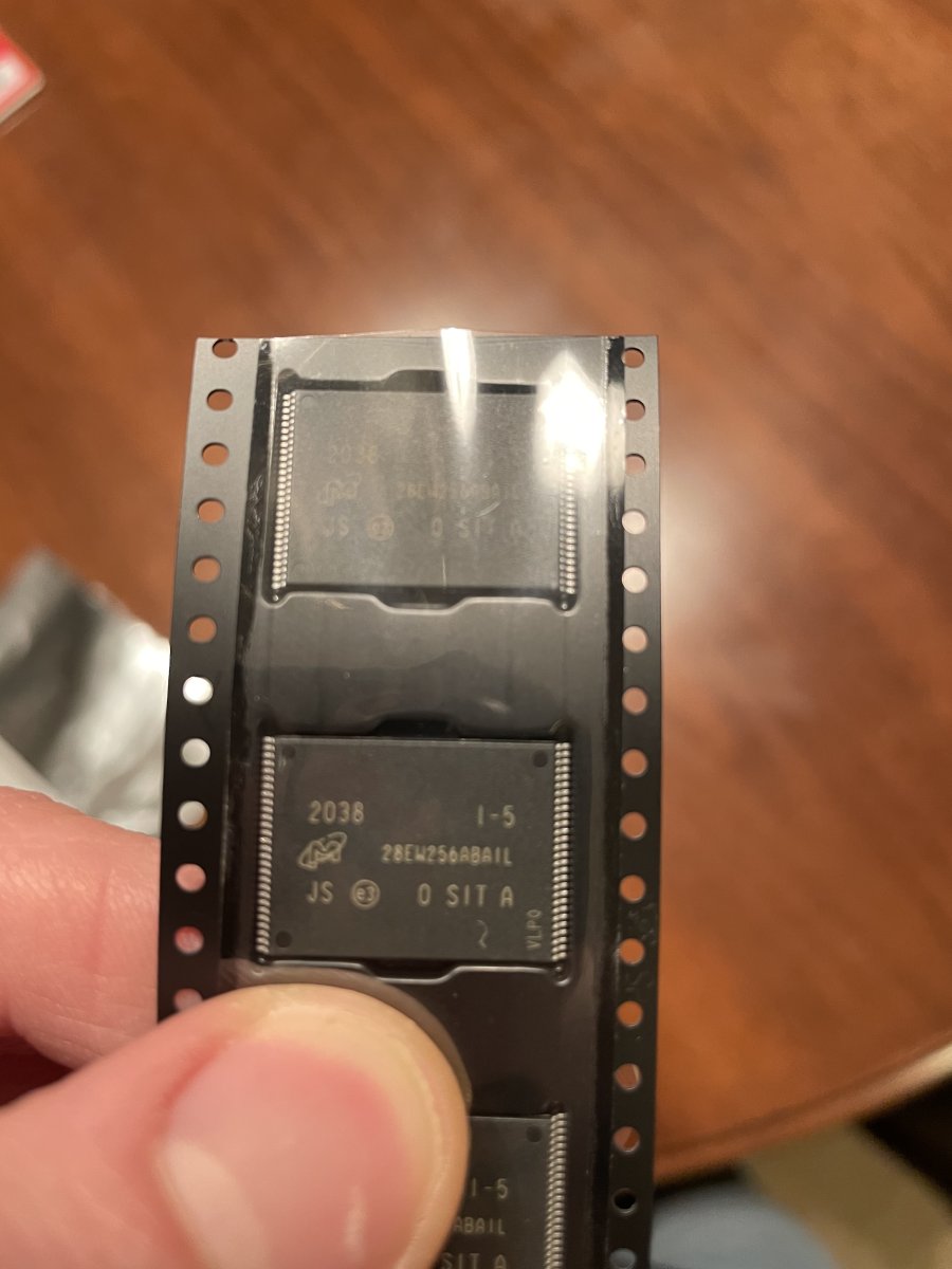

Here is the Flash I used.

Here are a few pics when I was initially working on the PCB last year.

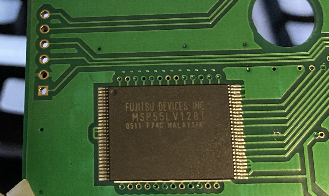

hmm mine was a MSP55LV128T that I cant seem to find any datasheet on :/.. wonder if my segger j-link can read it from the pcb...
Doing a quick visual comparison with the MT28EW256 data sheet, it looks to be the same.
OE is grounded so you won’t be able to flash it in circuit.

Here are some pics.. bought it from a guy on ebay losirmagic or something.. he prolly gets them from aliexpress by the looks of the pcb.
I wonder which flash contains the V rom.. I saw that all on your board were named "P" on the pcb..
My board have P1, P2, and the one to the right is not named at all.. looking at your board again make me think it actually might be the oned marked P1 on the pcb???

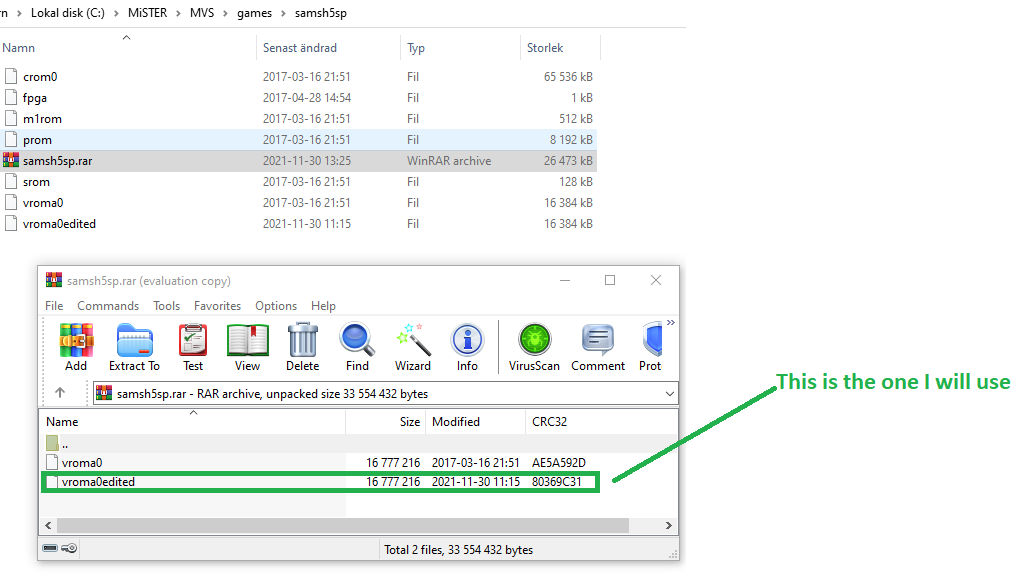

I found a suitable flash and have patched the Vrom so I am good to go, but should maybe try to get my j-link going to be sure not removing the wrong chip..

Wonder if I can mod the PCB temporarily to reflash the current chip instead via jtag? would that be possible?
oh crap! I didnt have any adapter for the s29gl128! fekk.. hmm the BA016 adapter for my programmer costs 200€, and that kinda defeats the whole thing :(.
Would be difficult but not impossible.
I used a USB Flashcat which is fairly inexpensive, but still a bit of an investment if you only need it once.
