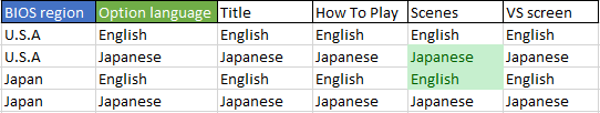

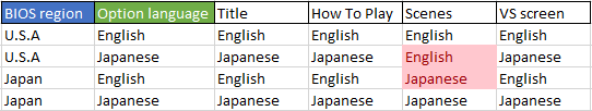

My small contribution here is to resolve the issue Layer33 highlighted. (we want Japan BIOS to also run English if set in Options)
Summary of the current (CCD0DB7A):
Patch result (574195C1):
At address $9DDD6, change 837D to 1560.
To ack, I just changed the BIOS check for Japan to a check if $10E015 != 01 (English), skip patch. Nice and neat.
[Correction: check if $10E015 == 0 (Japanese), skip patch]

Thanks. The check is actually if $10E015 == 0, skip patch. Not sure if that matters to folks are not, just means if you pick spanish or portuguese it will still apply the patch.
Yes, you're right. Careless copy-paste from my working text.
And yes about the Portuguese and Spanish showing up the English text as well.
