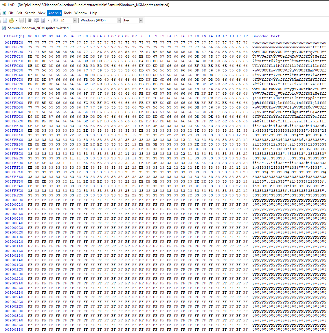

.sprites.swizzled files (from the "MAIN" folder) contain the ROMs IMO
the .swizzle being it would be a good guess. My investigation:

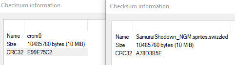

This is the SamuraiShodown_NGM.sprites.swizzled in hex.
Blanked out after offset 00900000
It's the same size as the crom but when comparing is different. Using SmokeMonster rollup Beta 3.1

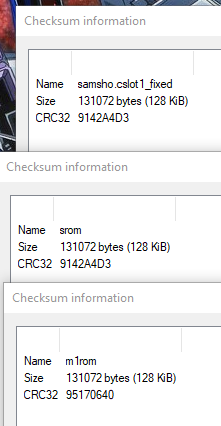

Continuing: samsho.cslot1_fixed matches the srom
Continuing with this:
samsho.cslot1_ymsnd matches vroma0
Didn't find any other matches
So umm.. that's a start

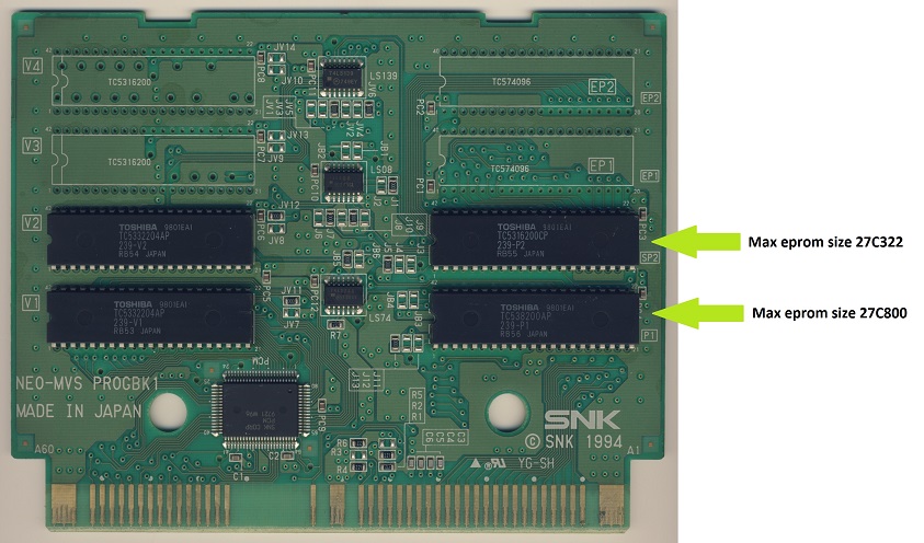

Would it be possible to run a fully decrypted set of this on a BK1/CHA512 pcb set?
I have been trying to understand how to getting the bankswitching for the decrypted P rom to work, but the BK1 pcb can not handle the size SSVFE uses from what I can tell..
Any way around this 27C800+27C322 eprom limit for the P1 & SP2 slots? (or could the SSVFE P roms contain dummy data at the en that we could cut like ms5 P roms does?)
Would be frekkin awesome to put this baby on a single pcb set :D
you'll also likely have problems with the V-Roms and C-ROMs there is only room for 4x 27c160 V-ROMs (64Mbit total) and 6x 27c322 C-ROMs (192Mbit total) original carts had special Mask ROMs that doubled those numbers.
pretty much everything that released on the BK1 or newer PROG board used those special over-sized V-ROMs, and everything that released on the 512Y or newer CHA board used the special over-sized C-ROMs.
