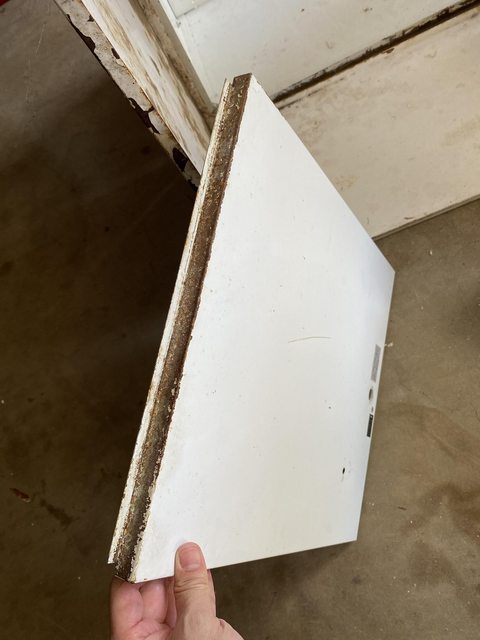

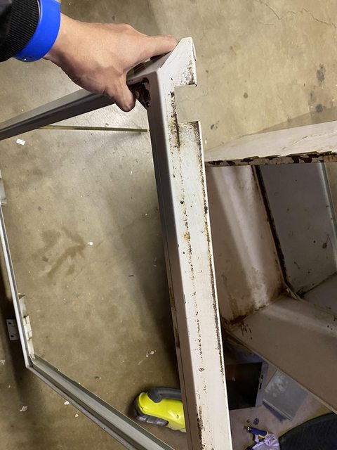

The service door was funky, especially on the bottom edge. Bunch of rust and scratches.

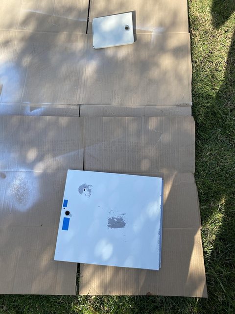

So I sanded it down the best I could and prepped it for a fresh coat of paint (making sure to tape off the stickers):
Also got the cash box door prepped for a refresh:
Boom!
Also threw some paint on the Control Panel base, getting ready for my top panel surround to arrive:

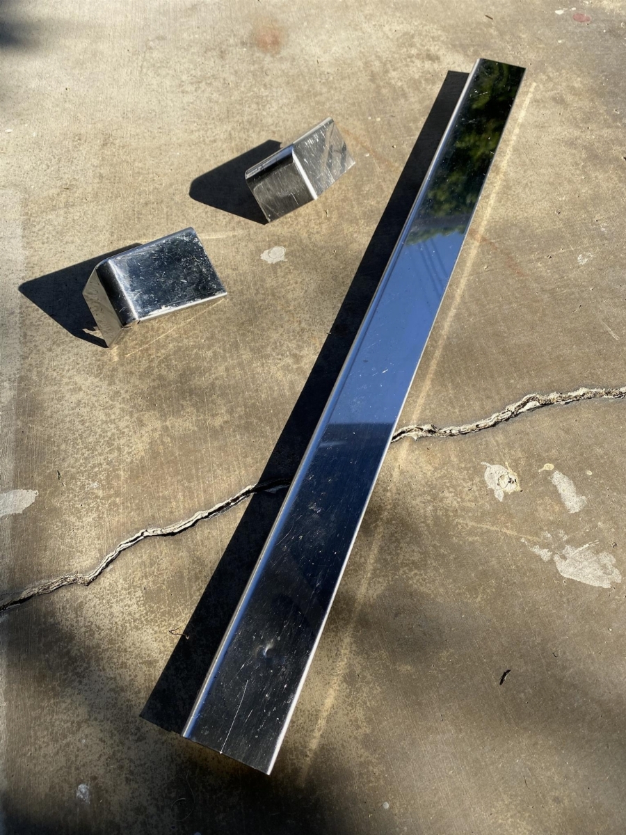

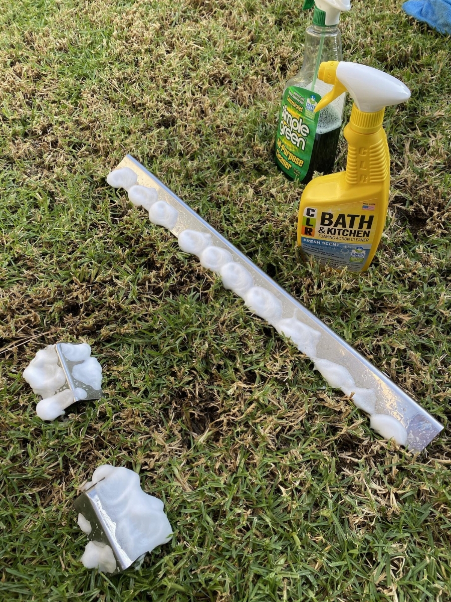

I pivoted from the painting while waiting for these pieces to dry, and concentrated efforts on the metal parts at the base. They were suffering from some build-up from the elements, maybe water scum, mixed with dirt...who knows.
As the man of the house, I'm relegated to doing the crappy chores, like putting out the trash, or scrubbing the bathrooms. So I know the best way to get scum off of the facets is to use CLR. You just spray the metals, let it sit for 5-10 mins and let the foam do the work for you. Then you just lightly scrub it away with a magic eraser and they come out looking shiny.
Mirror-like finish!

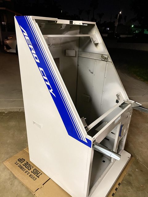

I couldn't wait. Had to see how all these painted parts looked together.
Super clean. The determination you have is unreal. It would probably take me months to get to where you're at right now with this Aero.
