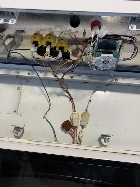

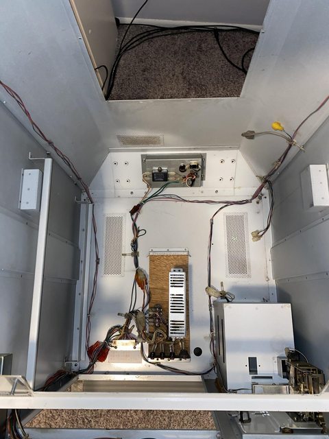

For the cabinet I finished off cleaning the wiring and re-populating it into the cabinet.

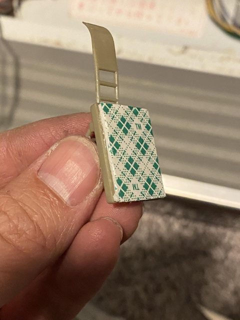

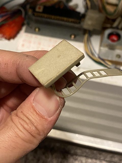

One of the things that bugs me in these japanese cabinets are these cable ties. They tend to lose their stickiness in the pads, so you have cables dangling around willy-nilly.
I replaced the double sided foam tape on all the ones that were worn out and put them back into their original spots:
Clean and organized:

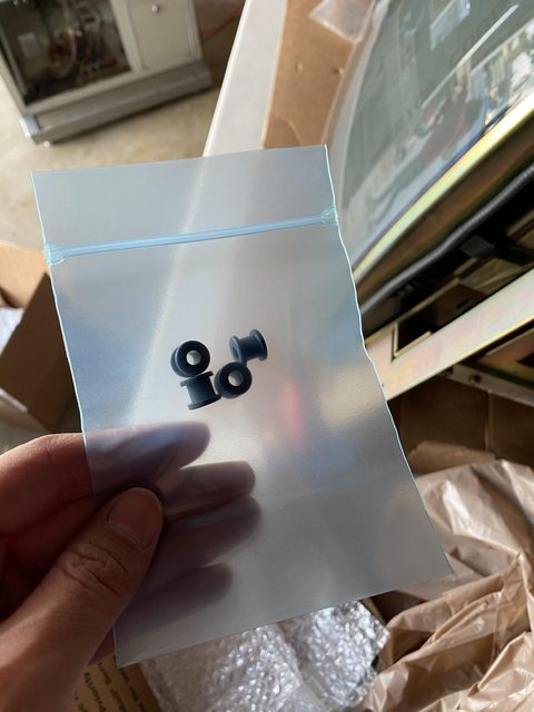

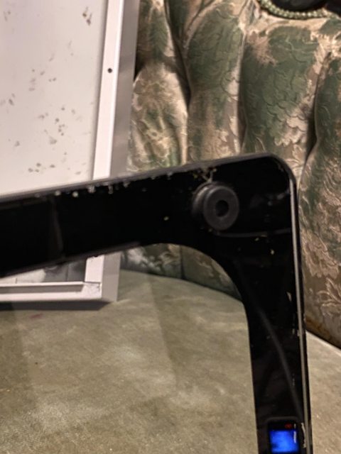

The rubber grommets came in, courtesy of @RandomRetro, which fit perfectly.

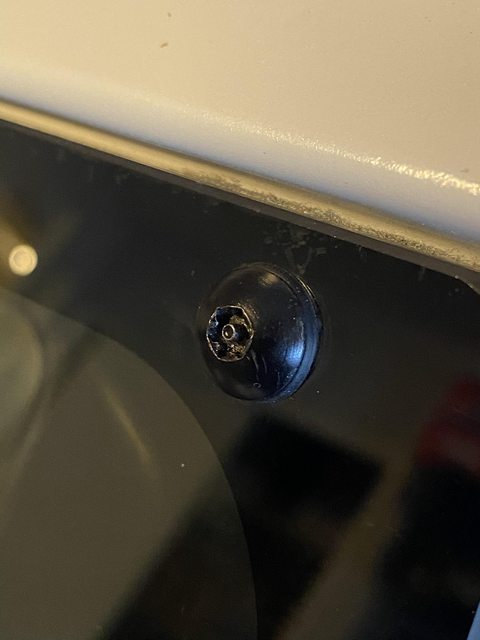

I also repainted the black screws holding my monitor down. The darkness!:

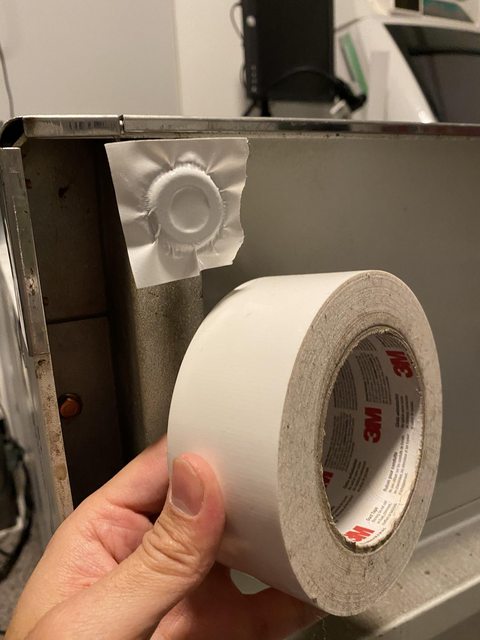

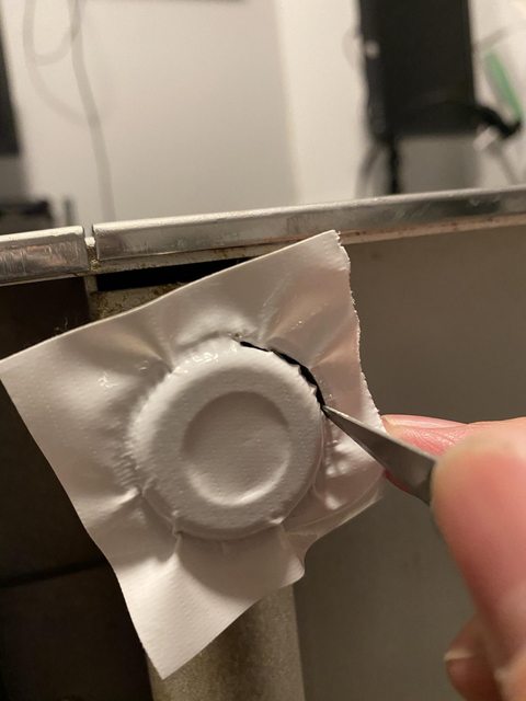

Here's pro-tip for people putting cabinets on carpet and want to be able to slide them around when re-positioning. When I used to play ice hockey, I used to get really bad blisters and calices on the bottom of my feet from my hockey skates. One of the tips that a teammate gave me was to tape my feet up with duct tape. Not kidding. The duck tape is not only strong and sticky enough to stay on your feet, but also reduces the friction inside your skates, lessening the amount of chafing and rubbing on your feet. This is a tip for hikers too, it greatly helps keep your feet from blistering.
I applied this same knowledge to the feet of my cabinet so I can slide it around on carpet if need be.
I only had white Duct tape on hand, Silver is the best because it has the more slippery contact, but this will do for now:
Cut-off the exccess:
Done, protected cabinet feet from blisters and calices ;)

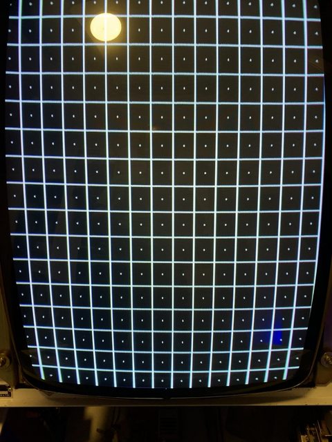

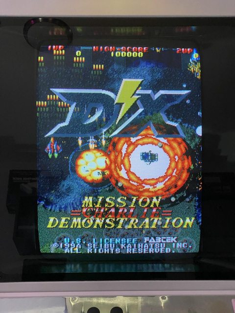

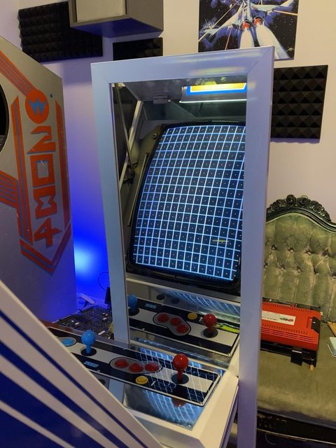

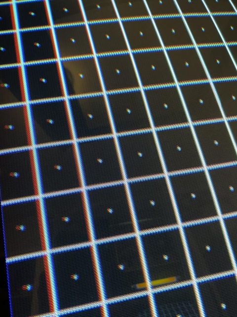

I put everything back together, but I still wasn't satisfied with the monitor. The convergence was off, and couldn't get it to align properly after fiddling with it for an hour:
Turned out it needed just a bit of a rejuv on the red gun, so I hit it once and saw those satisfying cleaning sparks in the neck, and was able to easily converge it after. Super sharp and better brightness/contrast now!
I'm really happy with the way the monitor turned out. It's super nice, and my tracking reading show that the guns are still really healthy, so I should be able to get a few more decades out of this tube.

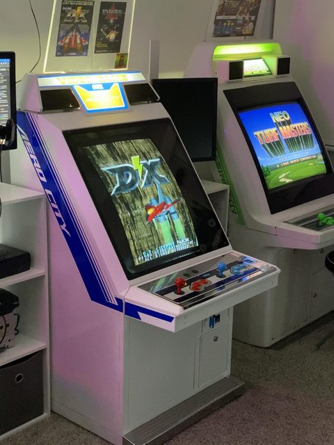

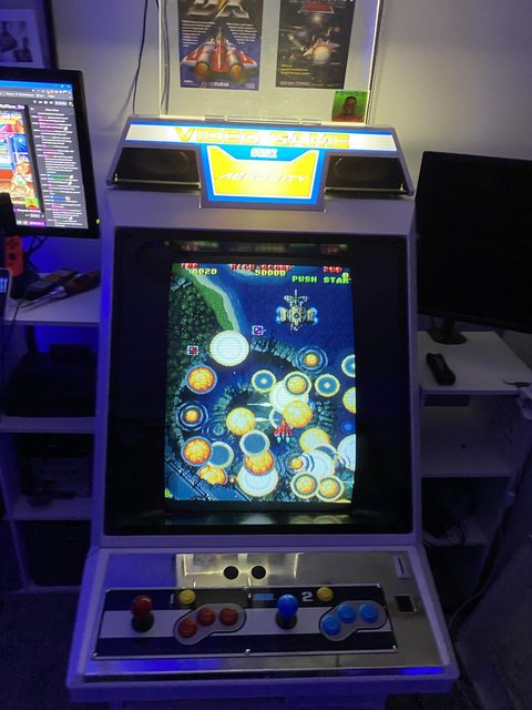

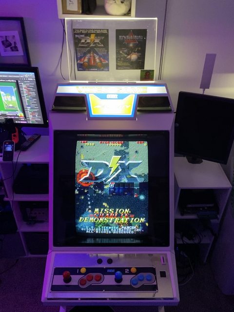

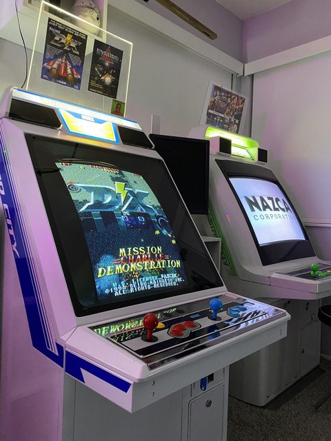

Got everything back up and did some test runs with a couple oldschool favorites. Here are the glory pics:
I really love how the marquee light shines upwards into the topper, lighting up the flyer art i have in there:
This concludes the bulk of the project.

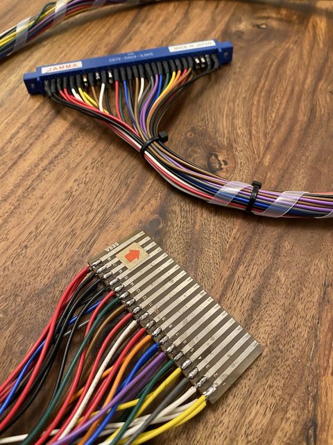

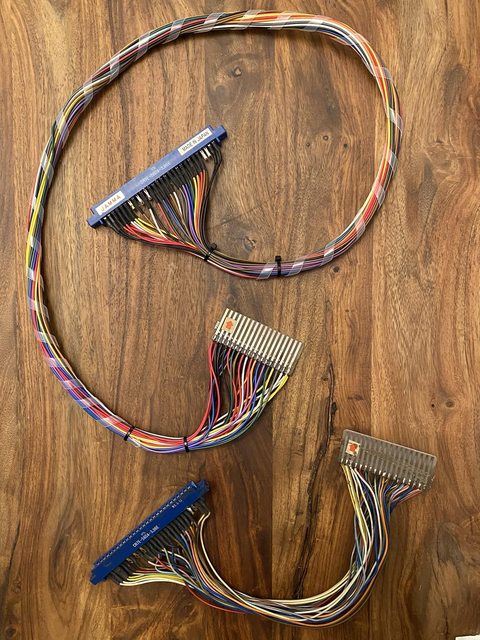

4. Re-solder a new Jamma loom onto the Sega fingerboard. @KaPH33n is right, these adapters are so short and frail, you can barely reach a mounted board. I got a fresh loom I can use till i do a proper JAMMA conversion later on.
Why can't you use a jamma extension?
it’s not that I can’t use it, it’s more that the cable is really short with no give, and I feel like I’m tugging on it too much when switching boards. Something I do a lot of, especially when streaming.
a longer adapter with more slack would be safer.

wow. So a rejuvenator can help with convergence issues. Didn't know that!
Hatsune Mike
Dec 8, 2017
645
1,696
Northern California
A rejuvenation won't help with convergence. However, if focus is adjusted after, that may help a little bit in a roundabout way.
mike’s right. My apologies, I should have elaborated more. My problem with getting the convergence dialled-in was mainly I couldn’t get a strong enough beam out of the red gun without cranking up the gain to a high output. This made it make the red gun shift slightly causing me to unable to focus the beam properly. After the rejuv the red was bright and more focused so I was able to pinpoint the position between as well as tweak with the focus pot on the flyback to really get it sharp.
Rejuv itself doesn’t fix convergence, it just helps get a brighter beam for you to work with.

Congrats! Epic and awesome, although my dreams are shattered with the duct tape revelation. Has nobody taught you about teflon coated leg levellers? :thumbsup:
haha yeah I know about them. But I wanted to keep the original legs on. If I can find a way of securely fastening Teflon to these legs, I’d try that.

Haha I know everyone’s not a big fan of the duct tape, but it works! But...maybe I’ll look into a less ghetto solution X/

Small update, I got around to building a longer Aero City-to-JAMMA adapter using a spare NOS Sanwa JAMMA loom I have been holding onto for a long while.
This loom will eventually be used for the full JAMMA conversion I do to the cabinet in the future.

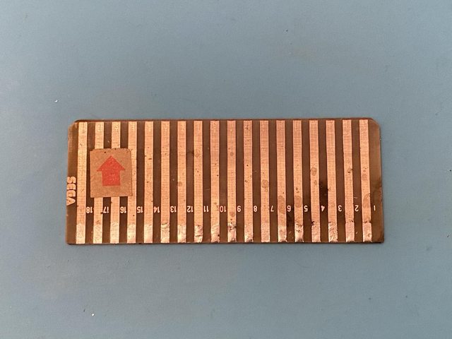

I pulled the fingerboard off the adapter that came with the Moon Patrol PCB and cleaned it as best I could.
Started soldering the newer wires, following the pinout specified in the Aero City manual.
...and Done!
Now I don’t need to be struggling with that short original adapter. :thumbsup:

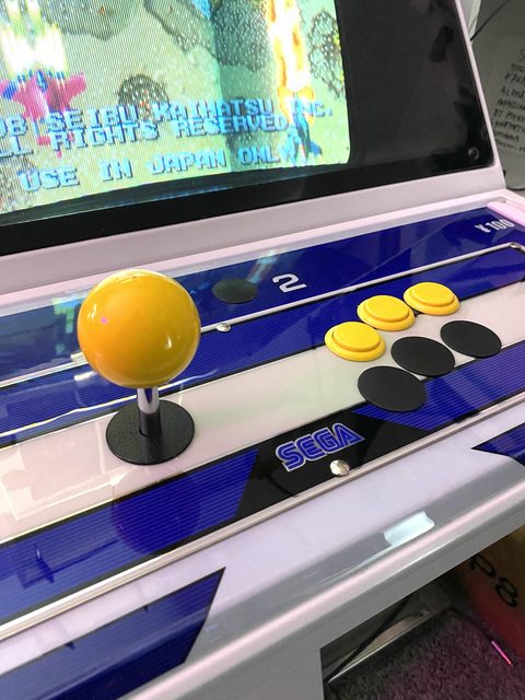

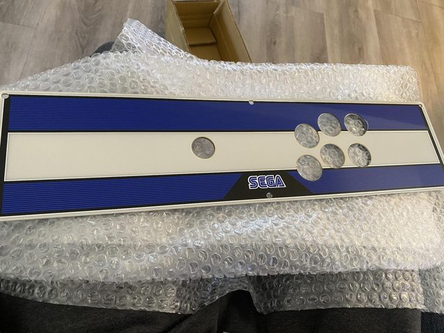

I re-crimped a new and updated 1-player control panel harness with nicer QD’s and a joystick JST connector used on most modern joysticks now.

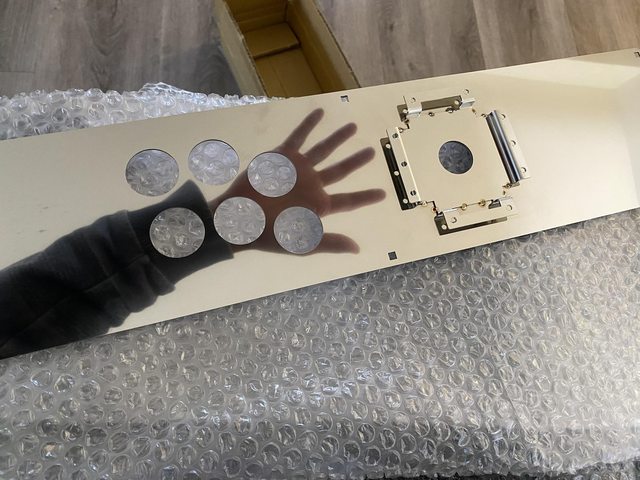

Ended up Receiving an @alberto1225 repro panel, and I gotta say, this is the highest quality repro you’re going to find out there right now.
The Sega Logo and silver lines are reflective!!
Incredible quality. The bottom is also very clean and reflective, plus the mounts are properly placed and gives you a lot of versatility in different mounting plates you can use. I highly recommend alberto’s panels!

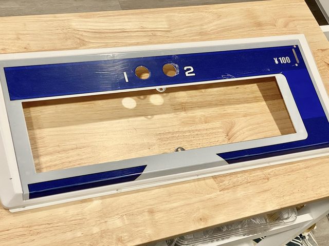

I applied the surround overlay using my vinyl art technique when I restore wood cabs. Really easy to go on:
I screwed up though. I should have painted the surround first to get the overlay to look brighter than the print. I didn’t realize the print was a bit translucent, so it took on a darker tone when it was applied to the bare metal.
No matter, it doesn’t look too bad when on the cabinet.

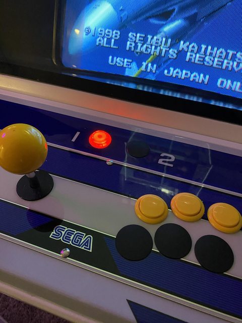

added my choice of yellow controls with an oversized 45mm balltop (standard is 35mm dia)
Wiring is a hellava lot cleaner than before:
I wanted a subtle bling to it, so I added a led start button to p1 and wires 5v up to it to power on.
