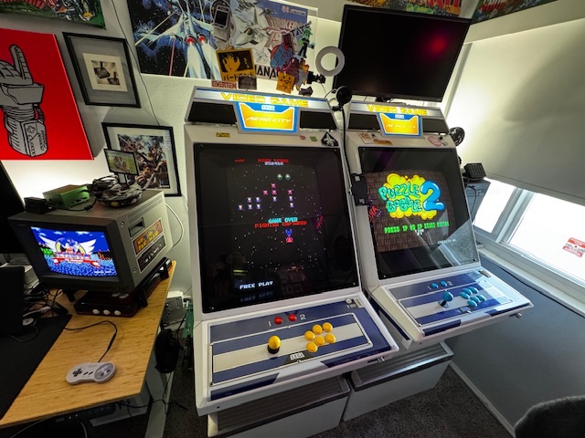

I just wanted to do one last post to this restoration.
Unfortunately I had to sell these two Aero’s last month due to some unfortunate life events that put me in a financial bind. I’m not about to go into details as I’m not the type who airs all their life traumas publicly.

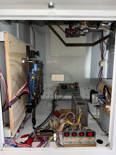

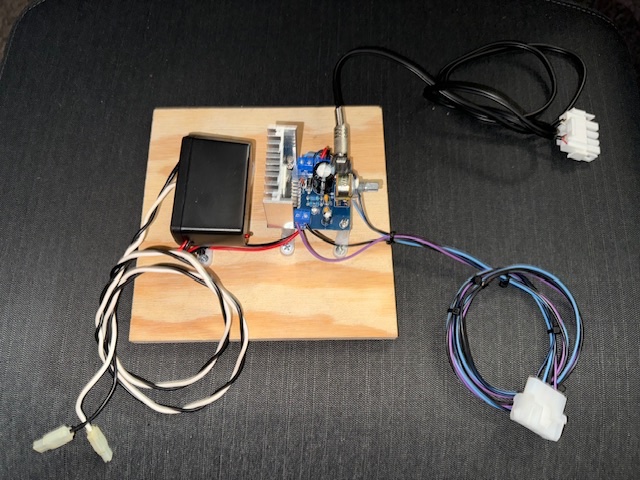

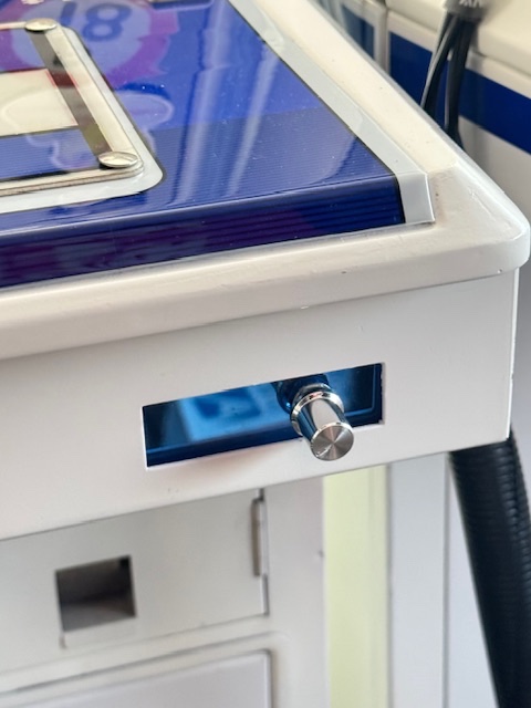

But I did want to talk about the final update I did to both of my Aero’s: Stereo amp and headphone jack volume control.
I had built this little audio block and mounted it to the inside of the cab. There are two holes in the cash box metal that I mounted these to.
This consists of an amp, a DC adapter that integrates cleanly and non-destructively into the aero.
AC is tapped from the power terminal block, which goes directly to the amp adapter to power the amp.

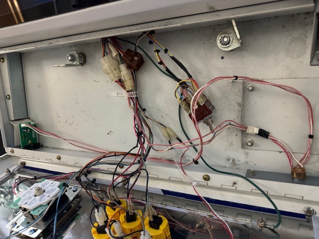

For the headphone jack volume control I mounted a pot to control the little headphone PCB. Pretty simple, the audio comes in from the 3 pin connector in the CP (pink, pink/blue, white wires) goes to the pot, then outputs to the headphone PCB.
Nice thing about this is the headphone and cab speaker’s volume is controlled separately.
And that’s it! Here’s a couple of the last pics I took of these cabs till they went to their new home. A local arcade collector and fgc homie got them so I know they’re in a good home now. Farewell Aero City’s, you are fantastic cabs I will miss you both dearly 😘
