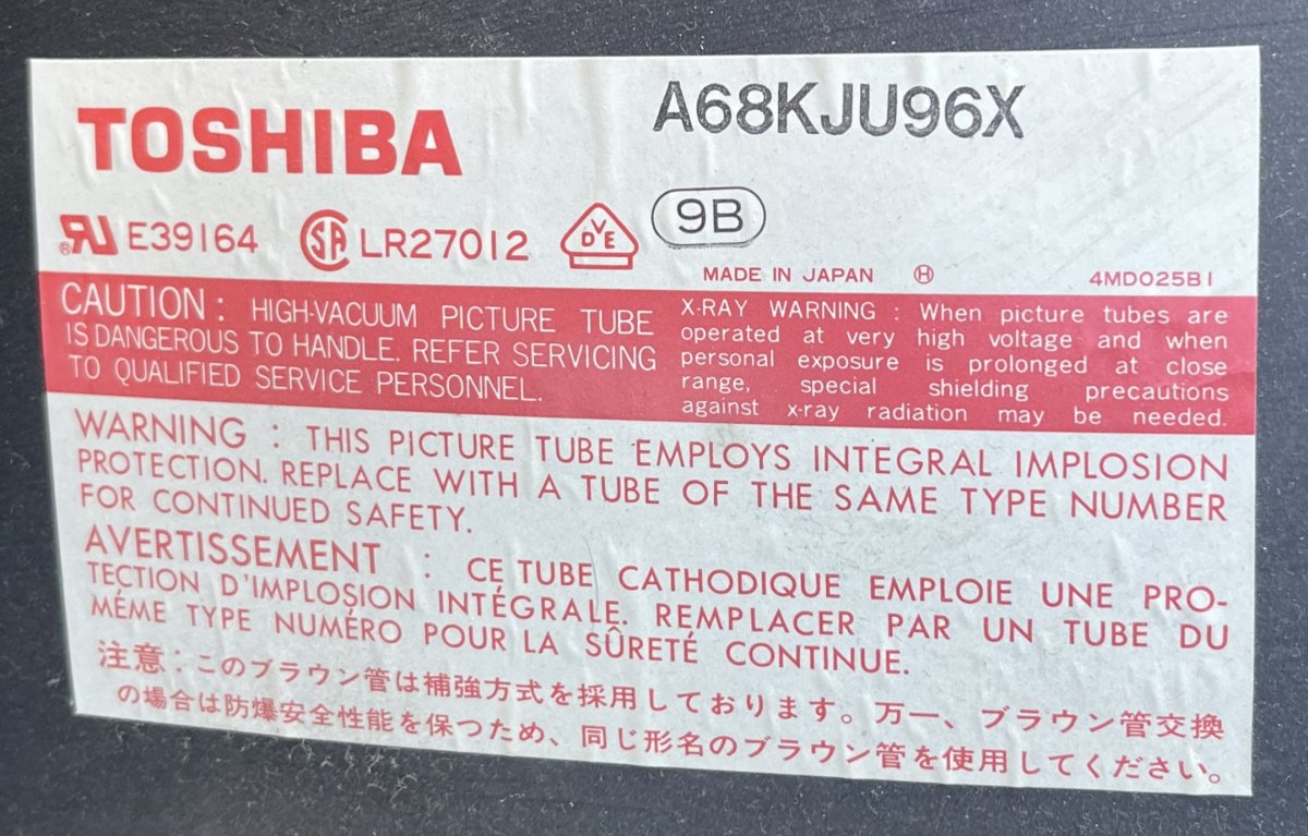

What tube do you have? Post a picture
Look for something like this sticker
I don’t have the monitor with me at the moment. I’ll send it over when I have it back in my possession.
