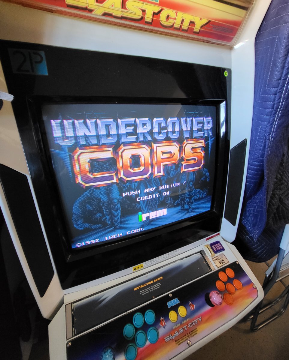

I had the exact same issue on my blast with no red. It turned out for me it was the RED (pin12) wire on the jamma connector that came loose or broke. That damn magnet thing on those wires is so damn tight any wrong movement and rips it out.
Check that with flashlight and lighty pull on it see if it comes off or it's damaged.
