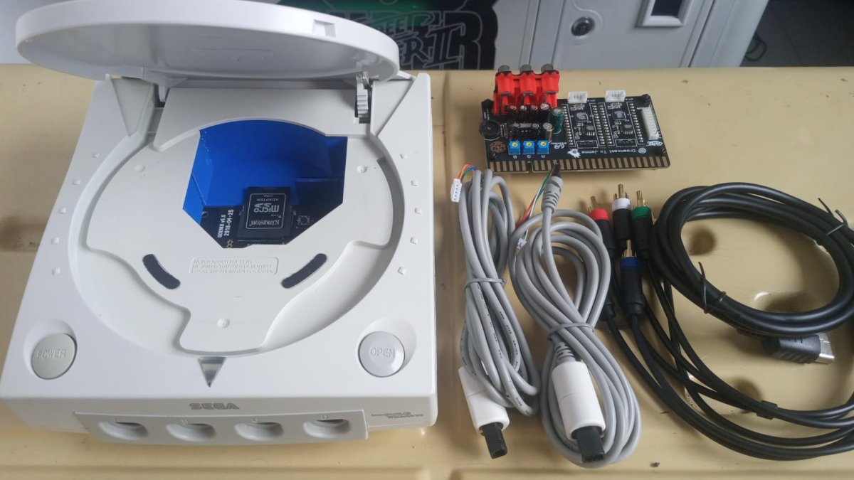

I just received my adapter here in Brazil, I will test and post the result here.
What I was in doubt was about the VMU but to my surprise it already has a save VMU integrated in the adapter.

Have the same issue with button mapping, will check if I can get it working with an adapter. For now only the 2p stick is working and no buttons yet 😑
The new model, even with the kick connector, maintains the CHAMMA pinout, with the kicks also on pins 25, 26, 27 of the jamma.
This caused me a problem because my jamma uses pins 27, 28 for GND causing controller triggers to stay on.
Solved this problem of triggers triggered image test was ok, audio test in mono ok, now I'm having a problem with the audio in the stereo amplifier, for some reason I'm having an absurd interference in the sound, I'm in contact with the manufacturer to try a possible solution.
