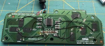

Sorry to revive an old thread, but I wanted to share my experience following Alex's instructions on hooking a genesis controller up to a jamma harness.
On my first go of it, I ended up with some buttons that were always registering--I'd be playing a shooter and bombs would be going off all the time ^^
I hooked it up to a jamma tester and saw buttons faintly lit--
I guess I did not cut the traces well enough?--here is a pic of the controller:
Eventually I did get it working well enough; It is a bit of a mess though--anyone know where to source those grey 9 pin plugs?
Overall I'm very happy with how it turned out!
