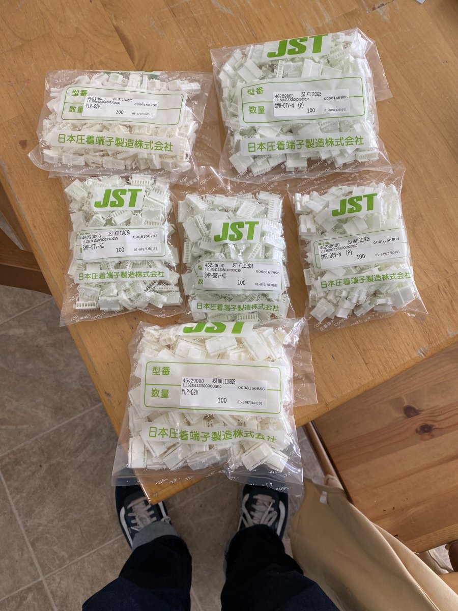

I will be making 50 sets.
I'll try to keep the cost on these as low as possible but damned if the connectors aren't as rare as hen's teeth, it seems.

Parts are slowly rolling in for the P.RAS/Ringedge multi home button and card reader harnesses I will be doing a batch of.
50 complete harnesses:

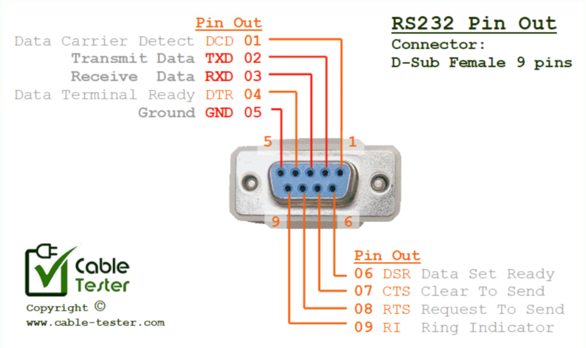

to add to this, primarily because I'm an I D I O T , here's the pinout for the 9 pin. We want pins 2, 3, and 5:

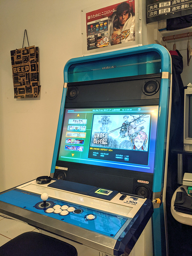

Thanks for the assistance here guys, was able to build the Aime & home button harness and get the official APM multi up and running. It's cool but it takes ages to boot, I haven't timed it but feels like 20 minutes, with a button press in between.
  • Like
Reactions: nem
Ayyy have a link to the apm multi? Is this niko’s?
No this is the official Sega multi, as used in arcades. Same games as a Niko multi (but without the ability to add stuff like Virtua Tennis 4). Takes f o r e v e r to boot. It does save settings and scores unlike the Niko multi. Requires an Aime reader connected and home button to return to menu. There's no way to download this as far as I know, you have to get an RE2 from Cereth with it loaded ($250). I tried putting the drives in another multi-badged RE2 and it didn't work with error 0701 so I think it's tied to the mainboard SN.
Pluses of the official multi: cool menu, saves scores/settings
Minuses: Seriously the boot time takes ages, no "extra" games, requires reader to boot, if/when it dies you're done
Pluses of Niko: Fast boot, extra games can be added (but it's a pain to do so), you can always make a new drive if it dies and it will work on any RE2
Minuses: settings/scores don't save when you switch games, menu not as cool as the real deal
EDIT: I verified the home button works same way both on Niko and official APM, so if anyone wants to leave games without using test (must be in attract mode, not during gameplay), hit up Lemony for that harness
