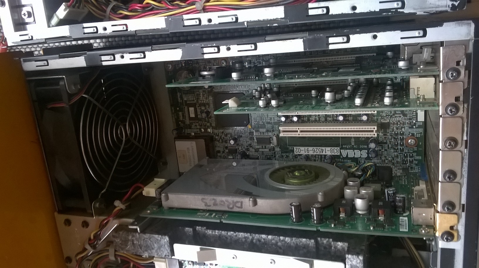

some more pics.

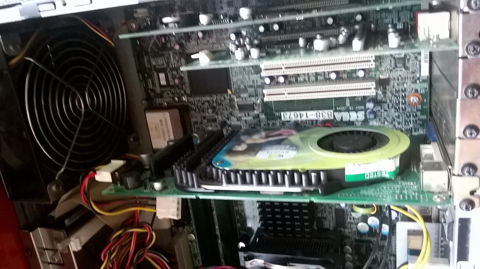

hotd4 with the org. nvidia 6800 videocard + org installations dvd

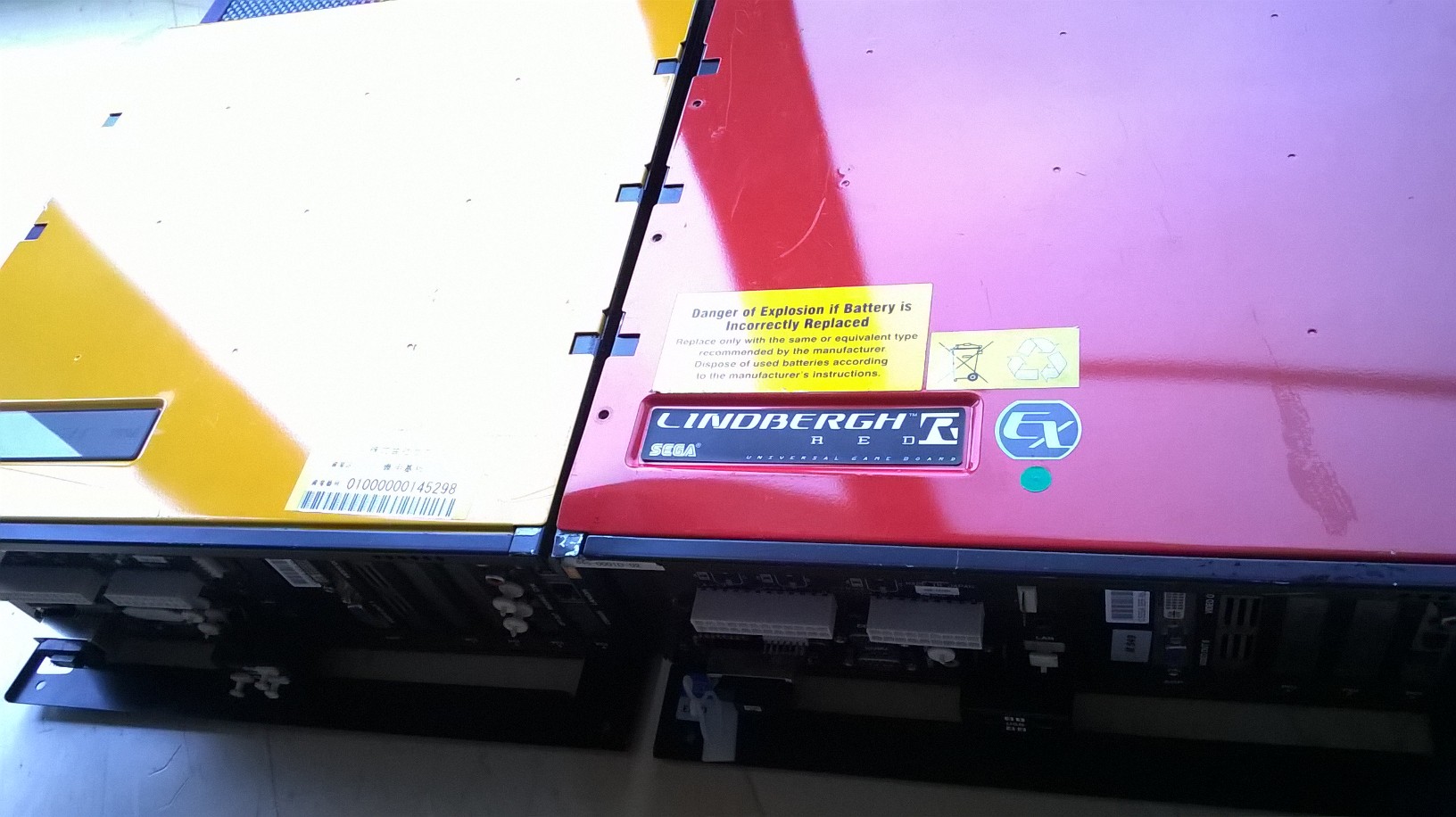

r-tuned with the org. nvidia 7800 videocard + copied installation dvd (sega sent me a link for download)
