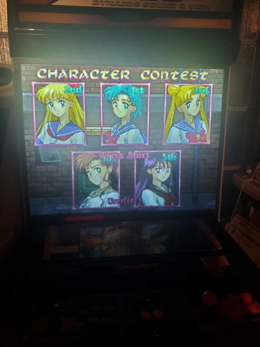

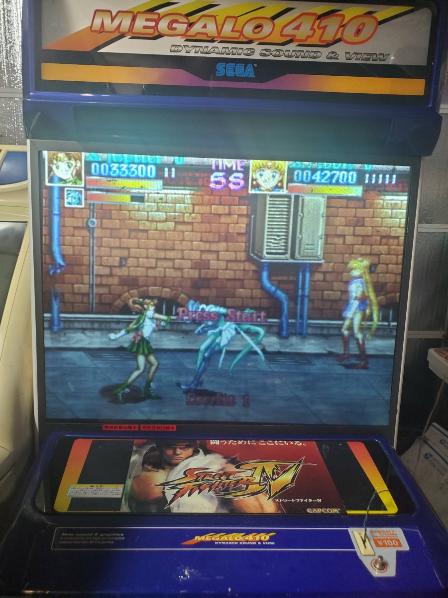

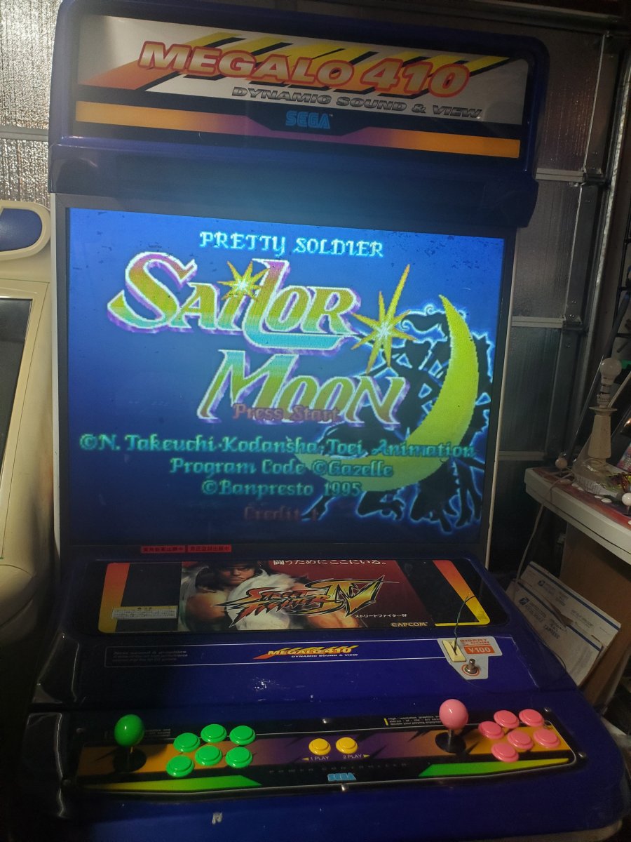

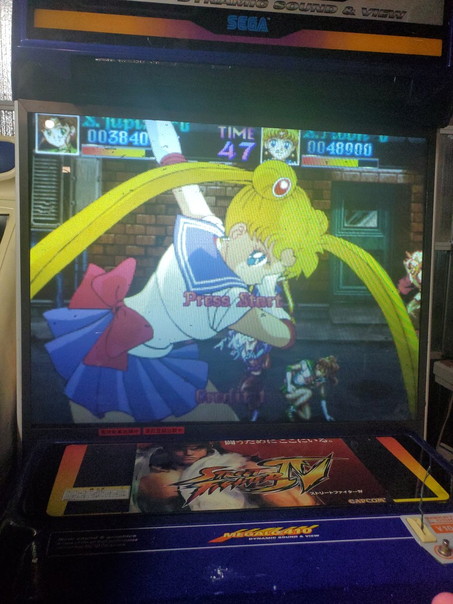

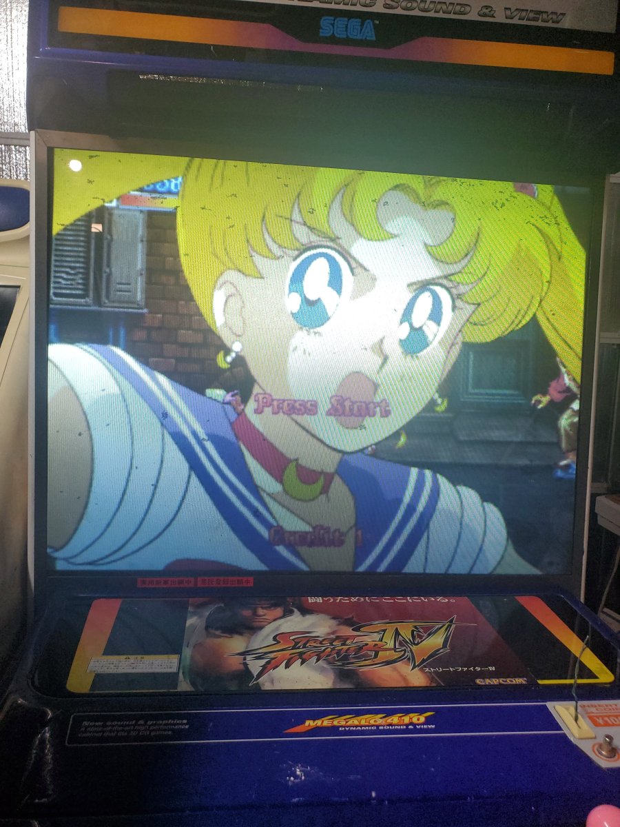

Shout out to @tiff_lee and everyone else who helped out in this journey. It's stacked up with books and boxes until the mount arrives, but she looks pretty great with the BenQ MX819ST. Very nice picture and wayyyy easier to adjust keystone on this than the Hitachi.

Good effort mate, your persistence paid off looks great.

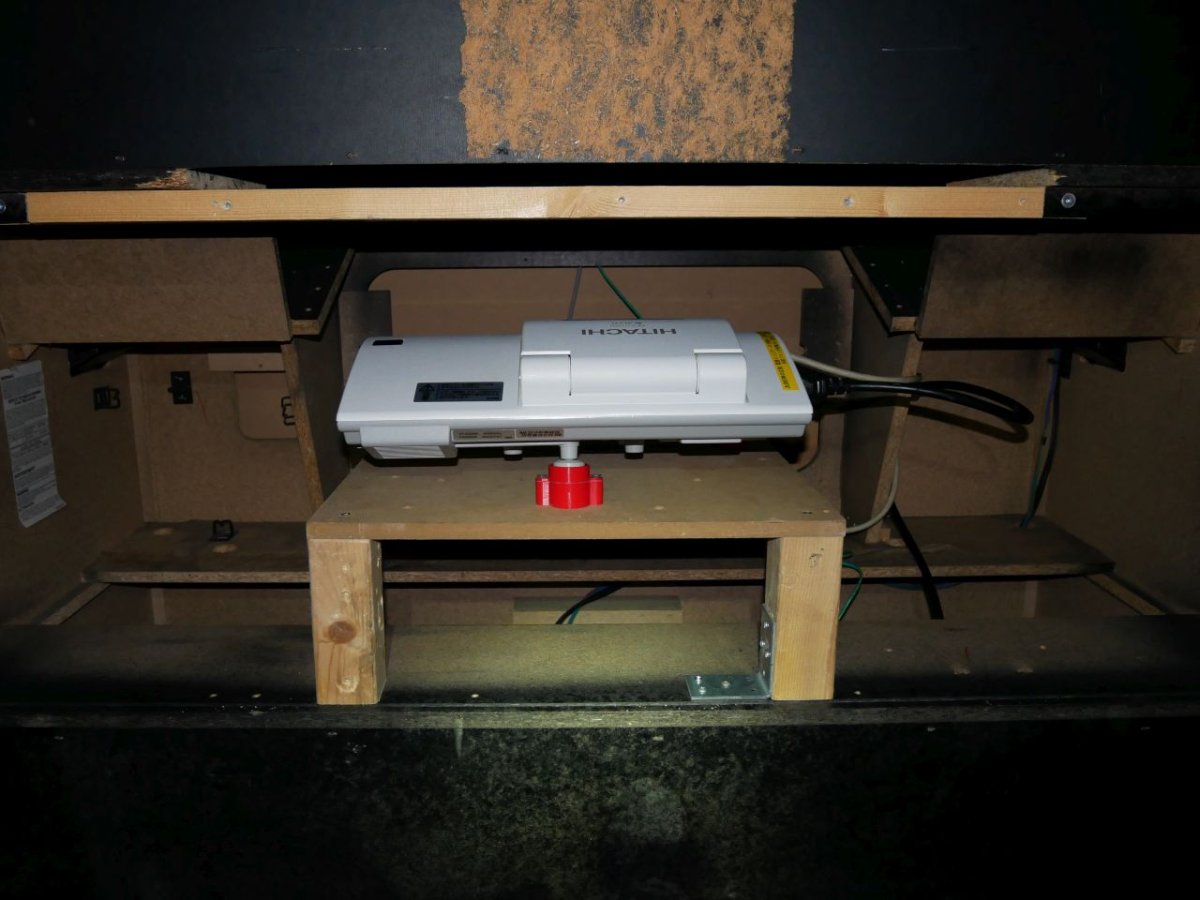

I have the Hitachi projector in the cab now.
The original rear projection monitor came with a lenticular lens and a fresnel lens. The fresnel lens does even out the brightness, but it also makes the picture out of focus. The lens I have is also pretty badly scratched, and the scratches are very visible. So I left the fresnel lens out and just went with the lenticular lens.
Setting up was very easy. I kept putting down things underneath the projector until I found a good spot for it. I was also able to see the screen from the back, so I didn't have to run back and forth.
I didn't adjust the keystone at all, I left it at the minimum setting. Due to the lenticular lens, I found the picture looks the best when the angle is small as possible.
The picture is certainly bright enough. I have the projector in eco mode and I still had turn to down brightness.
I'm currently making a shelf for it out of wood and 3D printing coasters for the feet that can be screwed down. The projector will just drop in place and hopefully stay there.
While I think it's better than the LCD I had before, it's not perfect. It's more bright at the bottom than the the top, contrast is kind of poor and it doesn't handle motion super well.

Trying to find the back and the front? Have the projector facing the rear of the where the glass would be and then set the projector to rear projection mode in the menu.
It would probably work even better if you have the original mirror and have it projecting through that. I didn't, mine had been thrown out. So I have the projector facing straight towards the screen from inside the cab at the lowest possible angle. It looks OK if you're looking at the screen dead-on. It looks better if you're looking at it from above. It looks worse if you're looking at it from below. It's due to the lenticular lens.
Here's the setup:
If you're interested in replacing the mirror I can provide pics/dimensions of the setup and mounting. One of mine had shattered mirror and I just bought a replacement and cut it to size, my other megalo with a mirror still uses an acrylic mirror so is heaps lighter.
