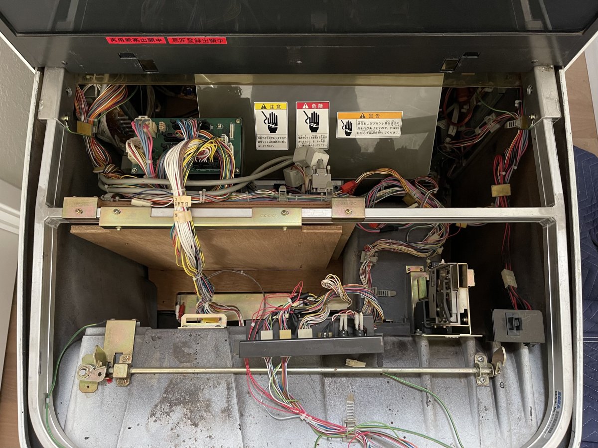

New Megalo 410 owner checking in. This one's in pretty decent shape overall, though the projector is in need of servicing. I have an original panel for it too which I'll fit.
I'm a bit surprised at how cramped inside it is. The projector gubbins really do take up a lot of space!

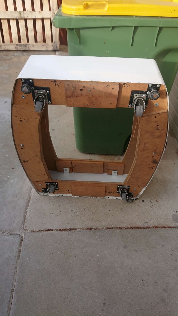

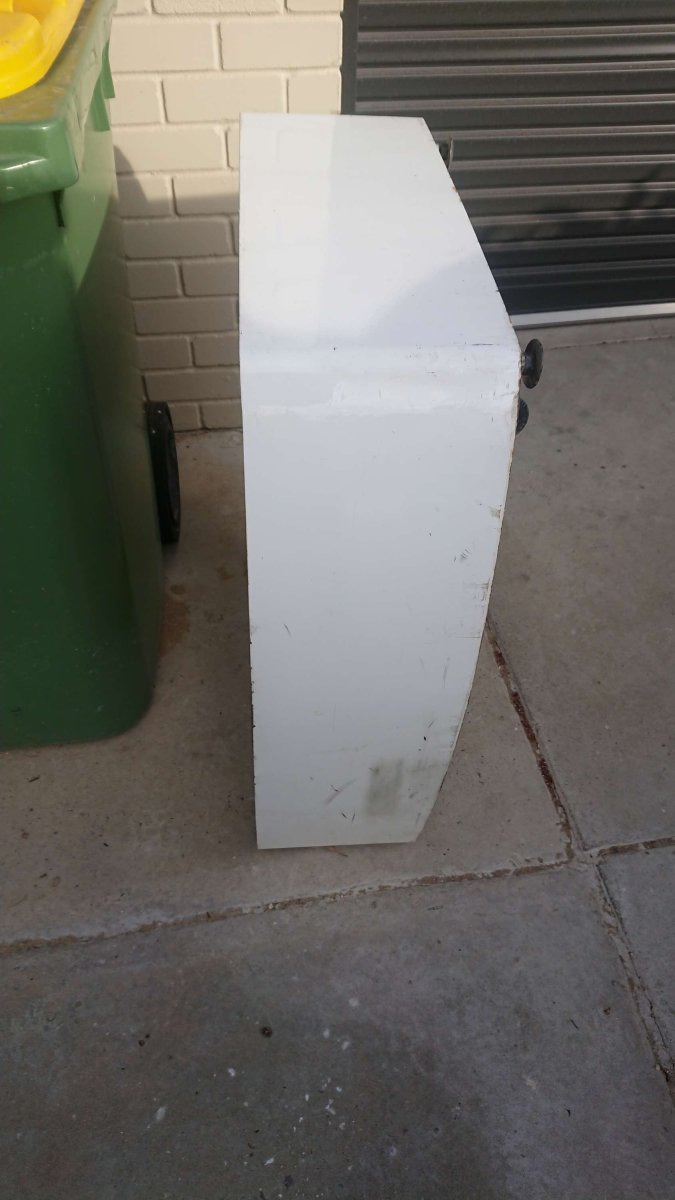

Something else Megalo 410 related, not sure if anyone has ever seen a riser for these before (to make it a stand up cab) but I had two cabs with them (one was beaten up in shipping) and both have been removed anyway.

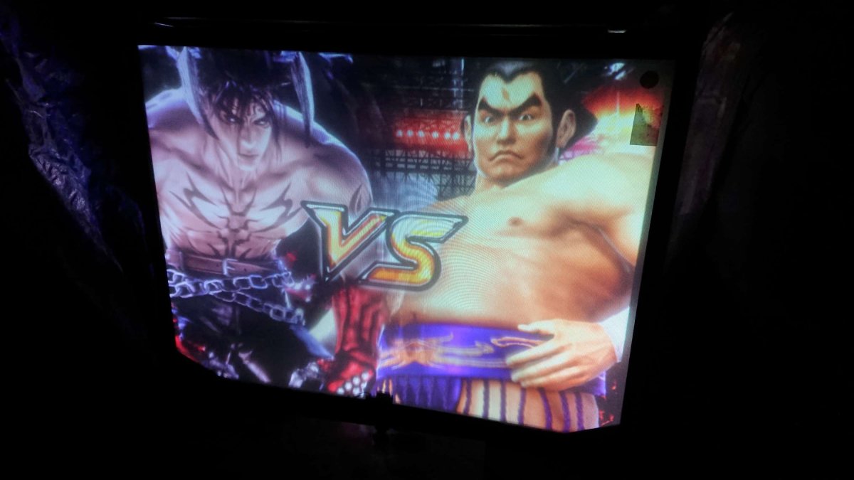

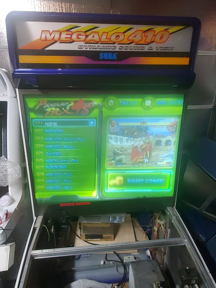

Sorry for the necro-bump, but I had to post in here. I complicated my life a bit trying to use the trapezoid mirror. I could NOT get it to look right with any key stone setting, even custom setting. I almost gave up after almost 2hrs messing with settings. I removed the trapezoid mirror and during me messing with my Hitachi CP-A222WN XGA (THANK YOU @hoagtech ) I remembered most projectors allow you to change the set up/installation setting. This one let's you do hanging, reverse, Upside down, etc. I got the bright idea to try reverse throw without the mirror straight onto the fresnel and low and behold! This is the image I got without adjusting any keystone or zoom at all!! Yet....... I'll update pics in the morning after I fine-tune it. If you find one of these babies without the sought-after trapezoid mirror, grab it still. You can still use this beauty without it!

can't remember which one I tested with off top of my head, it was a slightly higher number but from that same family of projectors. There must be something amiss there it is designed to be that close to screens hence the ultra short throw yet ability to produce a larger image. Retaining the fresnel lens may cause problems as that was intended for use with the 3 separate tubes to increase the image size and improve brightness neither of which are required using the modern day projector (all the optics are handled inside the projector) .
This was taken with a Hitachi ultra short
Was very rough and ready test, I just sat the projector behind the fresnel as far back as I could while maintaining space for the rear cover, looked fine in person although this image does capture the concentric rings of the fresnel
That looks great 👍

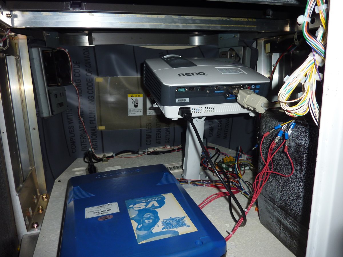

Would you recommend the BenQ MX819ST?

To clarify that image is using a Hitachi,
That BenQ works ok but its a pain to setup, you will have to physically move the projector closer or further away from the screen to get the correct size image as it has no zoom function like the 632st
