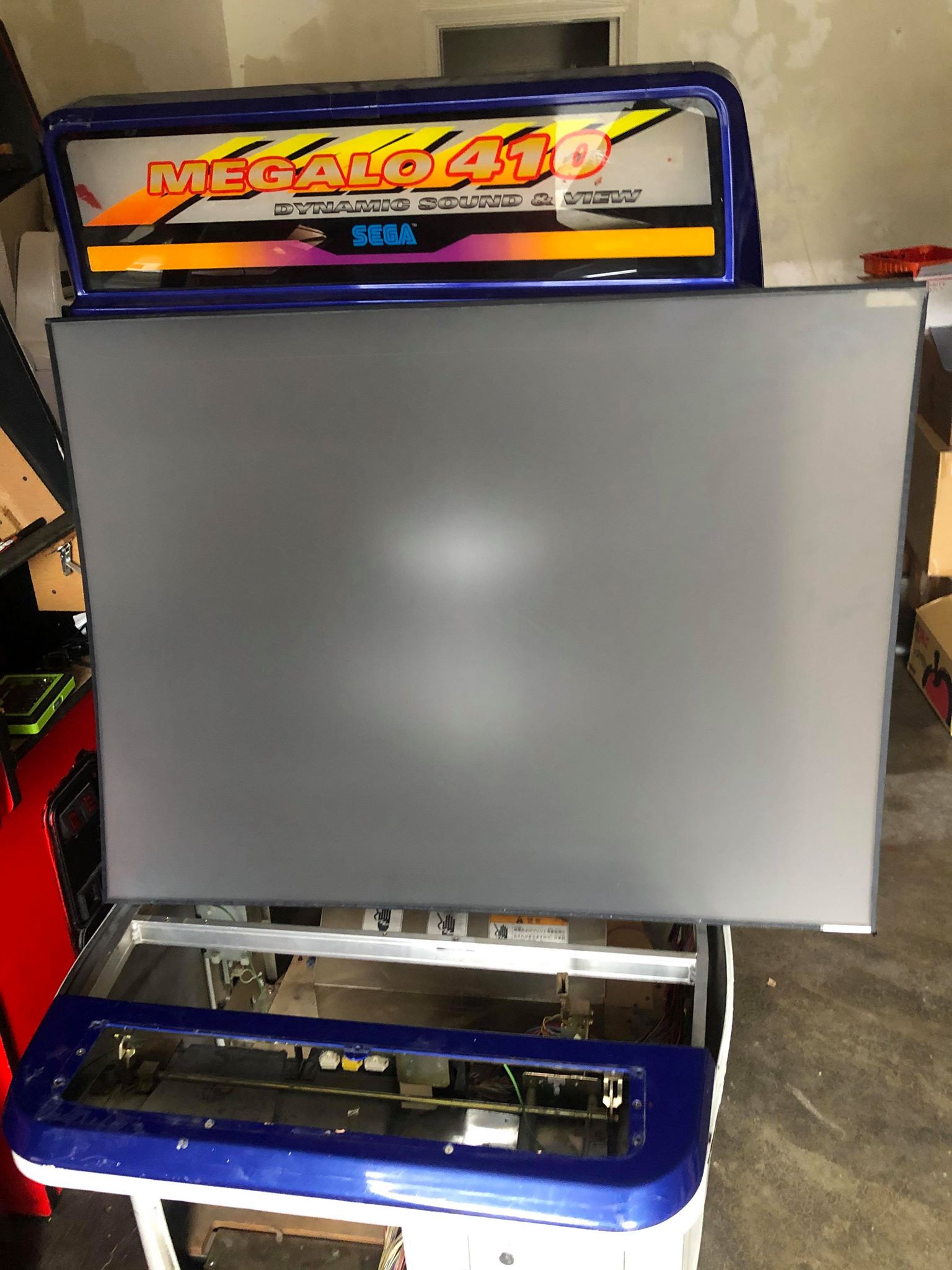

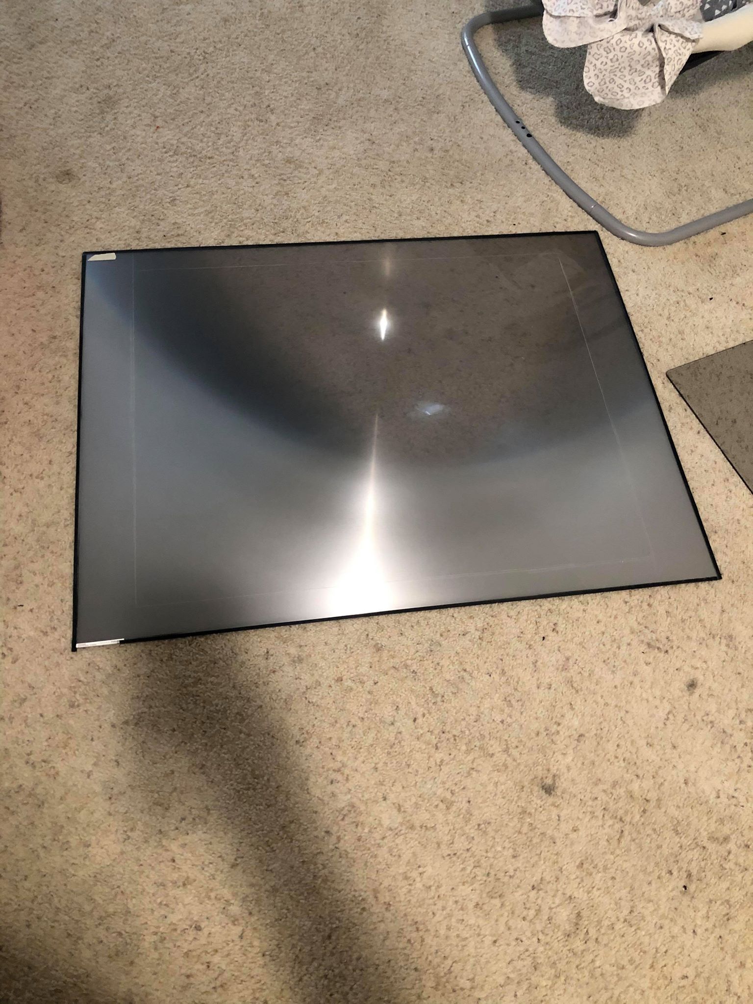

I chopped up a Sony SXRD today and cut a screen for my cab with a scoring knife. Got a nice cut also that bled like hell.. I don't know how well this will hold up when the projector I get hits it. It sure looks WAYYYY better than it did. In the first image you can see my cab glass laid right onto it before cutting so I could just use that as a scoring guide. Second image is the screen itself installed. Finale image is the glass installed over the screen. Also, the screen sustained a crack at the bottom of the plexi when I was working on it. As long as weathering doesn't make that crack travel I might be okay, made a lazy attempt to seal it a bit with super glue I don't think it is in the screen view. This plexi has a black film. I also scored a rather nice mirror out of that tv. When cut to size it'll be a nice mock of and original. If only I had the brackets. I'll figure out something. This is a major step forward if it worked out. I'll see. I have a fresnel lens also, but I haven't cut it and probably won't bother if the Benq dodges that step for me.

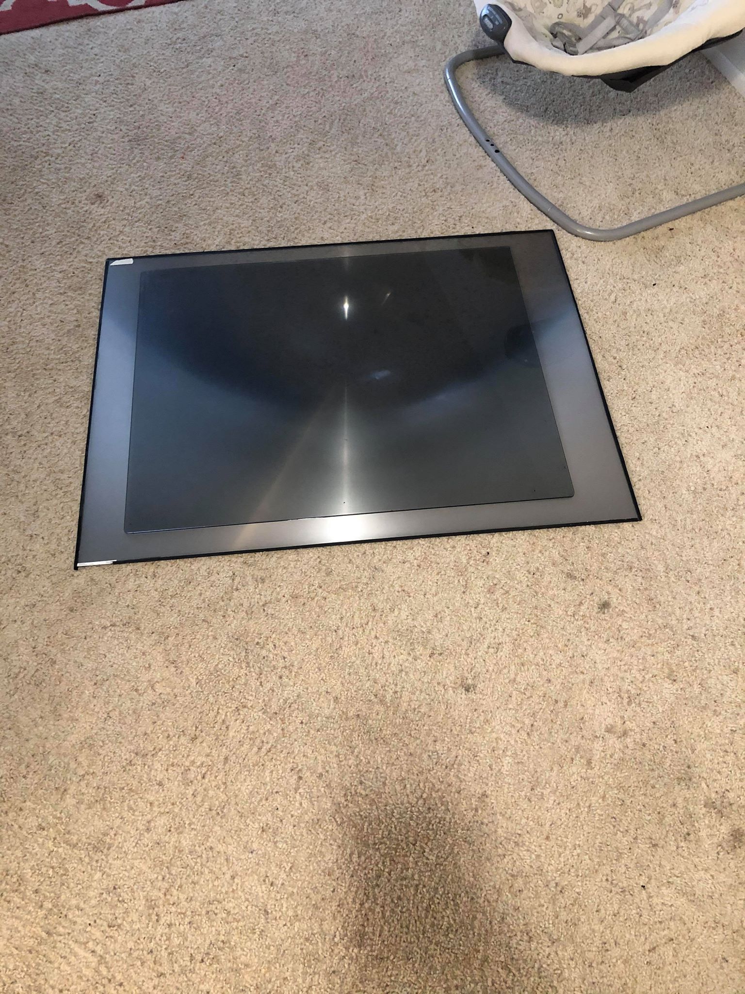

so you did not use the fresnel lens. Which part of that projection tv you use then???? I’m perplexed
The screen itself, which is a separate sheet and the lens is behind it. They were taped together, so I split em, cut it down and installed it. I gotta see if it works out when the projector is installed. Mirror first though. I got my jamma harness today to.
why are you not using the fresnel lens. I thought that was the most important part?

To me that looks like a fresnel lens.
The fresnel is made for the projector that was installed in your Hitachi set.
Thinking either the original RGB projector or replacement will project at the same distance is in question.
I’m looking forward to your outcome.
yes it is a fresnel lens, I'm trying to cut it and make it fit. what should I use for the cut?

what does it looks like now? After the cut and not real adjustment ???
I am not using my fresnel lens at all if I don't need it, so I'm not cutting mine unless I have no choice.

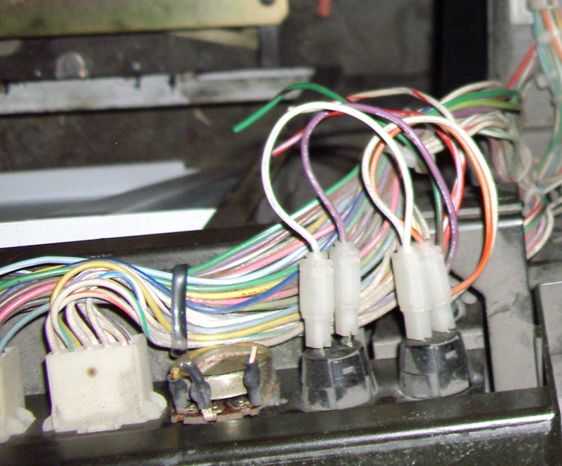

Can anyone with a working volume knob tell me where it traces to? In other good news, both my speakers work.
do you have the original psu, I think there is an AMP inside and one part is leballed speaker maybe it goes there.
I would use a straight edge, Marker and a skill saw. Than sand your edges with a fine grit Sandpaper.
it looks like you have 3/4" around the frame for give so it should be easy.
I don't know if a fresnal for your replacment projector is a good idea though. I would us RPF and keep it simple.
I used fresnals in the past to magnify screen in DIY projection and your replacement projector doesn't need help with the throw and may hinder your ability to tune it.

I'll see if I can figure out where that volume pot goes today.
