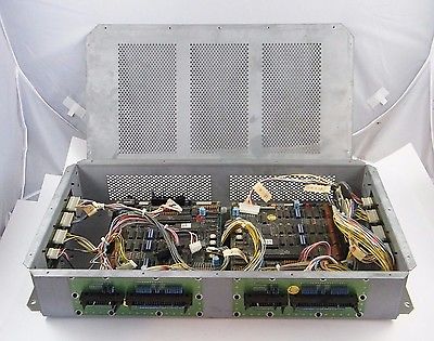

also I have plenty model 2/3 Jamma things here but what I am trying to say is there is no loom made for model 2 Daytona or model 1 Virtua racing since these games won’t boot outside the cage without an I/o if you power them you get a blue screen
Ahh I see what you mean. Then you need those parts + loom.
there is no "io board" for model 1 2 or 3, the term you're looking for is "filter board"
and honestly there's no active components on it literally it's just a pass-through with some passive filtering components. I'd suspect if you're getting a blue screen there is some other issue at play, either you're not hooking things up correctly or there is another issue with your PCB set.

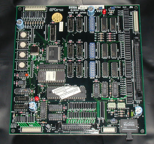

@twistedsymphony don t know where you get your info from, but Sega model 1 Virtua racing and Sega model 2 deff have a I/O board it’s this board! I know my left from right and a filter board is something else. And yes Daytona and Virtua racing give a blue screen if they don’t have a line to the comm I/o boards
Sega model 2a,b,c and model 3 is a different story those filterboards in most games is straight pinout from the filter with no I/o since the filterboard is the i/o

AMS - You do realize that without an I/O Board you won't get any Analog or Digital controls, so you won't be able to control the game.
It should just be 4 wires from the main board to the I/O along with 5V power and and to the I/O
Correct , as we try to make these games Jamma loom ready and make a loom for the analog controls
we need to have the game boot. From what I can see there are 5 wires that go to cn4 on the i/o to the filter but still can t get the games to boot so or my I/o is not working good or I connected it wrong
that’s why I need some help
As Twistedsymphony says, the filter board is really just a straight through connection - I just normally wire directly to the 32 pin connector
Most of the red wires are 5v (the ones on the left and right of the connector)
The black wires are all GND
The white and red in the middle wires are TX +- and RX +- that connect to CN4 on the I/O board - The black wire on CN4 is GND
Then you need to connect 5V (Red) and GND (Black) to this connector
Once you've connected those correctly then it should boot without the blue screen - I/Os are cheap but I've never had a bad one.

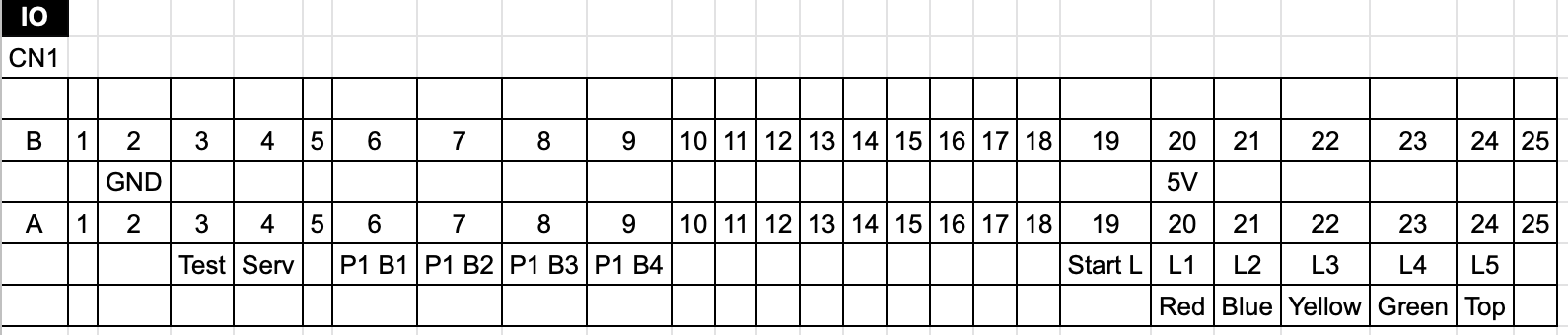

@Arcade game & I only wired up the digital buttons and the lamps to the 50 pin connector (CN1) on the I/O
GND, 5V, Test & Service are consistent across all Model 1 the others move around mysteriously
I think the analog inputs are just 0-5V and connect to other pins on the I/O, which should cover you for steering, brake & accelerator.
I've no idea how force feedback works and I think I've read that it's pretty dramatically different between Sega hardware generations.
All of it should be in the wiring diagram in the manual.
Good luck!
Mark
