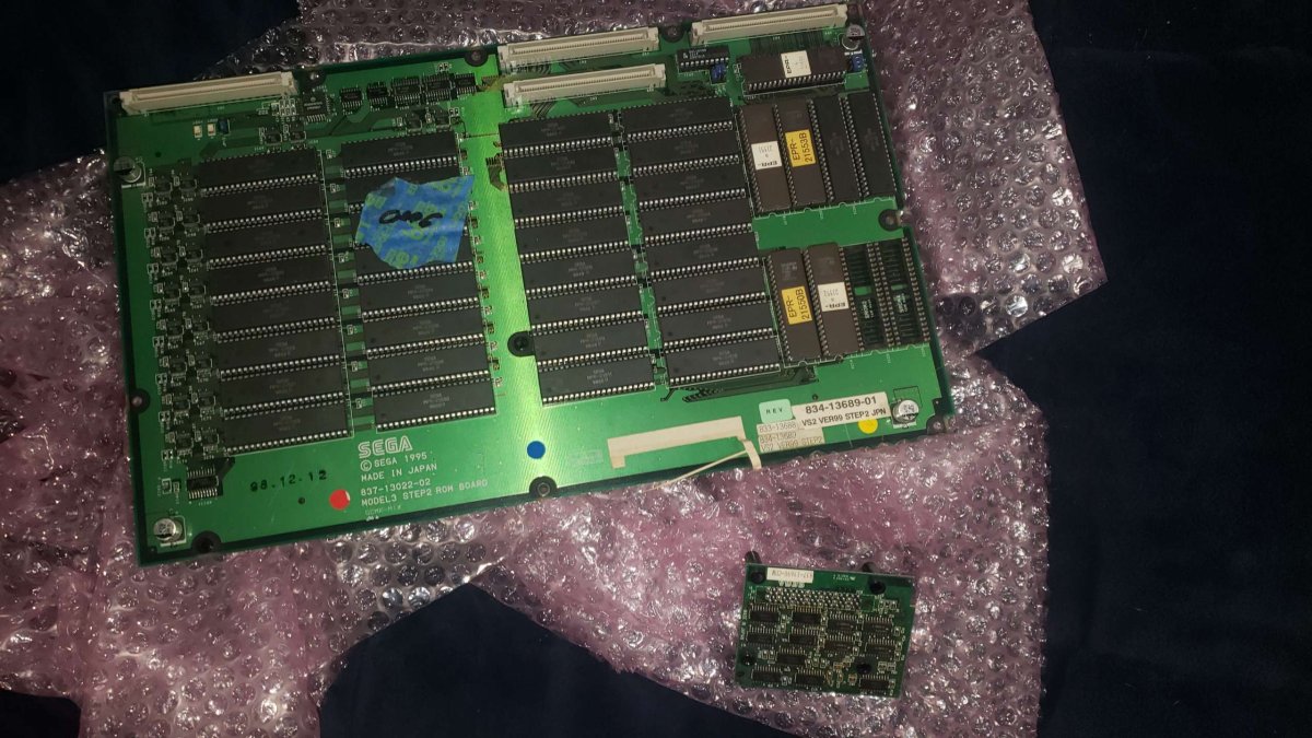

One of my best friends in Australia bought me a Model 3 Step 2 ROM Board as a Christmas gift, which was originally Virtua Striker 2 Ver. '99. I plan to set this up as possibly Sega Rally 2, Emergency Call Ambulance, or Dirt Devils (if I can find a security chip for the latter two games). Do any of these require any 64MB ROM chips to burn? I heard a few Step 2.1 games like SpikeOut do. A fellow here did an FV2 conversion with Andy Geezer's decrypted ROMs and didn't need a 64MB chip.

The mame driver will tell you the rom sizes, but you'll need to download them anyway so you could just look at the files on disk too. When you see a rom load entry the first set of numbers is the offset and the second is the size:
e.g. ROM_LOAD64_WORD_SWAP( "mpr-20602.1", 0x800006, 0x400000, CRC(60cfa72a) SHA1(2cb9e16d50979461d39e0493273ee38d23900b45) )
0x400000 is the size = 4096kb = 32mbits.
None of those have 0x800000 = 64mbit that i noticed.
Very helpful information. Looking at the driver, it seems the only games that use 64MB chips are Ocean Hunter, the BOTE version of Daytona 2, and both Spikeout games.
27C160 and 27C322 are likely all I need, judging from ROM sizes.
Seems like Daytona 2 PE (with nem's decrypted ROMs), SR2, Harley, and Ski Champ would be the easiest Step 2 games to convert to this without a security chip.
Andy Geezer told me the Emergency Call Ambulance prototype didn't use one but unfortunately it doesn't boot in Supermodel so IDK what the differences are to the final game. Would love to know, however.
