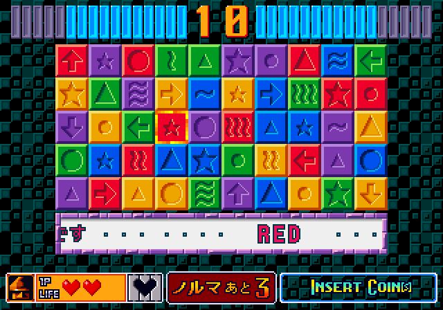

Sorry for resurrecting this thread. I have searched inside the code of Tant-R, and it seems all the japanese messages are drawn within pixel images. They aren't ASCII code printed messages. The only thing I wanted to do was to translate the tips on the minigame "Three-Hint Panel Pick", which is famous for ending your game if you don't know japanese. Anyone has any idea of how the graphics of this game can be edited?
I'm going to attempt this. No promises on the time frame. Took me two hours just to change the graphics for red...
Also, now thinking about it, I made a font that is too large for some of the space that is allotted. Oops.
I'll probably just start over.
Oh my god. That's exactly what I meant. Only translating that mini game is worth the effort. Can I help you in something? I don't know how to access to graphics data, but I'm right kick in with your test.
