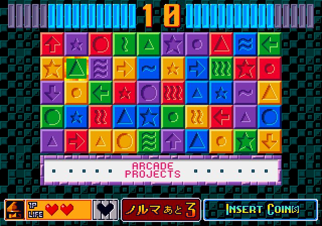

It quickly dawned on me that there's no way to fit some of the hints on one line (like 下向きです, "it's facing down"). So I made a smaller font so I can have two lines of text. Here's a mock up of what it's going to look like:
Fortunately, I don't think there's a hint that only contains a single kanji? That would be a problem because you can fit a kanji in just four tiles (16x16 px), but try doing that with English text. Also, there's a lot of redundancy, so I don't believe any of the hint texts are a combination of two different graphics.

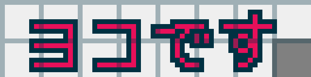

I finished a version of it. I'm not 100% happy with it. There was two problematic words. Two tiles are copied and mirrored in the middle of the graphics. It's funny because there's so much redundancy and then they save a minimal amount of space by doing this.

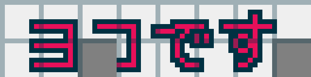

ヨコです ("it's horizontal")
Here's the graphic for it with an overlay showing the individual tiles.
It's 15 tiles. 8 tiles on the top row, 7 on the bottom. That's pretty good. Plenty of space, right?
So you would think!
Surprise, bottom row third tile from the left is actually copied from the tile above it. Very clever Sega, you saved 32 bytes by doing that.

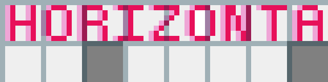

That means you have only have 2 + 5 tiles on the top row and 2 + 4 on the bottom, because you can't really use the tile on the top row either unless you want to copy it to the bottom as well.
And then when you start to think about it more, horizontal is ten letters long. It's a long word. Since I'm using a fixed width font (every letter is the same width), I can't even fit horizontal in to the top row, copy or no copy.

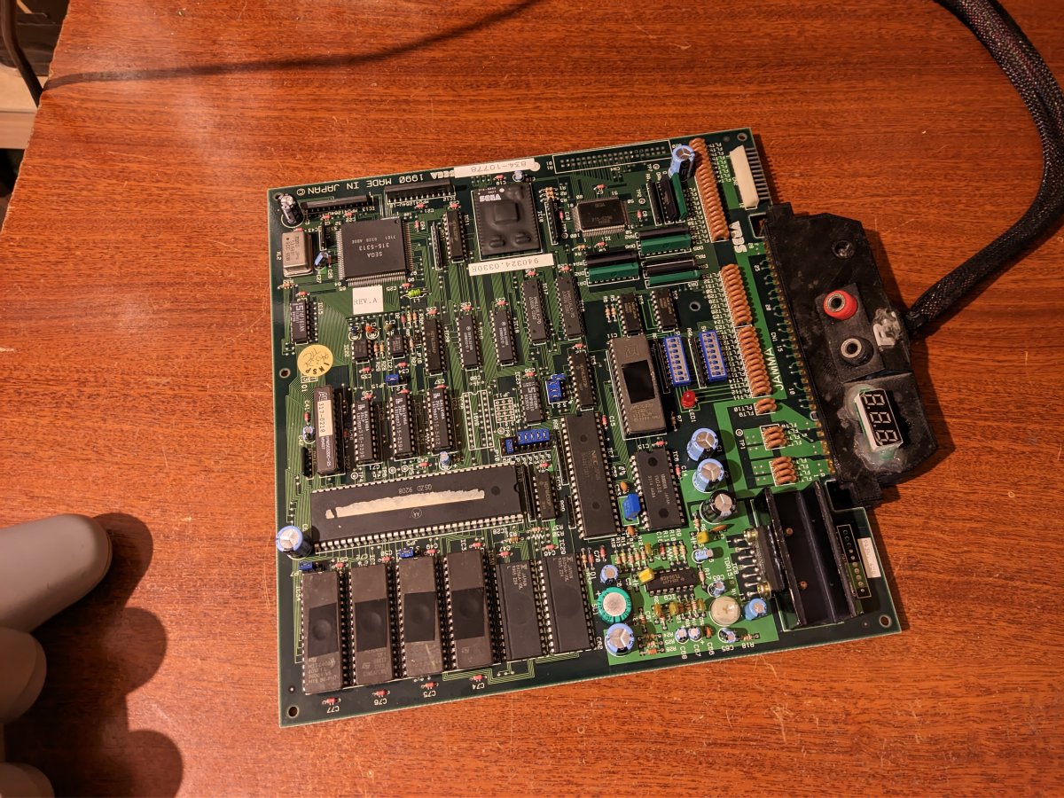

Sorry to bump thread, novice question but I came across a Puyo Puyo Tsu board with reburned eproms.
Believe these eproms aren't decrypted as unable to send garbage to the other player - which type of eprom would I need to write these decrypted files to?
Do you have a picture of the PCB ?
Assuming it is a conversion or for whatever reasons those three eeproms had to be swapped out but are not the decrypted ones - just not sure what type of one i could order to program the patches files onto.
