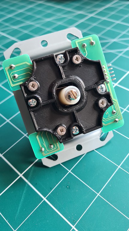

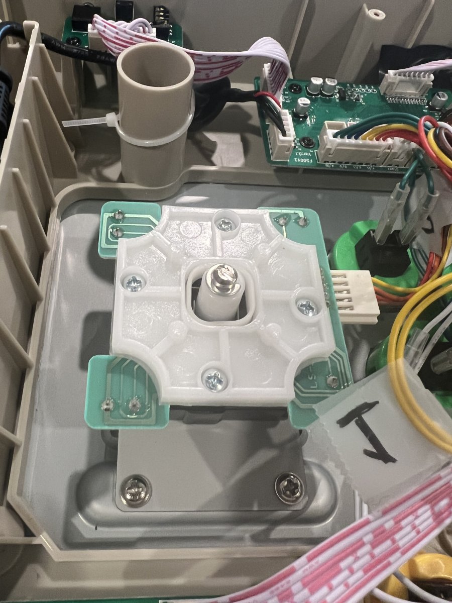

Got mine fitted snug on my LS-56 in my Mayflash F500 (my workhorse stick) and it works really well. I fired up some Mushi for some micro dodging tests and it’s awesome. @PASTBLASTER also earned a spot on my stick for hooking it up.

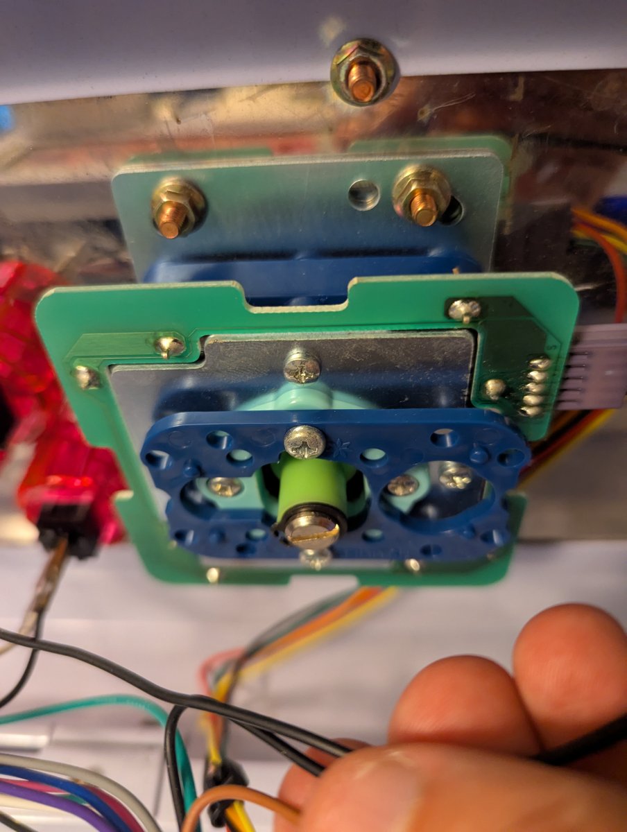

Hacked up this Kowal plate to let me use the LS-56 branded Omron switch board from the Dreamcast Virtual On sticks. Weird combo, the switches are reversed in orientation for no discernable reason. The plate effectively changes the actuation but the real purpose here was in order to prevent trimming the microswitch stopper tabs..

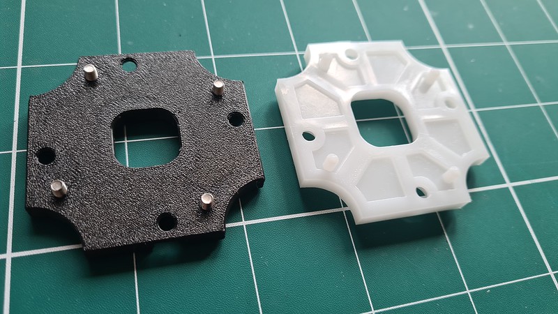

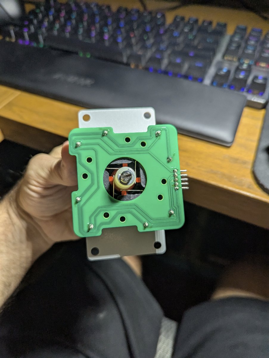

I made a set of these for @wonderbanana a while back he sent me a picture showing that the center part of the reducer had cracked in half and also delaminated/fallen off the rest of the restrictor
I thought this was pretty bizarre and a one off but I looked in my CP recently and one of mine had delaminated too
I still can't really see how this is happening as there are not really any unsupported forces to flex that part of the reducer. Fact of the matter is it's happened twice though so it needed sorting. The originals were printed in PLA and I've since printed some replacements using PETG in the hope that the layers fuse together a little better.
I thought that had solved it until I opened my CP earlier and found that one of these has failed also :cursing:

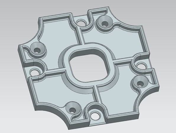

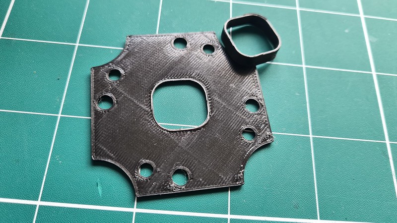

I thought I would sort it for good this time. I have re-modelled the complete restrictor and reduced the gate by 1mm. This makes it perform the same as the previous version but it is now one solid piece.
The original restrictor has 3mm location spigots on the underside. I've modelled 2.7mm holes for M3x8mm CSK screws which perform the same job.
I've added this as a remix of my original design and can be downloaded from Printables.com [here].

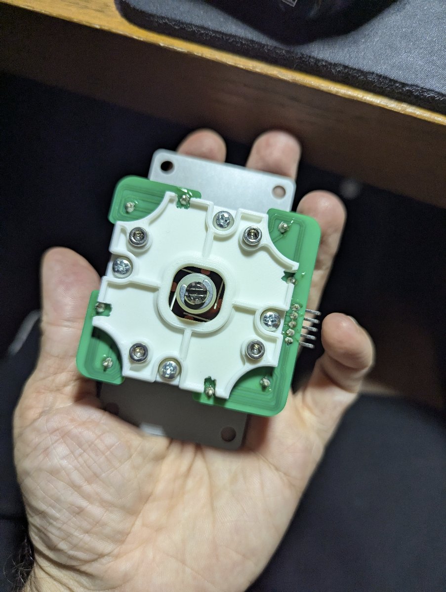

printed and tested! great for micro dodging although you'll have a sense of the ship going "slower" since it can not achieve long distances quick.
