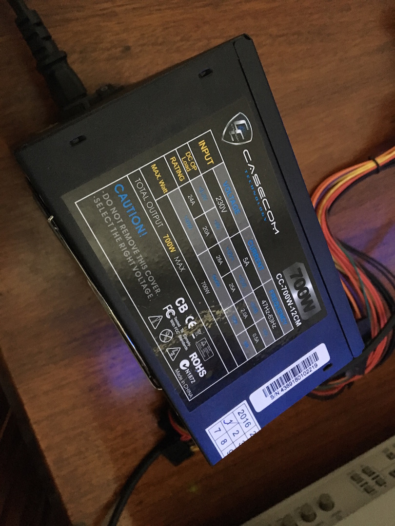

keep in mind i was using a 350w atx PSU so i assume it either was too much or too little power averaging around 5.08 on the voltage meter..

Don't be too concerned about the voltmeter readings. ATX PSUs are quite well regulated and will always read slightly higher than 5V, by the time the power gets to the arcade board the voltage will be spot on. You can confirm this by measuring the 5V rails of the arcade pcb with a Multimeter.

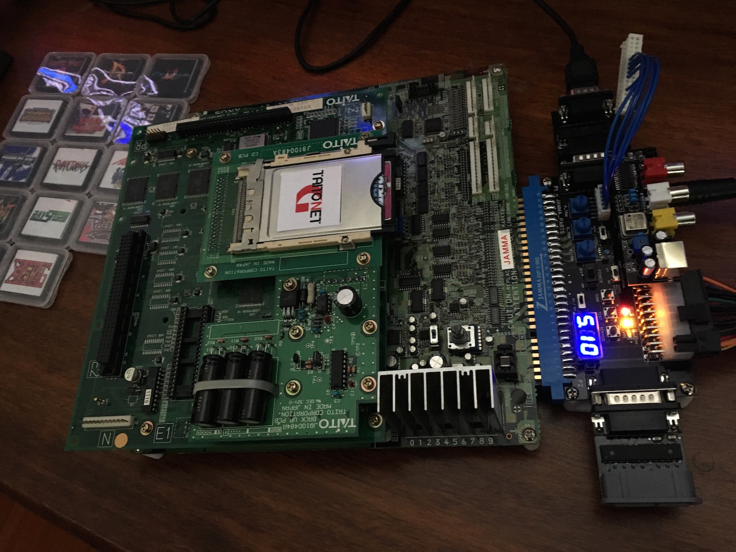

well I really want to get my taito G net and system 16 working on the supergun.. what would you advise on getting those working??? if i get those working it's a mission complete
just to be clear... when i boot up the G net or the system 16 the supergun and PSU just shut themselves down.. as if to put themselves into safe mode..

Sounds like either a short, which is activating the ATX protection and shutting down, or perhaps it's pulling more power than your particular ATX can handle.

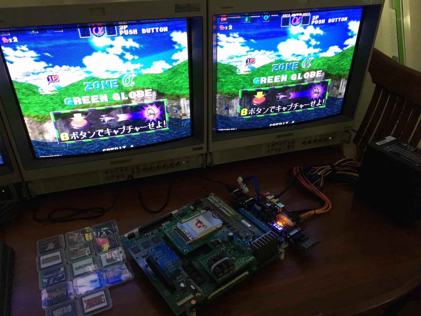

Hey @beast1x5, about to check out the live stream. System 16B works fine here, I have a cheap Chinese adapter at the moment and am just waiting for a deluxe JNX one from @XianXi -- the one you linked on eBay looks just fine though.
Just bootled/re-checked my G-Net Multi and it works fine (flashed a few games with no issues). I'm using a Casecom 700W ATX Power Supply, which is a bit of an overkill and reads slightly high, but tackles all fat PCB stacks with no issues.

  • Thanks @djsheep I was using a random branded 350w atx PSU.. not sure on the brand.. I just hope its a simple fix... I'll sleep on it and get to work again after my Yakuza kiwami 2 stream

I'm sure @Frank_fjs will figure out your issues with System 16 & G-Net, but if I could take a guess it would be the PSU.

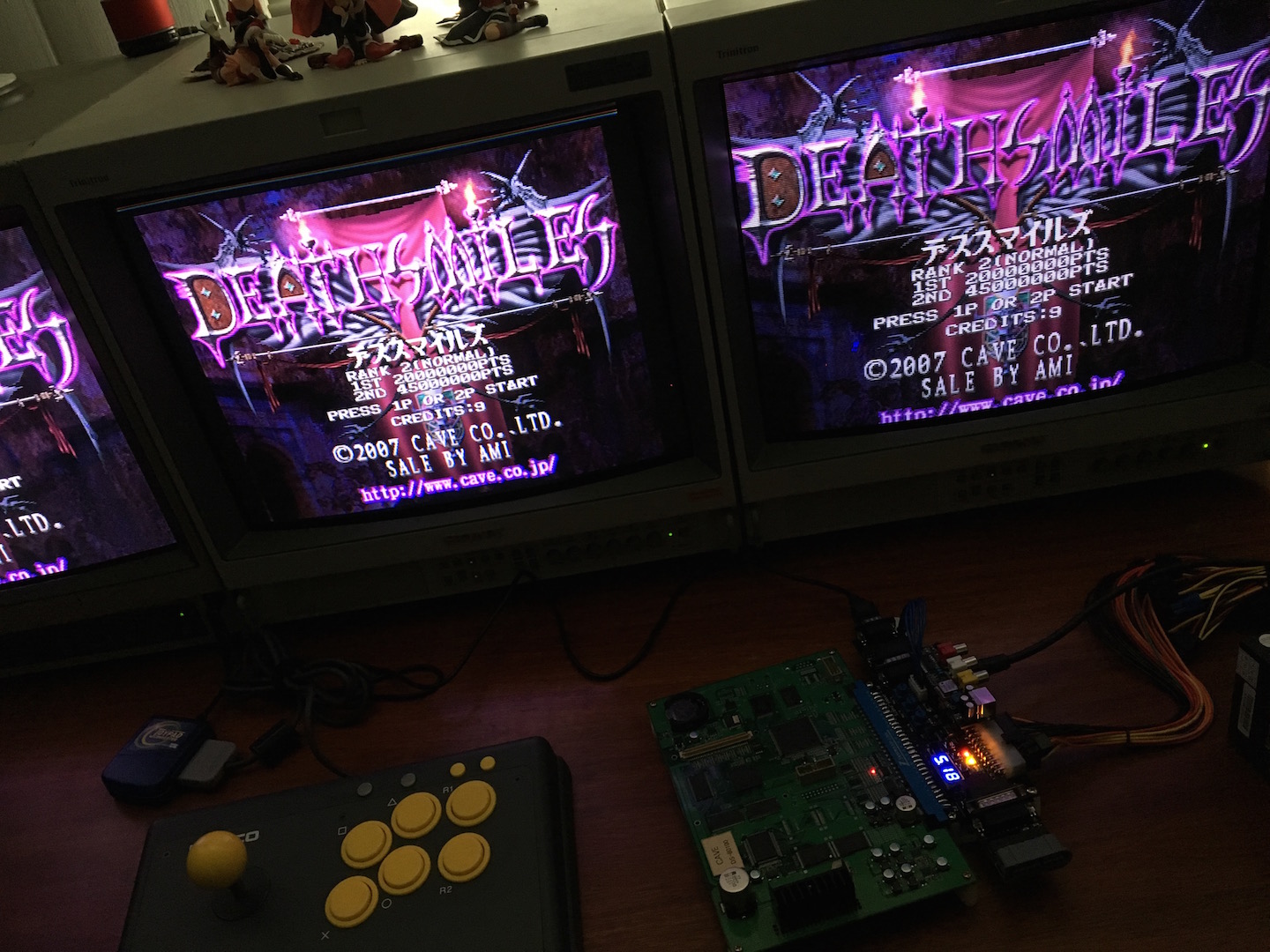

All generation Cave games work really well and look fantastic too.
