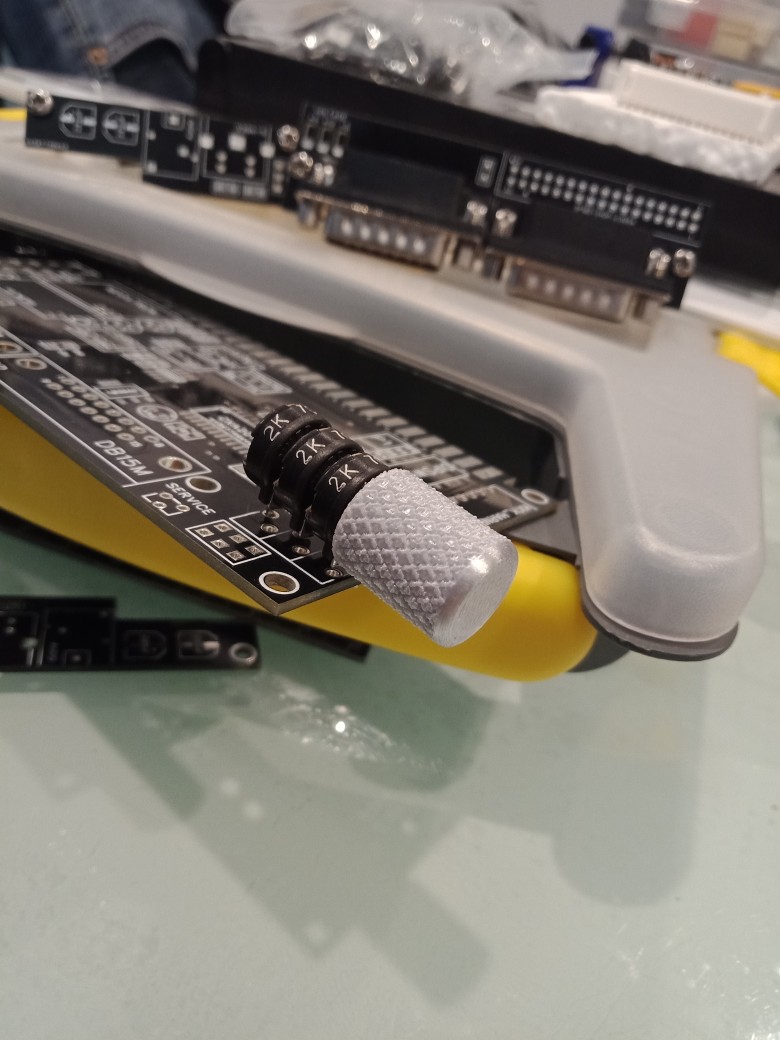

Does anyone know where to source a potentiometer shaft to suit Piher PT10's? The part I'm looking for is a 6064 / 6064NE.
As pictured above.
Just saves me having to 3D print my own.
