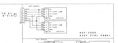

@twistedsymphony, quick question for you on your setup, I am using the HOTD4 wiring diagram to build my control panel. I notice there are 4 pins going to a 509-8101 board.
I am figuring that just grounding PIN3 (START) activates the start button.
Is the 5V source used to power the Start Lamp? Just curious how you have your Start/TEST/SERVICE situated on your setup.
