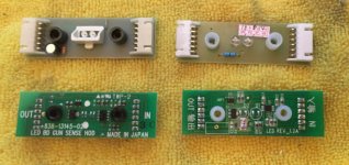

I am also using a set of 10x 838-13145-02 SEGA IR boards. I have a set of chinese knockoff IR boards that I will set up and compare the differences. I'm hoping there are no technical differences but there are some physical differences:
And also, if the LENS is a big factor:

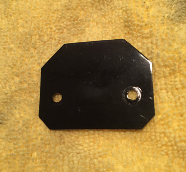

I taped over the ends where the corner brackets would be installed, I didn't want paint making it even more difficult to get the end pieces on. Then I sanded with a 220 grit and wiped down an alcohol on a rag to remove any dust before painting. I use an old keyboard stand as a paint rack and have some old metal hangers bent into hooks so I can hang smaller parts. For paint I used a satin black with a nice spray nozzle attachment. I use this all the time because the nozzle helps give a nice even coat and I'm crap with paint so I can use all the help I can get.
