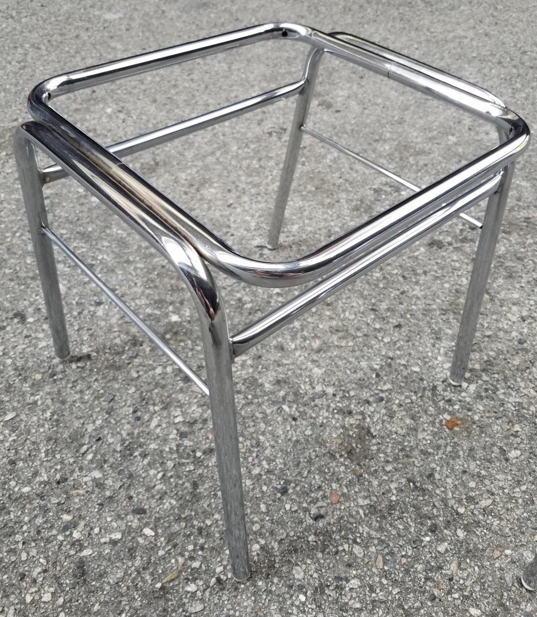

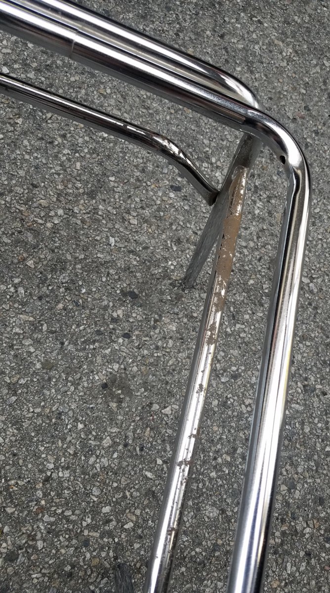

The first step was evaluating the condition of the stools. Both had some significant dirt and rust buildup on the legs. On both the foam is highly compressed and not very supportive. The gray stool has faded and worn cushion fabric, but no major stains or tears. The blue one has less wear on the cushion, but a large gash in the side of the fabric and cushion foam. It has some much worse rust spots; so far I haven't been able to clear them up completely. It also has a mangled 'baseboard' - the wooden board that supports the cushion is cracked and starting to disintegrate around the screw points.
Initial disassembly is pretty straightforward - four screws on the bottom to remove some retaining pins, and then the entire cushion can be removed.

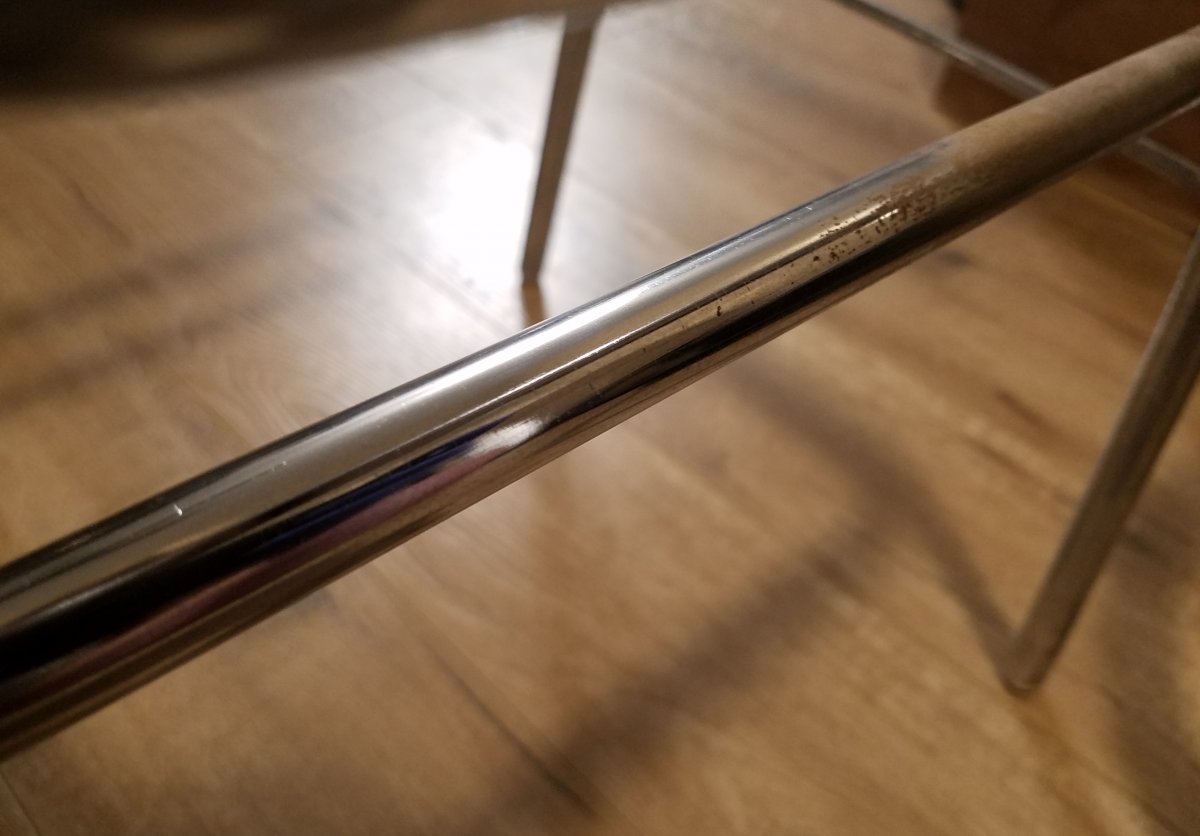

To prepare for the cleaning, I grabbed some ultra fine 0000 steel wool, and a chrome polish/rubbing compound. Before getting serious with cleaning, I took a quick pass with the steel wool to check if it would work for rust removal. The answer - yes, it works great! As long as it's real plated metal, steel wool can pull off the rust and clean up the surface very quickly.
Cleaning the Legs
This took an afternoon. Just went out to the parking garage, put on a mask, pulled out the steel wool and nevr-dull, and went to town. I always started working on hidden areas when in doubt, before moving outwards to the more visible spots. I didn't run into any serious issues during the process, though cleaning out some of the deep crevices between the welded tubes was basically impossible to do by hand. And some of the rust spots were too serious on the blue stool for me to handle with just my hands; I've since bought a wire wheel and I'm excited to try that on these areas soon.

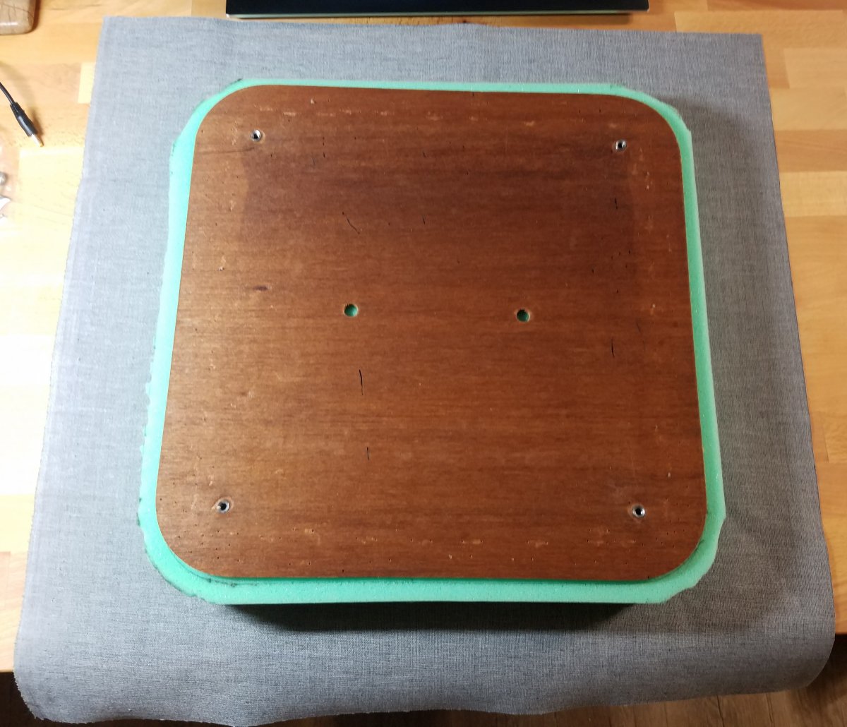

I also picked up some high-density upholstery foam; I found a 2-pack of 15x17x2 inch sheets that worked perfectly. And while I was there I grabbed some black upholstery dustcover fabric to neaten up the underside of the seat.
Once I got everything home, the next step was tracing out the shape of the seat onto the foam and cutting it into shape. I rounded the corners, but I didn't do any beveling of the upper edges (in other words, I only made cuts in two dimensions, following the outline of the baseboard). I chose to extend the foam 1/2" past the edge of the baseboard, to give it a bit more compression and 'lift' once everything was stapled into place. Cutting the foam is a bit tricky; I found that a combination of a sharp hobby knife for fine shaping and a bread knife for quickly cutting down to size was an effective process.
I unfortunately don't have any photos of the actual process of stretching and stapling the fabric. Suffice to say it's not terribly complicated - you alternate stretching fabric and stapling it in place, working on opposing sides to distribute tension evenly. I knew that with this shape and material it would be almost impossible to avoid wrinkles, so I chose to try to make the corners smooth and spread the wrinkles across the sides of the seat. I tried a few different approaches and in my opinion this was the best looking option. It took a bit of time (around an hour) to do, but for my first attempt at any sort of work like this I am quite pleased with the result.

I have recently found success with cleaning up chrome with aluminum foil. I haven't tried it on stools yet, but it worked on a vending rack I have.
These look great! I actually was expecting this thread to be about the cushions, but that's probably because I tackled a project like this myself recently. I think yours came out a bit cleaner than mine, I used a thicker foam, bit more like a Taito stool look, and my corners aren't as clean. I used a blue velvet, thinking maybe it also wasn't as stretchy as what you used, that might have helped too.
Balled up foil and coke works *really* well on chrome. My brother has a car restoration shop and use that method.
Ah yeah, I've heard of the foil and coke trick!
I wasn't sure if it was safe to use on the stools, but it makes sense that it would work.
I wonder if that will be enough to get through the thick rust spots I have on my other stool? Would be worth a shot at least. Next time I hit the grocery store I'll give it a go!
When I did it, I just used soap (simple green). I didn't try using coke. I'm not sure if it has a chemical in there that would benefit the process? I know having some kind of liquid there definitely helps the process by loosening up surface grit.
