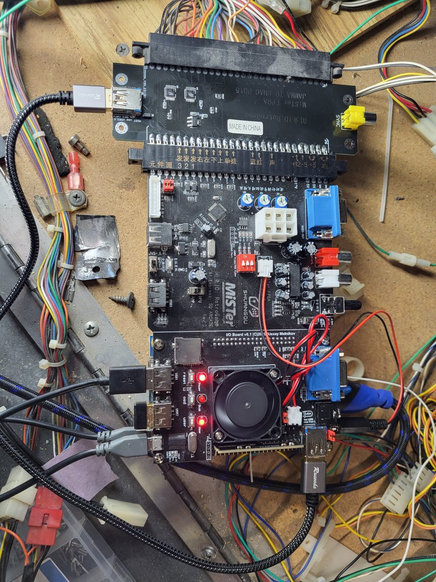

could I have some of the switches wrong on the board?

You have a little switch on this board
Next to the jvs usb port switch it to 2p
Then in the .ini Remove the semi colon from the no_merge pid & vid
That will resolve the issue I just did it to mine
no_merge_vid=0x045E
no_merge_pid=0x028E
这两句添加到MiSTer.ini
然后
压缩包里面的
config/inputs/*.map放到系统卡里面对应上面的这个目录

Hey I registered for an account because I bought this (well it was a Christmas gift, technically) as well as the DB15 SNAC adapter and couldn't get any of it to work aside from video. But, over the few days it took to get the account approved, I actually got it all sorted, mostly.
I'm using a MiSTer Pi (Taki Udon's DE-10 Nano clone) with 128MB RAM. I'm using a standard MiSTer Fusion setup (not using the Micro SD card that came with the JAMMA adapter). I'm not using the USB 3.0 cable, just plugging the a standard micro USB cable from the JAMMA adapter into one of the standard USB ports on the USB hub of the MiSTer Pi. The only changes I needed to make were flipping SW0 on the main MiSTer board (which made audio work) and uncommenting the no merge vid and pid that were mentioned in this thread. The controls work perfectly as USB (since I'm not using them as SNAC), so I probably don't even need the DB15 adapter plugged in, but one major benefit is the composite sync port which lets me use my GunCon 2 as a light gun (in any core).
