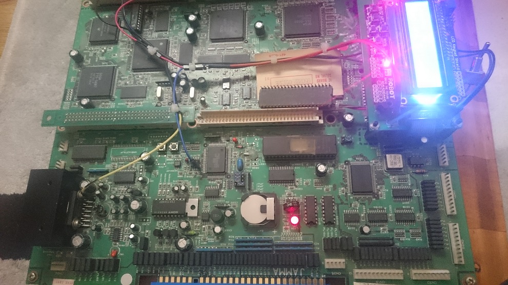

I did some testing yesterday using jamma adapter to power the selector and relay to reset st-v board so I could build nice jamma adapters for those not wanting to solder anything. As I suspected, there is a problem with voltage spikes when taking out 5V from line that is controlled by the relay. Relay module itself has diode and optocoupler but problem is more in the psus that has momentarily unstable 5V when relay disconnects the line from ST-V (and reconnects), reseting the arduino. Using external psu for selector would work, but I want to make simple solution without it. Using 12V line and regulator to power selector might be good option that will work well with most of the PSUs.
And hey, if you have already installed the selector, post some pics!

I did something during weekend and today. This is jamma adapter that has 5V line going through relay module that is controlled using the AUX pin of the selector. I first had problem that 5V voltage on jamma edge fluctuates when switched on and this reseted the selector. It is the cheap PSU and all the caps on the board that causes that to happen. So I just took the power for the selector and the relay from 12V line using 7805 regulator turning it to stable 5V. Seems to work fine now, at least with my psu and board.
I'm not yet sure where to go from here, should I draw the whole JAMMA adapter and add all the components there (the nice solution) or just use the finger boards (messy solution). Anyway, I'll probably make prototype by hand and send it to someone brave enough to have longer test with it :)
