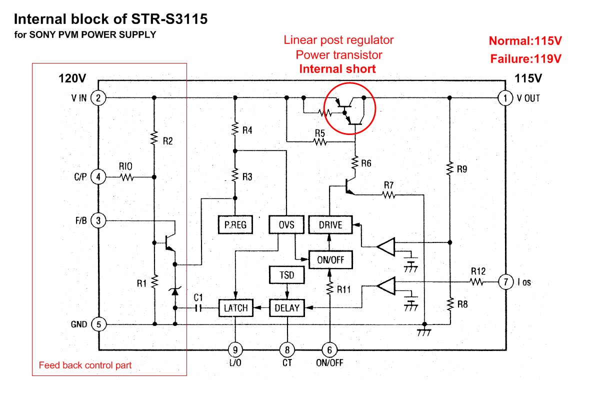

I'm looking for the datasheet for STR-S3115 used in many Sony PVMs.
Also if someone could sell me a couple of those that would be much helpful! (Found a few places online where they sell for $20/pc + $15 shipping + $30 tax on arrival, a bit steep for a single part).
Thanks.

I managed to find only the internal block of the STR-S3115, I don't know if it can be useful to you though.

Thanks @caius.
I was looking for the datasheet to see if it could be replaced by something else.
I don't trust aliexpress either and the ebay links are pulled parts and from the US.
Doesn't leave much choice... :|

I'm wondering if the repair is worth it after all, Q501 is also shot on the A board, Q502 should be preventively replaced, so as IC602 on the Q board.
