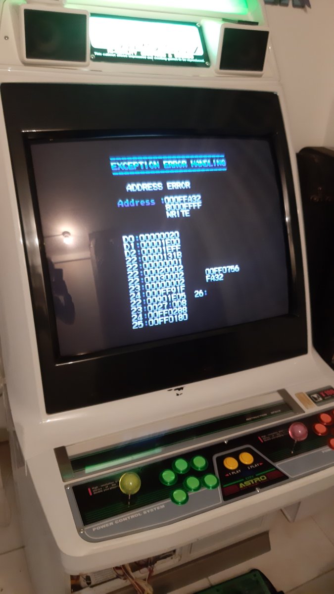

I have a street fighter zero 2 (phoenix) with this issue :

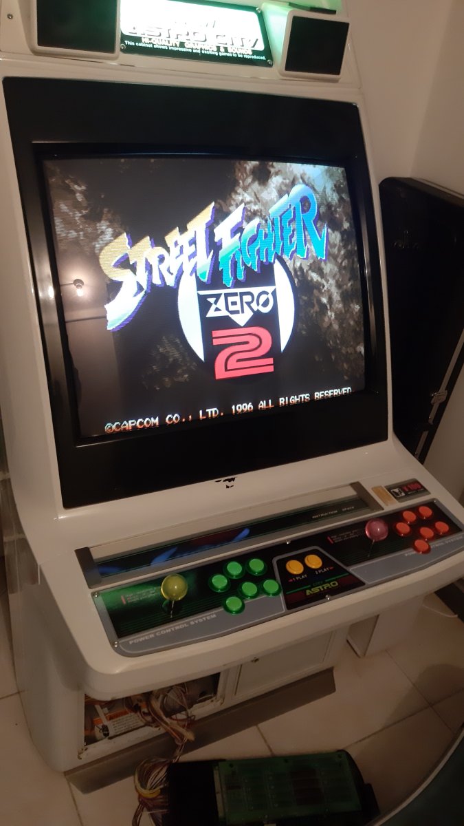

- first, the game works
- after a few minutes, i get this :
I found, with the game unplugged, a residual voltage on CC1, EXC5 and D5. If i short one of these capacitors, the game works again a few minutes and then i get the same adress error. I removed EXC5 and CC1, the residual voltage keeps coming.

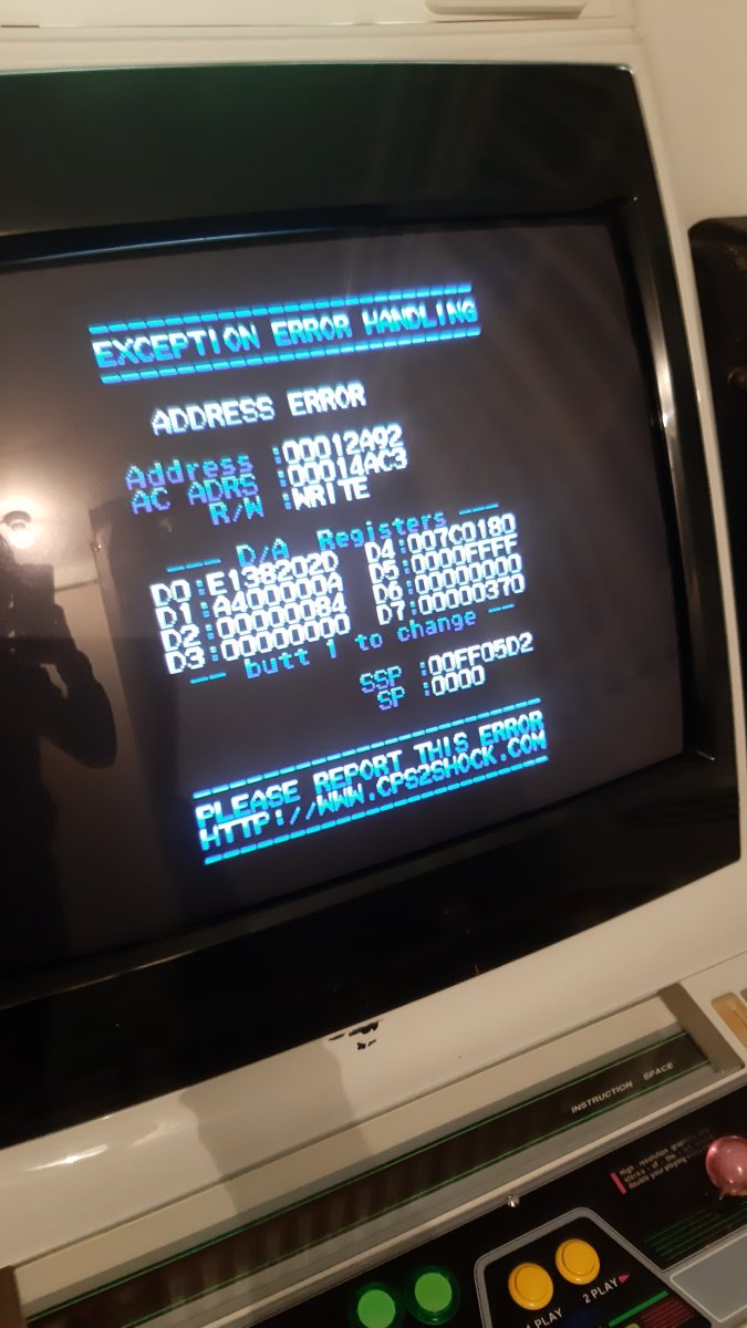

If i try to boot again without discharging the capacitors points, i get other errors like this :
Or simply a black screen.
