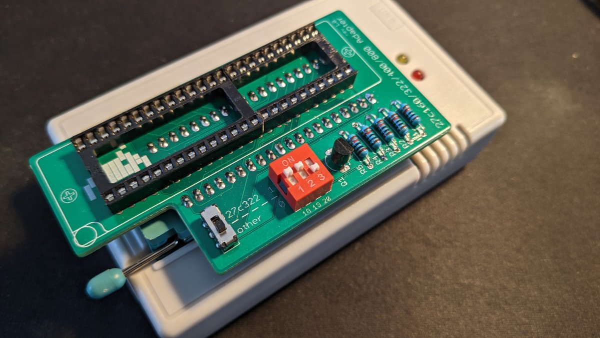

I stacked the ROM set and expanded the filesize to be able to split it into 4 x 512kb chunks to burn sequentially via my TL866ii plus programmer and adapter board.
I tried several times to burn the to the four banks as per the instructions for the adapter only for it to keep failing on writing to bank 2.
This really confused me, was it the adapter, the programmer or the eprom?

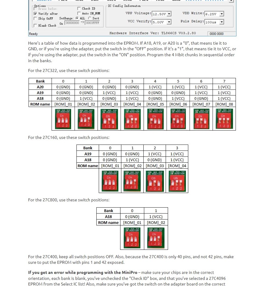

I was copying the dip switch settings visually as per the adapter instructions until I noticed that the address numbers and the dip switch illustrated didn't match the adapter board and the numbers are in fact reversed on the instruction sheet???
This board seems to be from PCBWay and is sold widely on auction sites etc.
Only after I set the dip switches to actually match the address numbers on the adapter did it burn all banks of the 27c160.

Compare the photo of the adapter with the supplied instructions, clearly an error here.
Yeah, those instructions look completely wrong to me. I have a similar adapter and I start with all dips set on, burn first file, turn A18 off, burn second file, turn A18 back on and turn A19 off, etc. So with the adapter facing you like in your photo it should be:
111
011
101
001
110
010
100
000
1 = ON, 0 = OFF
Do all 8 steps for a 27C322, first 4 for a 27C160, first 2 for a 27C800
111
011
101
001
110
010
100
000
1 = ON, 0 = OFF
Thanks for confirming that I'm not going mad and for posting the correct dip settings. It easy to work out when you know but if you just blindly follow the dip switch images then it's not going to work.
Not good that these instructions are referenced for these commonly sold boards.
