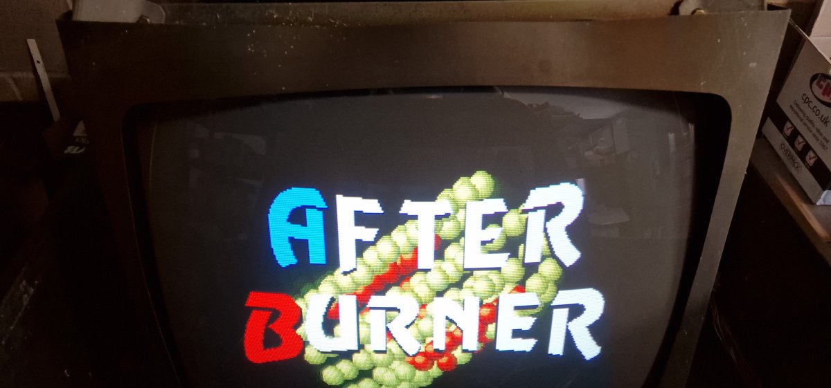

OK, Afterburner Arrived :) I forgot about import duty :( The game booted up with minor screen glitches on the text......

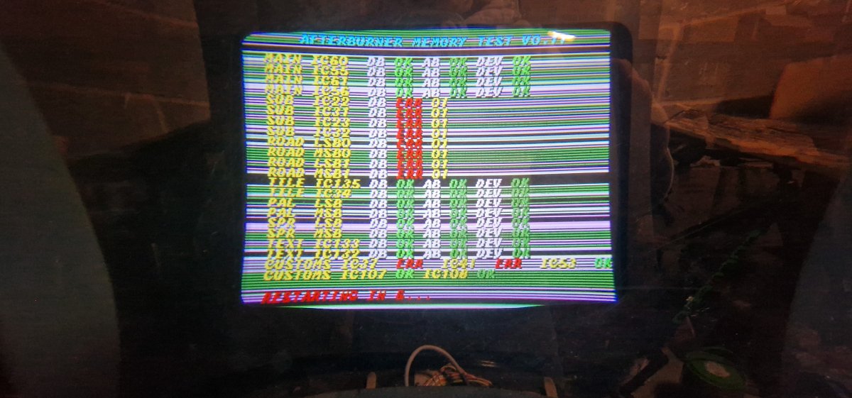

I inserted the test ROM's & got this : -
Not those RAMs AGAIN!! I've socketed them all, swapped them for all new chips & get the same result, even swapped the RAM out of IC22 to one of the others doesn't change the test so it can't be the RAM, so what CAN it be?

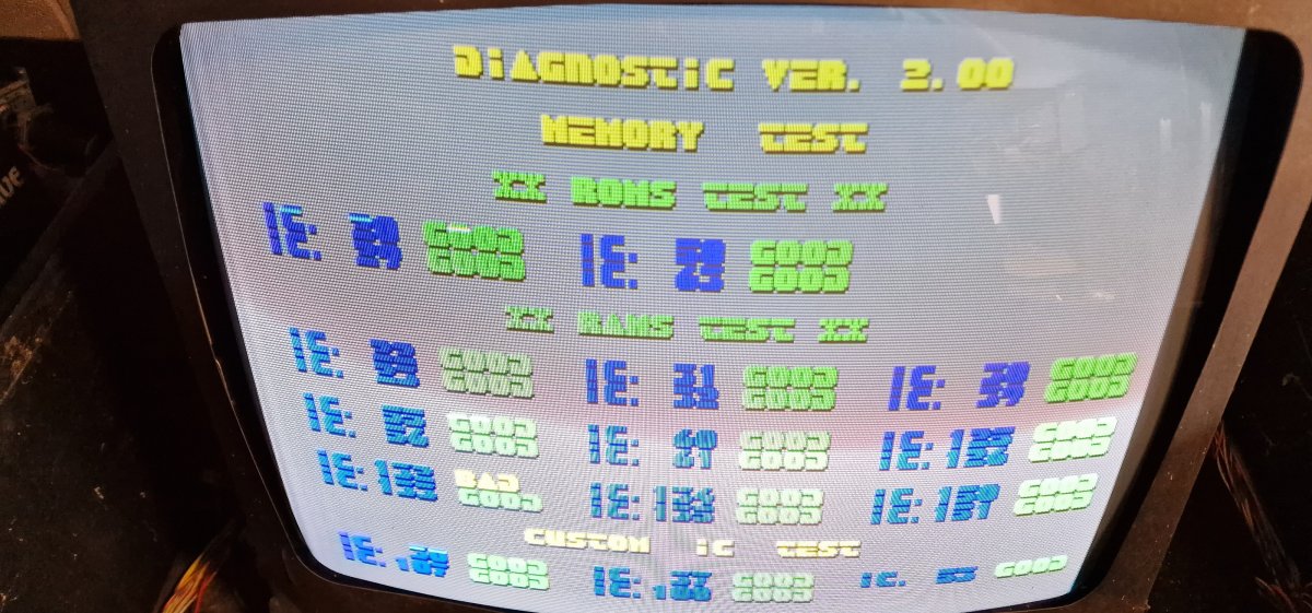

IC133 is also reporting an error, I'll get sockets for that later, at the moment I just want to clear this RAM error!! The games own self test reports the same for IC133 : -

I think I'll replace that RAM and see what happens. I don't even know what the fail is on the others? What's AB?! And dev??!!

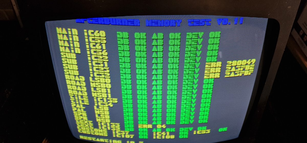

Ok. Some more progress. RAM was fine, it was IC36 causing the issue. IC133 is still reporting bad even though it's been swapped for a known good chip. Another logic chip failure...but which one?! Original board is still giving grief. I've swapped all of the RAM and logic chips in that area but no change. Whats interesting is the new board reported custom ICs as bad when more than one of the logic ICs was also bad.
No errors, at last! Found a single line on IC132 (even though IC133 was reported as bad!) was dead to the LS chip.....
