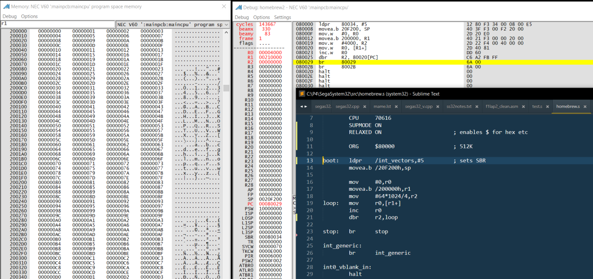

A small status update for you all!
Since I've got an assembler from elsewhere I saved a lot of time so I've basically done step 1-5 done now! I just got hack-rom working running some simple code!
Now I need to do a little more setup code - ex interrupts etc. I've looked at a couple of games and they seem to do more or less the same thing, so I'm gonna copy that. When that is done I will try to get something on screen.
Here is an action-shot from the MAME debugger :) I just fill the main RAM with an increasing value..
