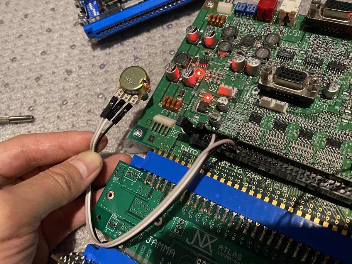

Is there anyway to activate the analog functions on the TAITO JAMMA FAST I/O?
Pin 13 is +5V (AD), pin 14 is GND (AD) and pin 5 ADC0 aren’t doing anything on my IO.
I spoke with @nem and he thinks the analog side needs to be switched on somehow.
There are dipswitches on this board but I haven’t found any schematics or manuals about this io other than the pinouts.
Anyone can confirm if the K91X1204B can support analog inputs via it’s 60 pin? And if so, how? Thanks in advance.

I'm beginning to think the pins aren't connected to anything and this IO doesn't offer analog functionality.

Got an email back from TAITO stating there is no analog support on this IO. (no volume controls)
