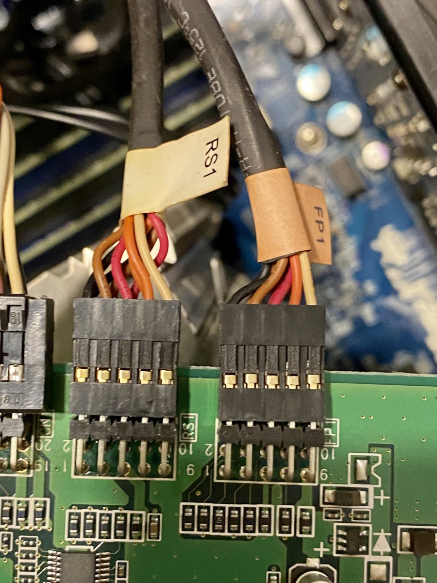

If you disassemble your machine, make sure you reconnect these RS1 and FP1 cables correctly on both the motherboard and Fast I/O side. If you don’t, the system won’t power on and you’ll waste time chasing non-existent PSU issues.
Ask me how I know…

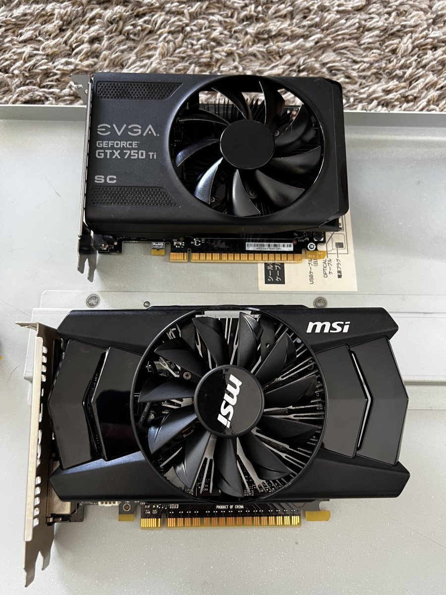

Can anyone help me identify this video card? Came in my Theaterhythm and I believe it has died. :(
It will have to be a non UEFI video card, so most of those cards won't work.

So I pulled the factory 640 video card and the memory, cleaned the contacts with isopropyl and the slots. Still won’t boot off the card but will boot off the main board video. Video struggles but that’s normal. I pulled the card and out it in one of my desktop PC’s. When it boots, the fan spins for 2 seconds and then nothing but I do get into windows and video is fine. When the fans go on these cards, does the Taito board shut down the card slot like manufacturers like Dell do when a case fan goes out? Seems like the fans were terrible in these.
I have this available but not sure it would be supported. It appears to support UEFI.
