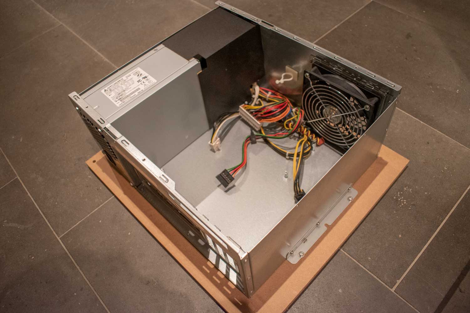

1. This is the case with all the guts removed.

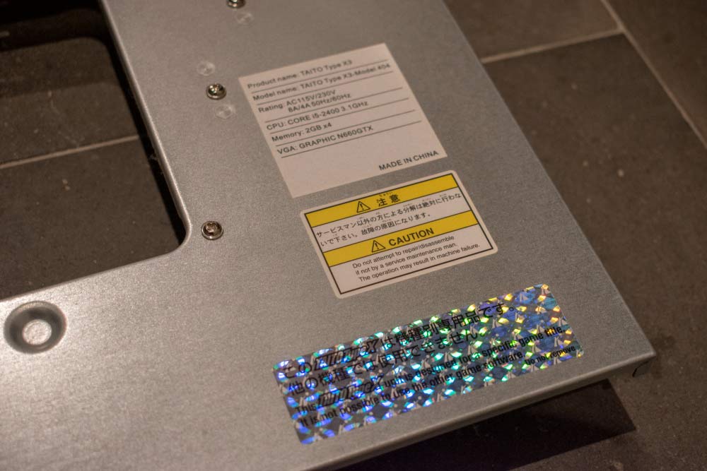

2. Specs info

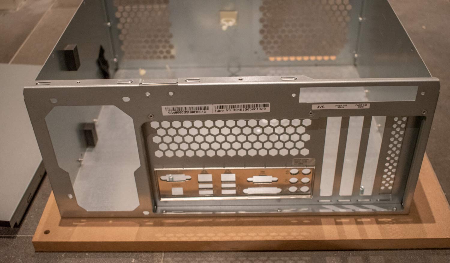

3. Back of the case

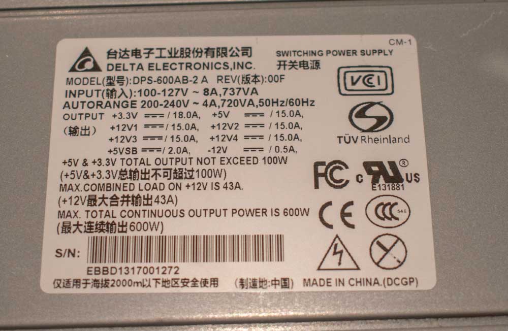

5. Specs of the power supply. 600w output!

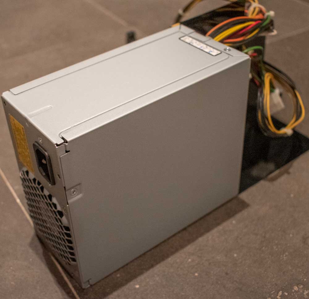

6. Here's the power supply next to an 850w Seasonic ATX power supply from my computer. You can see it's similar fit. BUT.. this is where you will run into problems, the air flows in one end and out the opposite end for the TTX3 PSU. This has vents at the back so the air can escape the case. If you use a PC power supply... there is going to be nowhere for the air to escape, it's going to be blowing into the case. You can wing this is you blow the air into the side of the case where the CPU is, because the exhaust fan at the back should remove the hot air, but just be aware of this. Look at the airflow arrows, you get the idea.

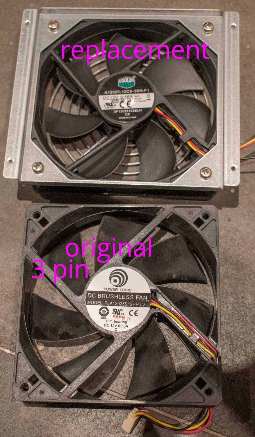

07. This is the case fan at the back of the unit. The original fan for reference is at the bottom of hte pic. I replaced it with a silent one at the top. These fans are 3 pin. The case fan has a bit of noise to it, but again, it's NOTHING like the TTX2 fans.
08. PSU and case fan back in the case. You can see what I mean about airflow, there's a vent under that black sleeve so the air flows from the PSU and stays out of the case.

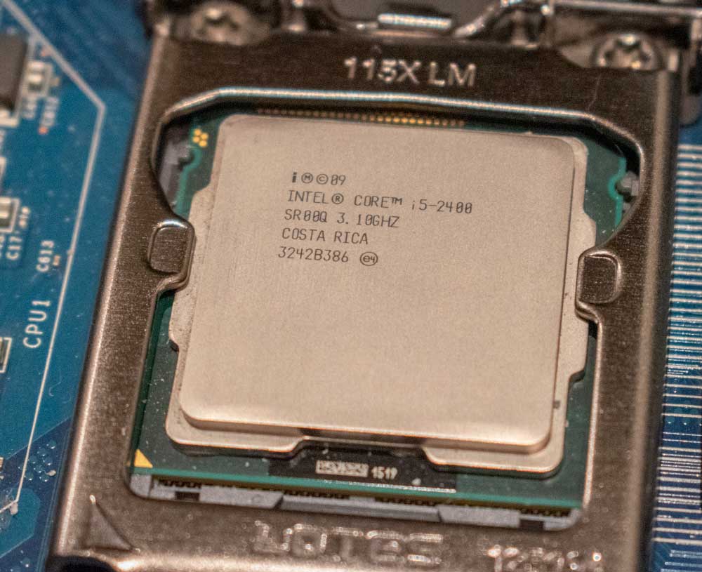

10. The CPU. I5 2400
