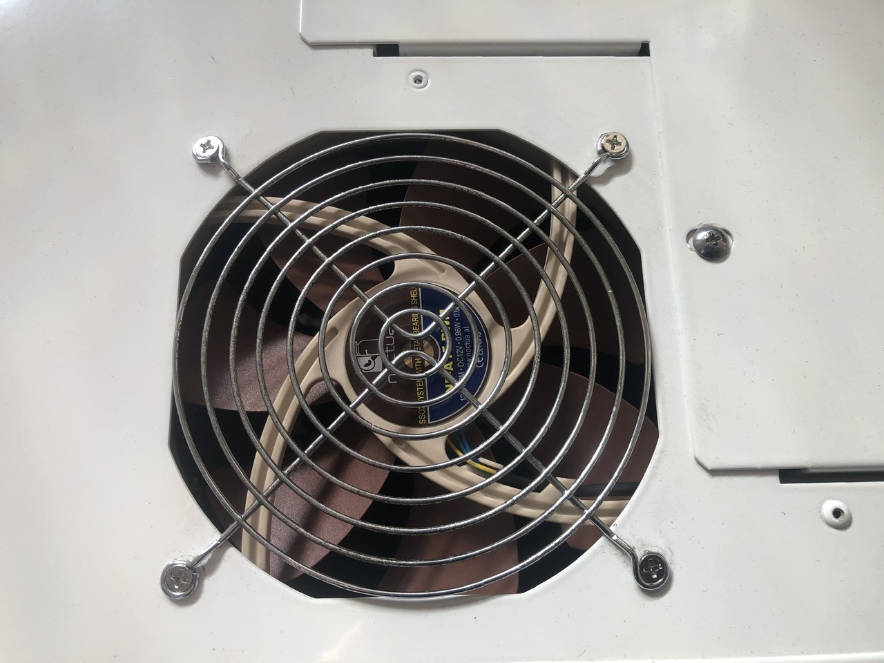

On my diamond blue I run Noctua NF-A15. 12V .96watt .08amp 1200 rpm with Noctua’s SS02 metal bearings. Bolt pattern is perfect and I just splice in the new fan connector into the existing supply. So freaking quiet. FWI...noctua is not the cheap route, it’s the $$$ route as far as fans go....is airflow really where any of us collectors should be saving money.
I just picked up the fan you recommended for my Vewlix C Cabinet but upon removing my stock fan I noticed it was a 2 wire. Do you recall which wires you spliced into the cabinets harness?

The Noctua I received are those colors, so I'll be wiring the Red to the Yellow and the Black to the Black.
Figured I'd most my findings and contribute back to the forum in case this comes up again.
Yes ground to ground, hot to hot. If you want to check the two cabinet wires - chassis ground your volt meter and check for 12v in the two cabinet wires with volt meter set to DCV, that’s your supply hot. Switch the voltmeter to continuity and the ground wire will beep when the volt meter is chassis ground.

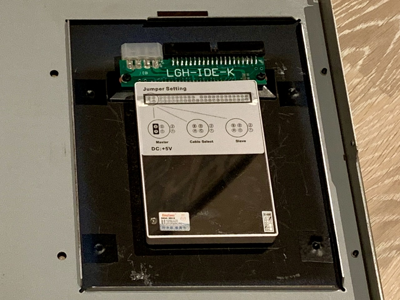

It will fit an X2 just the same. More of an issue with clearance between the HDD and CPU fan. Less of an issue with an SSD if the mounting brackets don’t interfere. I have also mounted a SSD directly to the plate with Scotch ‘Extreme’ tape - Velcro for mounting fire extinguishers to walls with...
