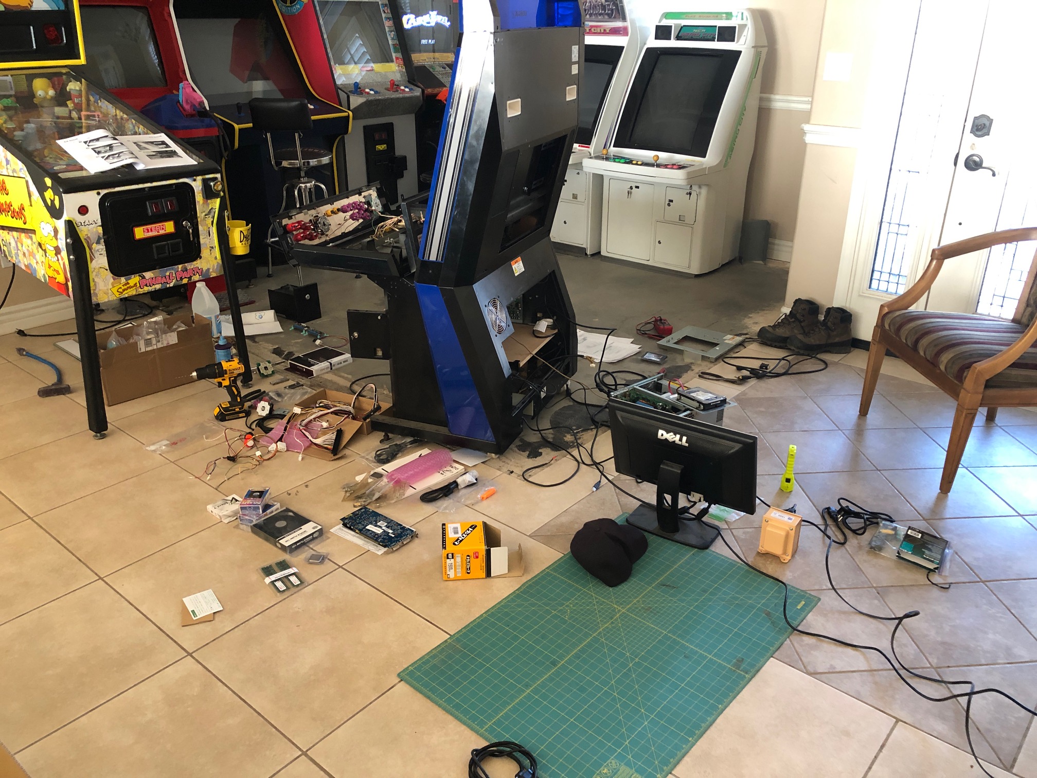

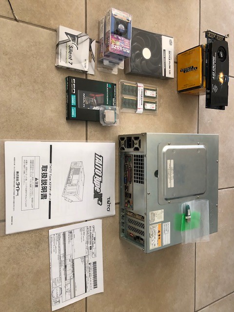

First post go easy. So I’ve had a pc in my viewlix for a year. Just received my Taito x2 with SSF2 AE from Japan, 3.4 P4, 7900GS, 512mb. I already received all the fan mods, 4GB ram, 9800GT, x6800, multi SSD. Installing components today. My viewlix is JVS and I have the official taito jamma conversion kit. I have the x2 fast I/O card and viewlix fast I/O board coming from Italy right now. This is my question, my vewlix came with a Bana Passport RFID, will this RFID work with the fast I/O’s I have coming? Or do I need to actually get the Nesica RFID? And thanks to all you guys taking the time to share all the tips and part suggestions. Let’s see how bad I can f... this up

You want to keep the 7900GS. Majority of games wont run with the 9800GT.
You dont need any RFID reader, but if you wanted to connect an RFID reader it has to be a Nesica RFID reader.
I appreciate the input Niko, I actually had a few beers and got on eBay before I read through all your guys posts and ordered that 9800gt. I will leave the 7900gs.

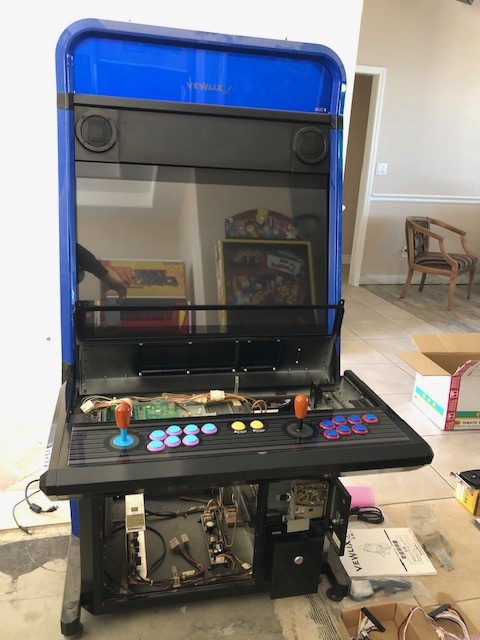

Been going solid all day. I liked the ‘less is more philosophy.’ Stuck with the 7900gs and P4 3.4. Tried booting before I did anything, took two hours to figure out I had loose ram sticks, prob from shipping, got the orig setup running on both the multi and ssfiv AE with dongle.
Pulled the cpu, Northbridge, southbridge (this f...er was cemented on) heatsinks and polished with medical grade isopropyl alcohol, reapplied arctic 5 thermal past on all. Replaced the case fan, cpu fan, soldered in and shrink wrapped both psu fans. Put the 4gb ram in. Just ran it for an hour with way less noise.
My question, does the x2 support touch screen? I have a iiyama prolite 1080p with 8ms response installed with a usb touch screen option. Works amazing with my pc. I’d love to use it with the x2, seems like I read somewhere the x3 had touchscreens?
