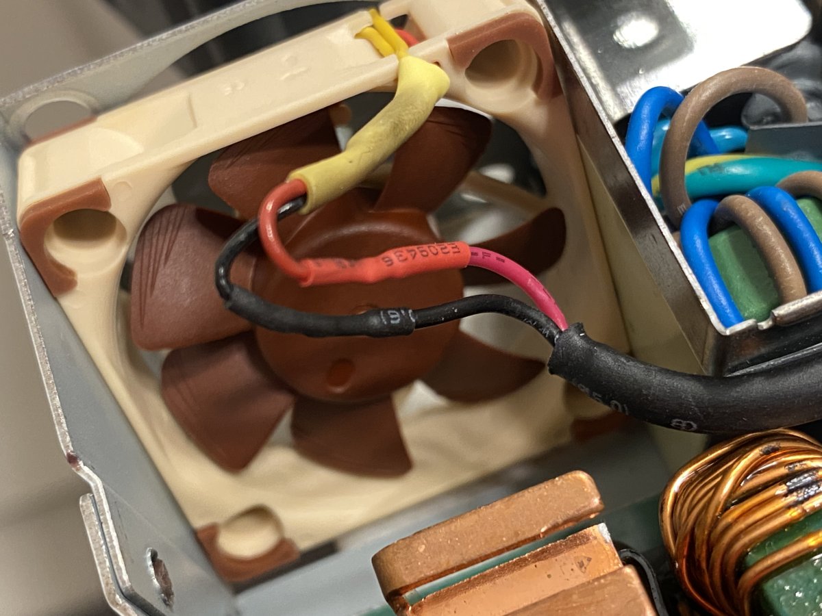

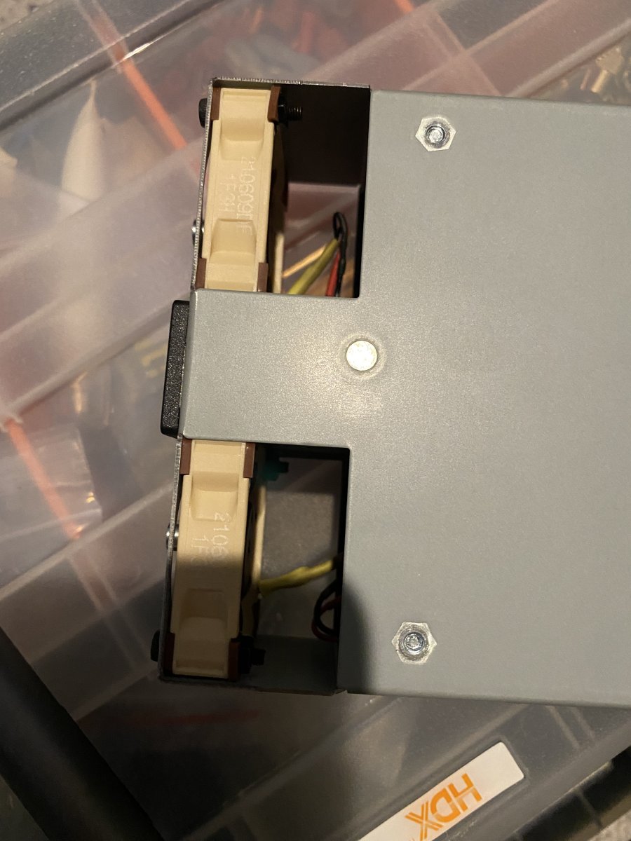

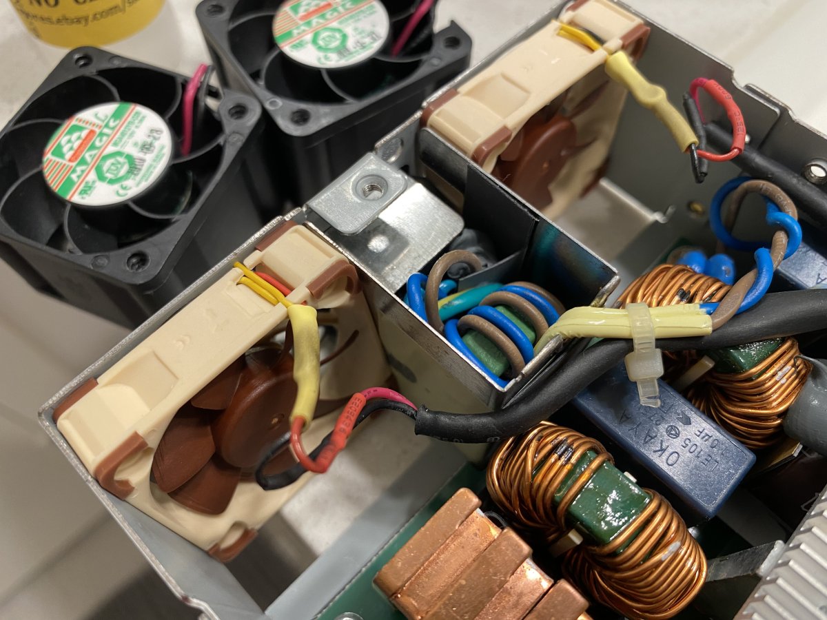

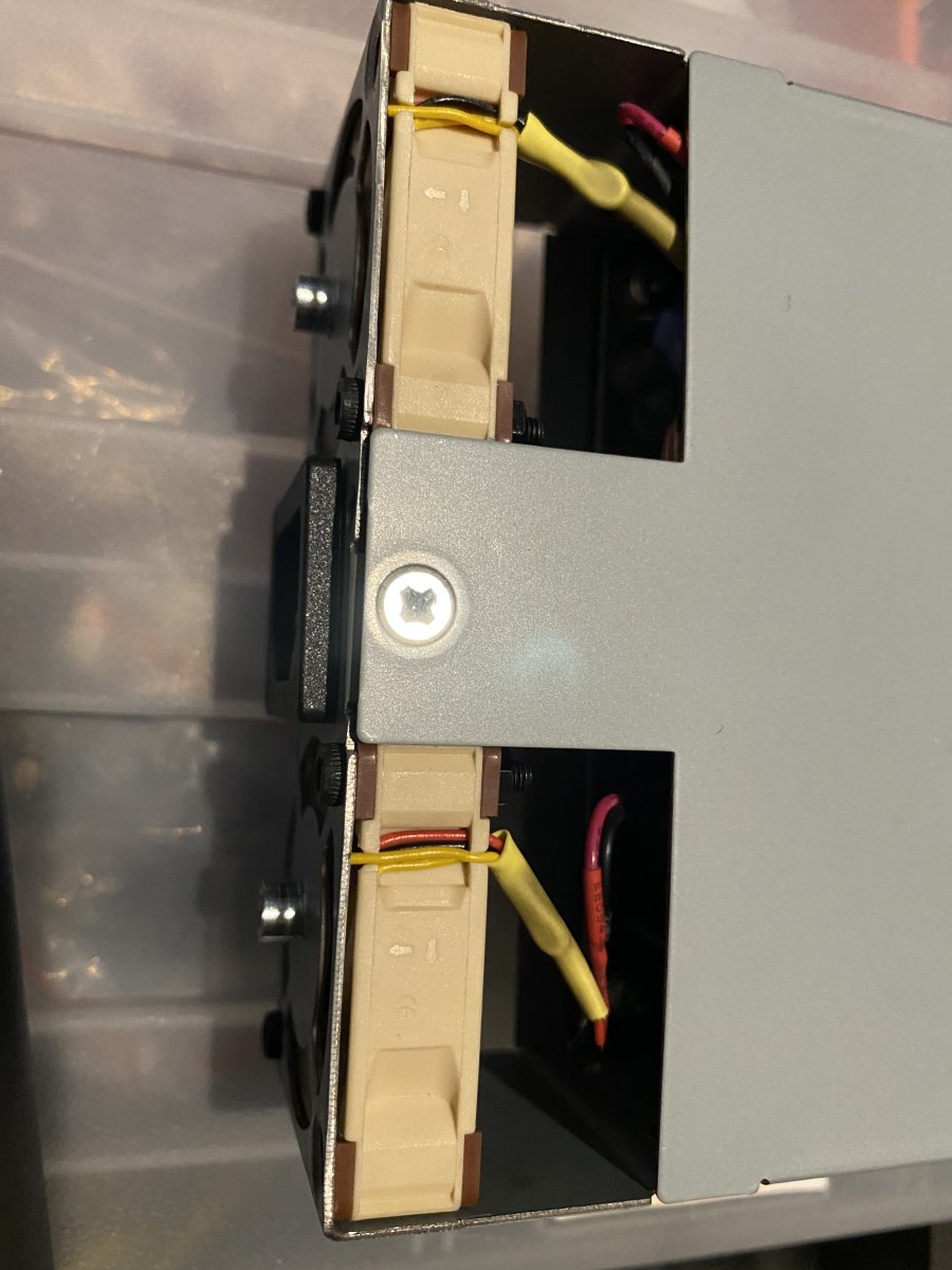

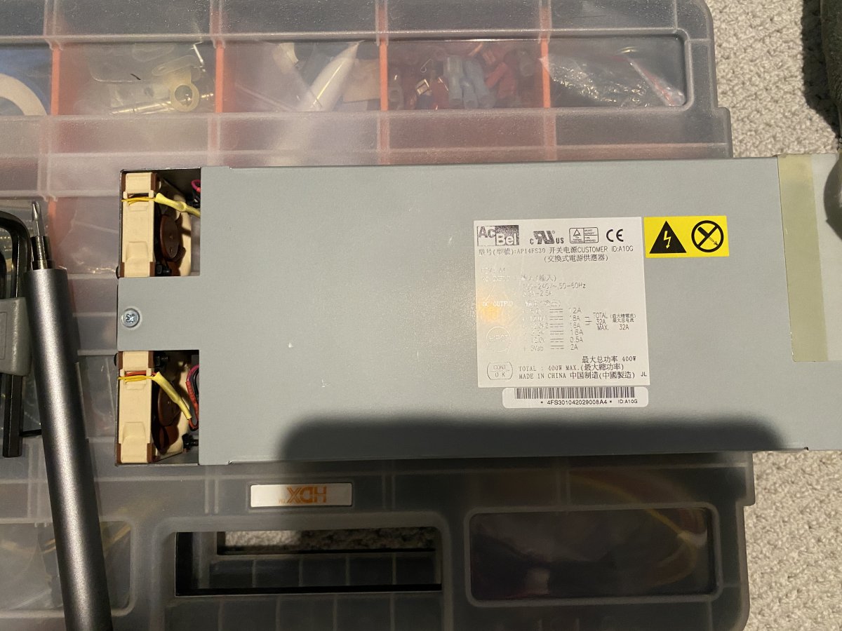

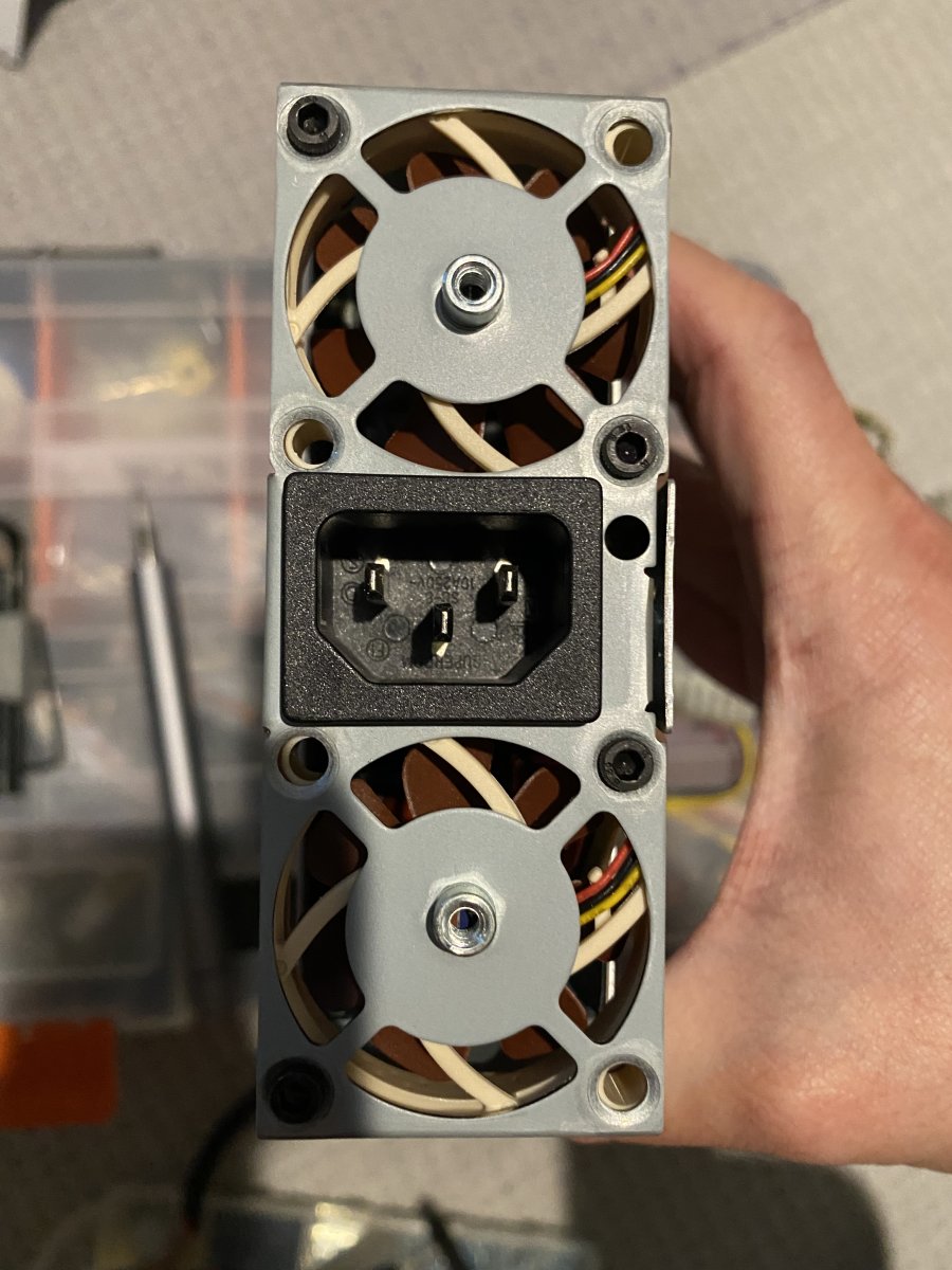

Since I didn’t see any pics of the psu fan mod, Ill add mine. I replaced those jet fans with 2 Noctua NF-A4x10 5V. Kapton taped the gap on both sides.

I have also replaced all my fans, replaced the CPU thermal paste, and upgraded my ram.
Ram: A-Tech 4GB 2x 2GB PC2-6400 Desktop DIMM DDR2 800 MHz Non-ECC Memory RAM 6400U 4G (ebay)
Thermal paste: Thermaltake TG-7 (Best Buy)
Case fan: Noctua NF-A12x25 FLX 12V (Amazon)
CPU fan: Startech FAN7X15TX3 12V (Amazon)
PSU fans: Noctua NF-A4x20 FLX 12V (Amazon)

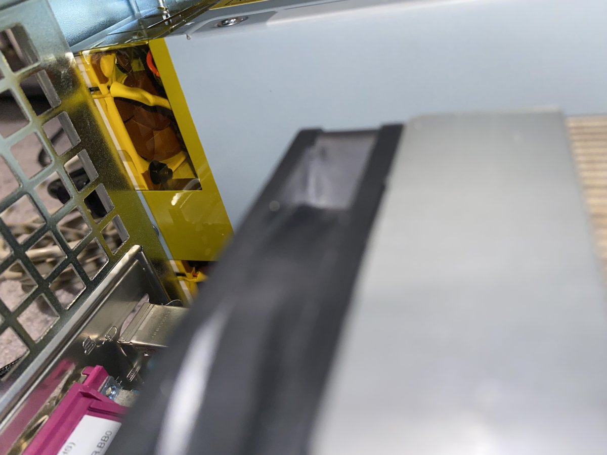

Everything is fine except I'm not 100% on the PSU fans. They're much quieter but also only move 1/3rd the CFM the original fans do. That said the PSU did not seem excessively hot to the touch after about an hour closed in a Vewlix.

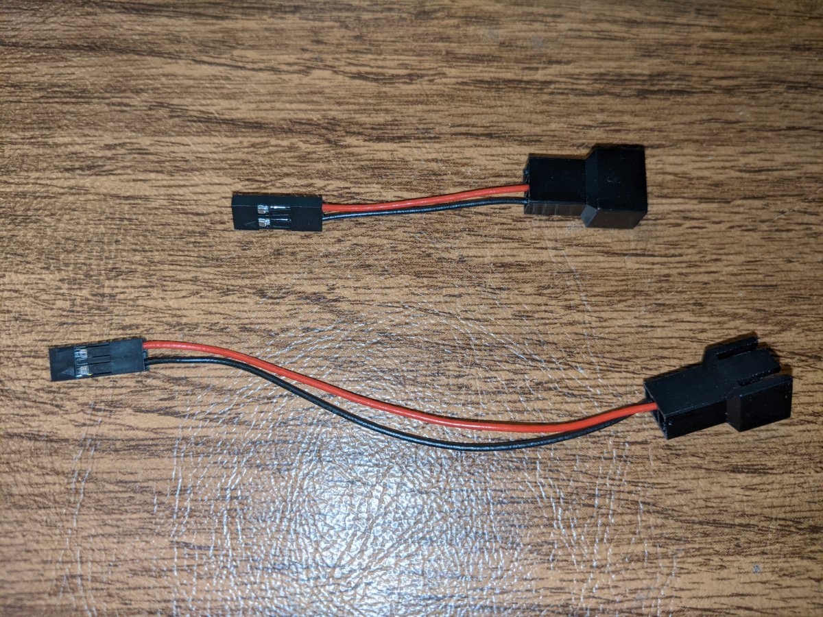

Almost everything is plug and play except the PSU fan cables need to be extended. I just used the extensions they come with and cut them to length and crimped on Dupont connectors. Also because the fans are shorter you MUST cover the gaps with tape or something. If you don't the fans are just going to pull air in from the gaps instead of through the front of the PSU.

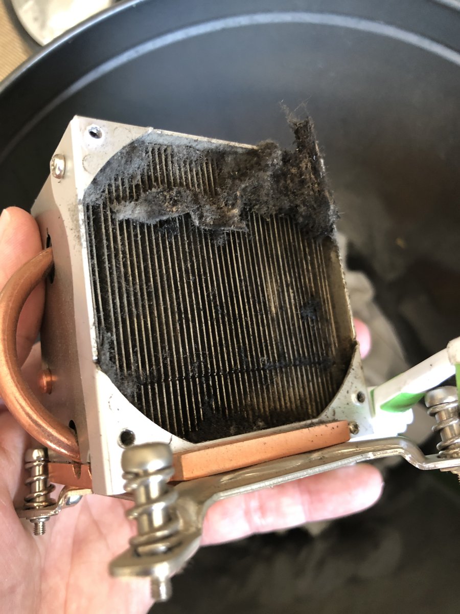

Installed new Fans this morning and gave everything a good clean. I removed the Heatsink from the GPU and also the fan and yuk that was gross. Unbelievable how long those products last considering that it’s still allowed to smoke in the Arcades…
Gave it some fresh Heatpaste and that‘s it. Runs like a charme.
